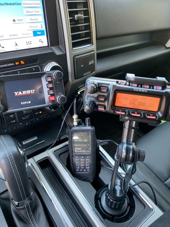

There are numerous radios out there today, small enough to be hidden somewhere in your vehicle with a remote control head you can mount up front for easy access while driving.  Your antenna selection and mounting is critical.  You must ensure the best ground plane possible.  My F150 is bonded throughout with 15 fat braided brass straps to make one solid bonded structure.  Here's what my operating position looks like, going down the road . . .  Left to right, Yaesu FTM400DXR with APRS; Uniden SDS100 scanner with GPS frequency update; Yaesu FT857D - HF/VHF/UHF.
Very clean rig set-up, OM.  Envy creeping in...
73 de W)ABX
