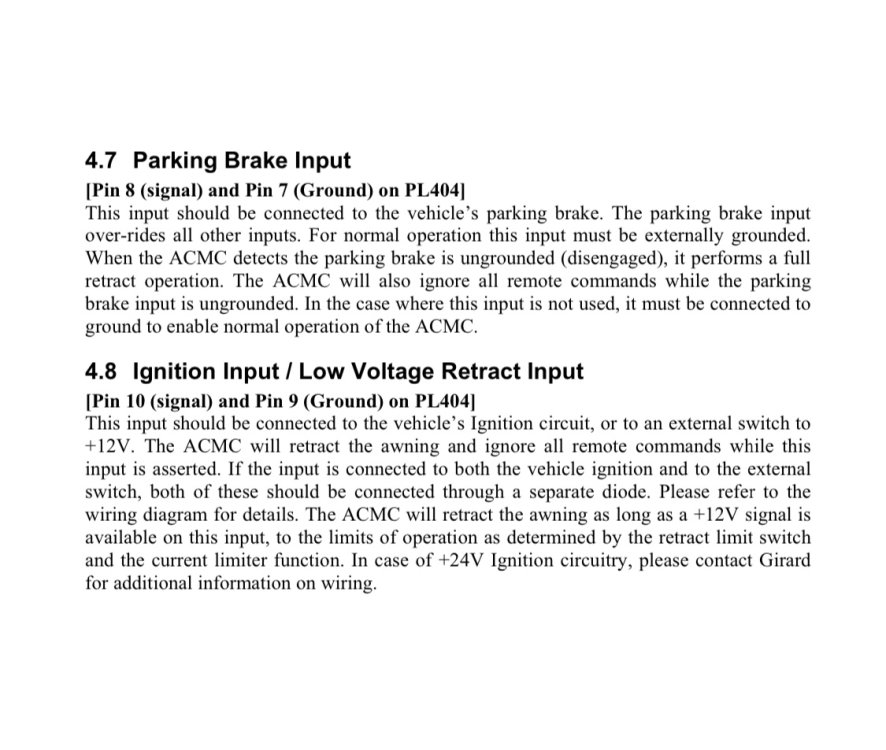

Girard does have a couple of special features on some awning motor controllers that are normally utilized when the awning is an installation on a motor home, to prevent driving off with the awning still extended.  The Girard manual details both a parking brake off retract, and an ignition on retract option.   Maybe Oliver figured out a way (accidentally or intentionally) to utilize one of those features by tying into the 7 pin harness running light connection.

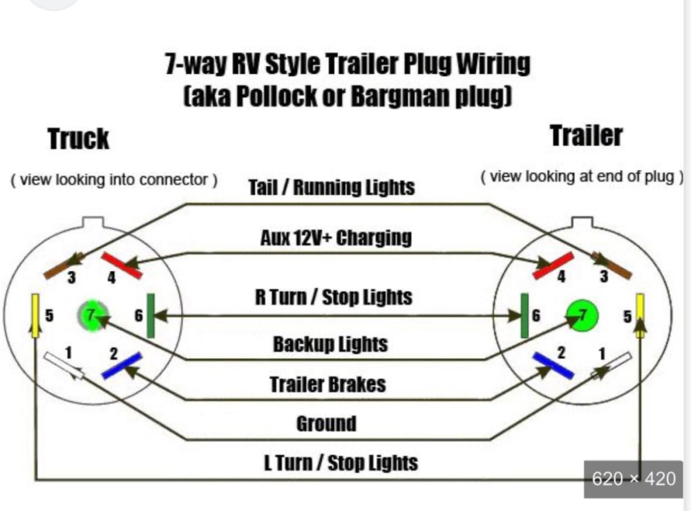

I believe that if you insert an ATC fuse into the trailer side of the 7 pin connector between socket 3 and 4, it will send power to the running lights.  So I was pondering the possibility of that also supplying power to the awning.
Not if you have a factory lithium package. They don't connect that 12v pin to the batteries. We used to carry a 7 pin socket wired that way for use in an emergency. If you had to leave your trailer on the side if the road at night because of a breakdown it would light the running lights while you were gone. (Should have incorporated a flasher unit, now that I think about it...)
Thanks for pointing that out!  I assume that’s to prevent alternator charging.
