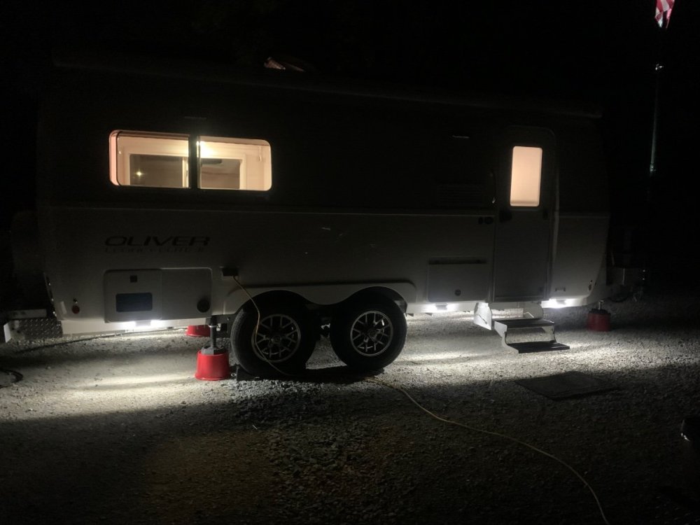

I’ve been thinking about installing some type of shade or deflector shield on each of the curb lights along the bottom of Ollie-Haus to reduce the harshness for folks camping nearby.
After considering numerous ideas, I decided to buy a piece of 1.125” aluminum “Z” extrusion and cut into 5 inch pieces to serve as stick on shields. (Edit) https://www.mcmaster.com/7062T16/    You may be able to pick this up locally and save the high shipping charge. Metal supermarket is a good source around the country.
I chose this method as it seemed to me  an inexpensive, easy, effective and non-permanent modification that should do the job. I painted the pieces glossy white to match the camper and installed with clear double sided silicone tape. Here’s some pics of the results.

Simple solution! Very good idea! Thanks for sharing. Upon closer examination of the first image it appears that the new courtesy lights are different from the “older” ones. It looks like the new ones are much brighter.

Very clean mod!  Looks effective for its desired function!  Great pix - thanks for posting.

Your solution certainly is a bunch cheaper!  And, easier to do too.
It's also easily removed and restored to original if ever desired. I do like the idea of a dimmer as well.
Nice idea. Added amber tape to the upper lights on both sides, but not done anything with the lower ones. Was thinking blue auto tape.

John, on our second night in the Ollie, at about 3 AM, the dogs alerted on something.  I turned on the the curb side porch lights to see if we had an animal in camp, but saw a “two legged” critter leaving the area.  That extra bright light welcome serves multiple purposes.

@Ollie-Haus Chris - great idea, I also like the idea that the porch lights stay bright for looking outside when boon docking.
When I first got my Ollie I thought that those little lights under the camper were simply a cute gimmick that simply shouted - hey, look at me, I'm an Oliver.
Fortunately, I changed my mind on this subject when later that very first summer I was preparing for bed in a nice boondocking spot and thought that I'd take a quick trip outside to .....  Anyway, I flipped the switch to turn those little lights on and made that first step out the door when I noticed a fairly large timber rattler curled up at the bottom of the second step!  I sure did appreciate the indoor plumbing that night!
