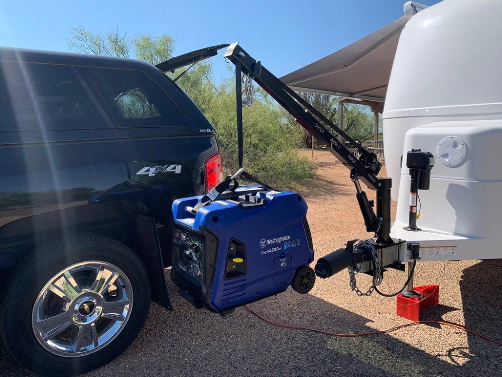

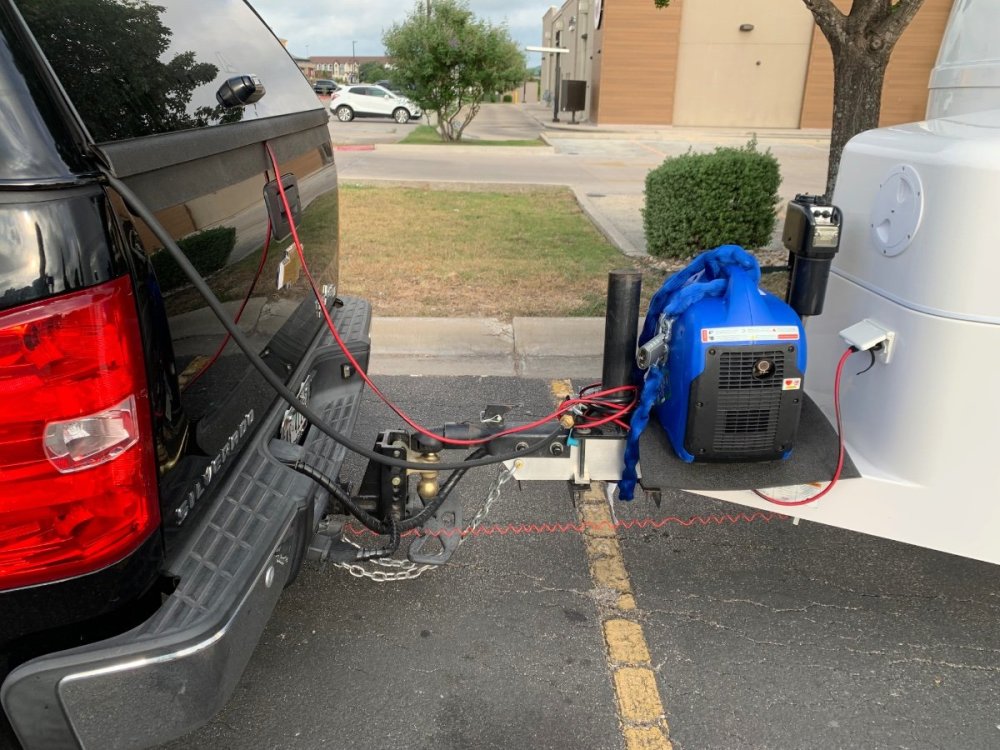

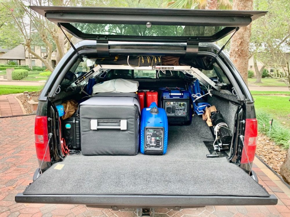

As ScubaRx eluded, permanent mounting options are very limited, many owners just make use of the cargo basket with or without modification. That said, the “best way to attach” may in fact be the ‘only way to attach’, that being via the cargo basket or perhaps a mounting plate if no basket. Since I did not opt for said basket or want to trailer-mount, I adopted a couple of alternatives routinely used depending on my power needs; I carry two generators under cap, a 4500W for total and a 2200W for specific power service. I can either suspend or lower for ground positioning the larger, tailgate or tongue position the smaller (note the lock and chain for securement).

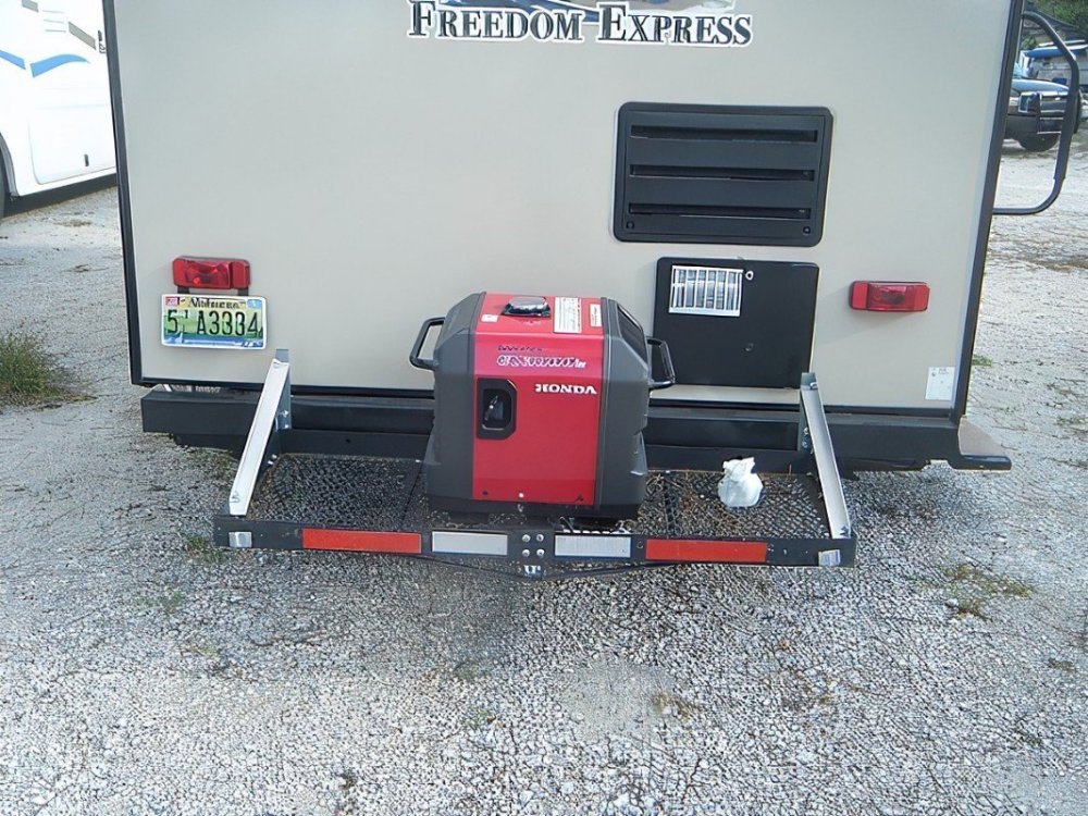

I've seen a few variations of rear bumper mounting for generators on other trailers.   But if you made a permanent bolt-on mount on the Oliver rear bumper, that puts the generator right by the beds/back windows, bad for noise and VERY bad for exhaust fumes.
Bad for weight distribution, too. Many Olivers are already at or even slightly below the 10-15% tongue weight recommended for stability.
Did I mention that this rear mounting thing is a bad idea?

Basically, an Oliver Owner has three choices on where to put his/her portable generator.
1 - Put it in the basket on the tongue of the trailer.

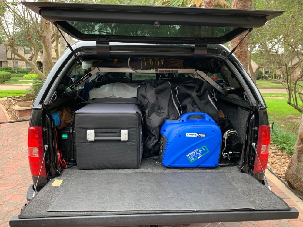

2 - Put it in the rear of your truck and deal with having to futz around with it when you want to use it.
There is some truth to this, but then the bikes, griddle, fire pit, chairs, tables, etc. also add to the overall “futz” when RVing! I guess ‘organization’ is the key to managing said cargo and then there are a few ‘work arounds’ that come into play, as well. Although my Westinghouse 4500DF lives at the truck-bed bulkhead, it is readily accessible once our folding ebikes are unloaded at camp, if needed. I don’t use it that much, but find comfort in having it in the event of an extended roadside breakdown or other emergency situations such as hurricane evacuations. However, I soon learned a smaller genny would suffice for most of our generator needs (think air conditioning) and thus, a DuroMax 2200 was obtained. I carry a 5-gal jerrycan of non-ethanol gas as backup fuel for the generators, but primarily operate each on propane. That said, I also carry a spare 30# propane tack next to the WH and run a hose from it to the tailgate for convenient use of the DM, as necessary when traveling. The spare tank is also a match to the OTT’s propane tanks.
