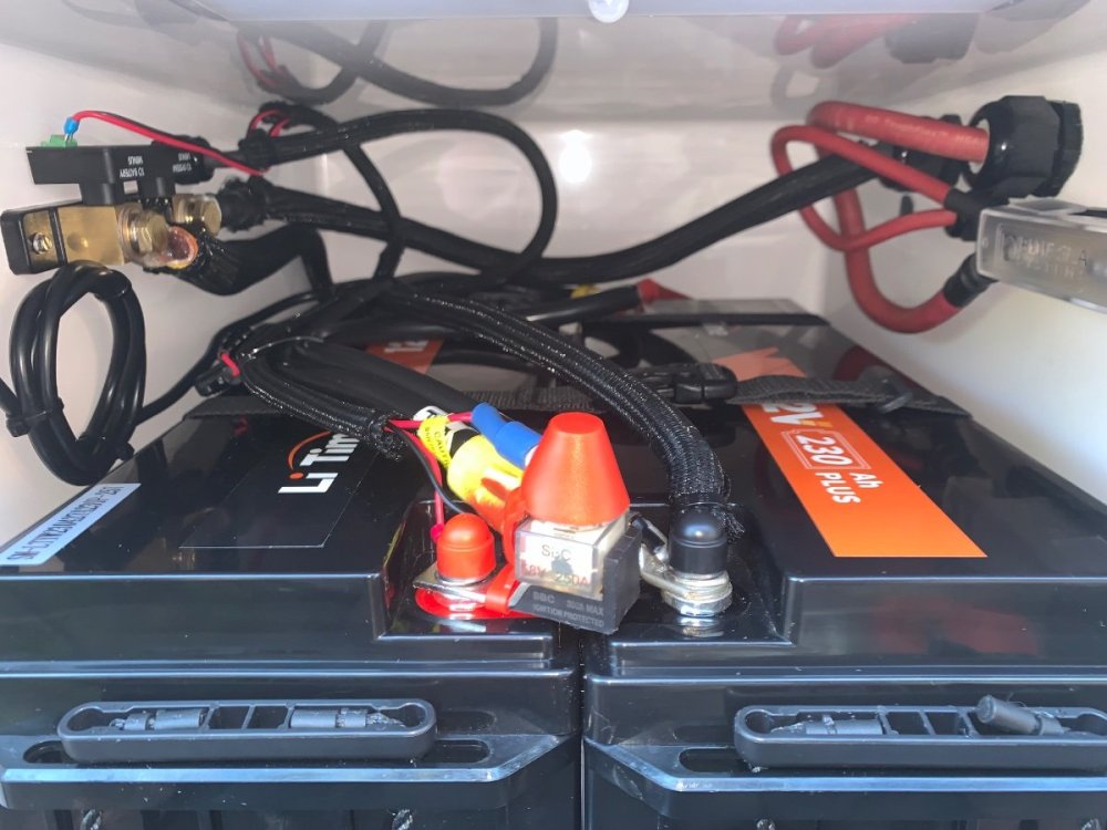

I'm thinking I can add the SmartShunt directly at the battery ground like @CnC did for his 712 install, and just leave the Blue Sky shunt as-is (see pic above). What a simple install, since I'm not adding the 712 display, everything is wired within the battery bay with Bluetooth to read battery information.
Although, the SmartShunt has a gray lead that can read the TV battery voltage, be attached to a battery temp gauge, and other uses. I could wire this to the black lead, at the +12VDC bus (also shown in pic above), which connects thru the trailer electrical connecter to the TV battery. This should show about 12.6V when sitting and 14V+ with engine running when operating correctly. Just purchased this: Amazon.com: Victron Energy SmartShunt IP65 500 amp Battery Monitor (Bluetooth) : Automotive
I didn’t bother with the 712 monitor either, the SmartShunt with BT and the VictronConnect app will suffice; battery bay install, as well, and a Blue Sea ANL block with a 250A fuse on the positive lead.

I installed the Victron SmartShunt: Amazon.com: Victron Energy SmartShunt IP65 500 amp Battery Monitor (Bluetooth) : Automotive
I went with the IP65 model and @Ronbrink installed the other version (see his pic above), same $130 price on Amazon for either. Not that waterproof is a true requirement, but not a bad feature for the battery bay, and I like that it came with the wiring at the same price. Love having this, not having to look down at knee height for our Blue Sky display (as it was installed in our older hull).

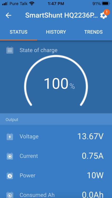

Those of you with the Victron SmartShunt, what kind of Bluetooth range are you getting? Mine is terrible!
I recently installed two Bluetooth devices, this shunt and the LevelMatePRO. The shunt is installed on top of the outer battery. The LevelMatePRO is mounted to the PD5100 ATS under the rear dinette seat, so they are about 3 feet from each other. I have to be within 20' of the Oliver for the VictronConnect App to find the SmartShunt. Unsatisfied to know I cannot connect from our living room just 60' away, to monitor over the winter w/o going outside.
The Bluetooth on the LevelMatePRO is SOOOO much stronger. From the living room, yes and it can even connect from inside of my garage over 120 feet away. In either case, our RV parking is behind a 10x20' Tuff Shed blocking line-of-sight.
Does the Victron SmartShunt merely have a weak transmitter? Read some Victron forum comments and there is a trend re weak Bluetooth. Maybe the IP65 version weaker? Anybody with the Victron BMV-712 Smart Battery Monitor, is it stronger? Looks like the same shunt, but I do not see negative Victron Forum comments re the BMV-712. Let us know your feedback. Thanks
With my Oliver at the side drive, I can always get an app reading in the adjacent living room within a 15’ range (thru a single wall, expansive entertainment center cabinet, exterior brick veneer), and sometimes up to 25’, but not often. That said, I generally cannot sit behind the TV steering wheel and expect to monitor via the app, go figure! However, I can make use of the LevelMatePRO while driving in search of a level spot and backing onto the Anderson leveling ramps, no problem!
We're using the BMV-712 located under aft dinette seat - the iPhone must be within 5-10' of the outside hull to connect...  It would be SOOOooo nice to be able to access the 712 with the app while towing.
So then, the BM-712 signal is not any stronger than the SmartShunt Bluetooth signal. I haven't tried mine while towing yet. I was connected yesterday to drain the tanks and too bad I did not think of it. Soon, I'll back my truck up the Oliver to see. I wanted signal strength to my living room! You would think at a minimum to the driver's seat!
On other forums I read the Smart Dongle has a stronger Bluetooth signal: Amazon.com: Victron Energy VE.Direct Smart Dongle (Bluetooth) : Electronics There were many forum members complaining about buying the SmartShunt and having to spend more $ on this. Also, you may need one of these to connect: Amazon.com: Victron Energy VE.Direct Cable, 5.90 ft : Automotive which comes in various lengths. We could get the Bluetooth signal out of the battery bay, higher up and run it closer to the TV.
I don't have the time to worry about it now, but perhaps another $60 would allow the app to read the signal from your driver's seat. I'm not betting on a 60' broadcast to my living room, but perhaps it could if I mounted the dongle rear left of the Oliver where I have line-of-sight. Closer to my living room, would be farther from the TV driver's seat!
I think the bt connection was designed for boaters,,as that's historically victron market. For many years. What do we boaters want? To see what's going on, without leaving the cockpit or fly deck.
Bluetooth isn't a super strong connection,  in most cases. But, if you enable wifi in some fashion, on your Ollie,  you can get all the reports you want. One of my friends in the marine industry monitors boats all over the coastal USA.
In my case, I can monitor the victron on the porch (35 feet or so, direct line.) Once I go in the house, nada. Zip. Too much metal.
Walking down a marina, you'll see lots of boats pop up.
Make SURE you change the original password to your own. On any given day,in a marina,  I could play with dozens of systems.  I never would, but I could, ostensibly.
