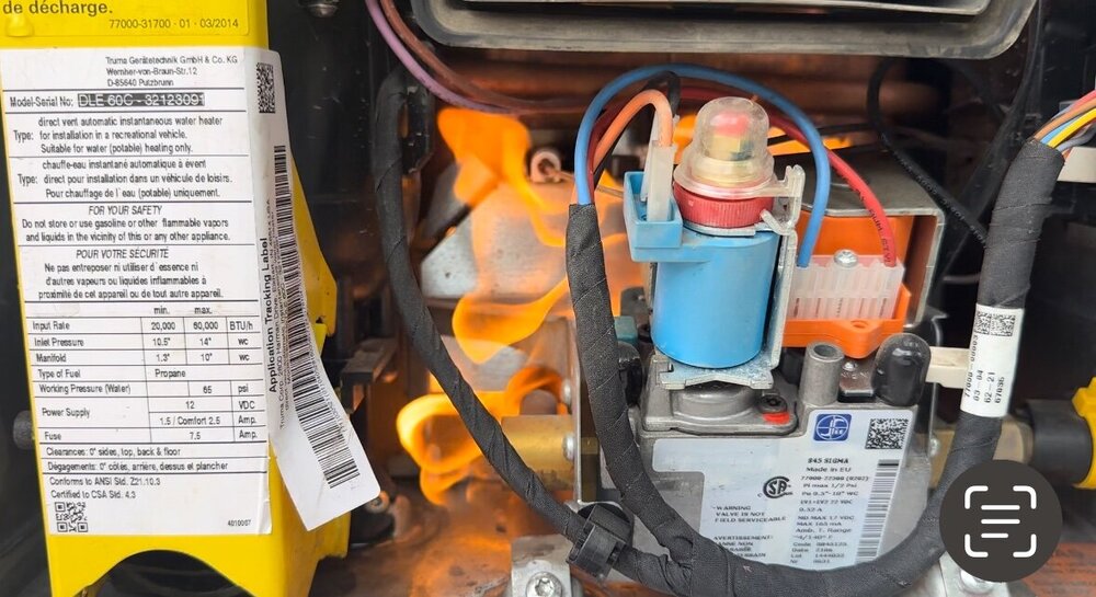

Problem:
Looking at the Truma from the outside with the cover open, the gas comes in from the right, goes into the burner assembly then makes a 90-degree turn upward and then attaches to the assembly with a large (about 3/4 inch) collar nut to hold the compression fitting in place. The collar nut had come loose and was freely spinning. You can't see it from this prospective, to access it there are two star head screws on the bottom, once removed the entire burner assembly is able to be slid out enough to get a wrench on the collar nut. Tighten it down, return the burner assembly to its home position and Viola! The tech hypothesized that the collar nut was never tightened appropriately at the Truma factory. Since there was no evidence of burned wires or other burn damage (see videos in the first post) we thought is was fine to continue using the unit. If there had been any concerns of damage then we would have had to replace the unit, Truma had already agreed to replace the unit since it was still under their 2-year warrenty.
Fortunately the Gas fire ball only occured 2-3 times and the odd sound it was making prompted  me to take a look at the unit. After seeing the "fire in the hole I opted to allow it to occur one more time (this time with a fire extinguisher in hand) so I could get a video of the symptom to send to Truma, Oliver and share with all my friends.  I suppose the Take-Home message should be: if it's not looking or sounding like it has in the past, something has probably changed, go take a look at it, whatever it is....

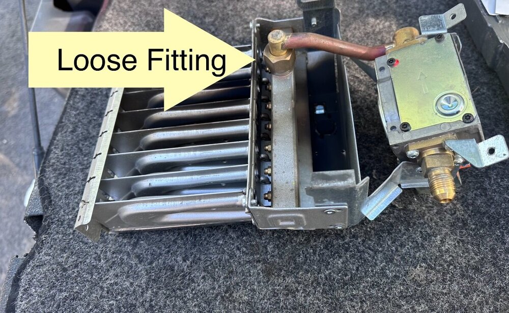

If you're so DIY inclined, I recommend removing the 2 star-head screws holding the bottom of the burner assembly in place, slide the burner assembly out enough to get a wrench on the collar nut (where the gas line turns upward 90-degrees and attaches to the burner assembly with a compression fitting) and make sure it is good and snug. I've reached out to Truma again and asked for their recommended torque for this nut, I'll update when they reply.

Thanks to @AlbertNTerri I was able to field repair the truma unit.  Their note described the specific burner feed line that was loose.
I removed the burner assembly and found the main connection inside the burner was loose.  The connection is the brass fitting in the pix.
That connection was loose, not  even hand tight. I tightened it back to spec and checked all wiring for any burns and they were all ok.
Tested gas pressure and it was correct.
Cleaned soot from burner Assembly and reinstalled burner.
Checked for gas leaks then lit off the Truma.  No more whoosh/boom.

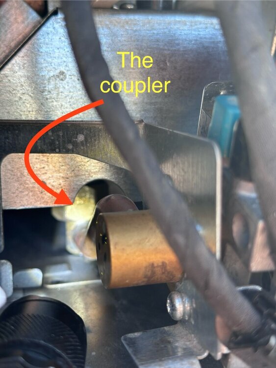

Is it at all possible to feel the faulty nut with fingers, or to see it with a small mirror, without uninstalling parts?
Can we create a pinned list of known faulty SN units here on the forum?
Edited by Boudicca908
my Oliver has camped here
You could maybe reach in with some long needle nose pliers or a screw driver to see if it's loose.
The picture below is looking into the burner assembly for the coupler you seek.

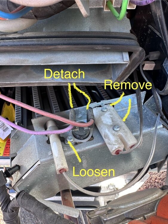

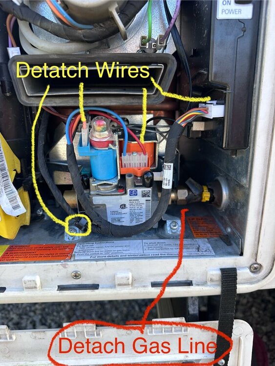

CAVEAT - What I'm describing below is not an official repair guide.  It's a description of what will be done by a qualified repair technician.
It takes about 30 minutes to remove the burner assembly, tighten the coupler and re-assemble.
If a qualified service technician needed  to remove the burner they would first take pictures of all the wires before disconnecting anything. Then the technician will:
`) Turn off gas to the trailer at the tanks.
2) Burn off what's in the gas  lines by lighting stove until burners go out.
3) Make sure the Truma is OFF, and pull the 12V device Fuse.
4) Disconnect the gas line from the Truma.  Use a backing wrench on the gas coupler.
5) Take Off 2 Torx screws that hold the burner box down in (they are below the control valves.)
6) Disconnect wiring harness, and other spade lug wires.  The bundled black wire harness has an automotive style plastic tie down that can be pulled out with pliers. (Bottom left yellow circle)
7) Once the wires are loose the technician would gently wiggle the burner out part way to expose the igniter and sensors.  (Note- the gas line has a bit of flex/tension pressing inward and needs to be held out of the way a bit to the right side while removing and re-installing the burner.  An extra hand is useful to hold that gas feed to the right side.-
With the burner part way out (shown below ) next loosen  the hold down bracket Torx screw (don't remove fully) for the single (White) sensor and then remove the 2 Torx screws that hold the dual wire (White) igniter.   The technician will need to remove the purple and brown/red spade lug wires from the sensor.   Once the igniter, sensors and wires are detached the burner assembly can be removed to a workbench.
8. Wiggle the burner the rest of the way out and check / tighten the burner feed coupling that is shown below:  Note- the gas line has a bit of flex/tension pressing inward and needs to be held out of the way a bit to the right side while removing and re-installing the burner.  An extra hand is useful to hold that gas feed to the right side.
9) Reassemble reversing the  process making sure to be gentle while replacing the burner.  The copper chimney/heat exchanger is delicate so be slow and steady when replacing the burner assembly.
After the technician gets everything back together...they will to check for any gas leaks at the main connection (soapy water, and gas sniffer). Turn on the gas and run the stove for a bit to make sure gas is back in the lines.  Finally they will put the fuse back in and test the Truma for function.
