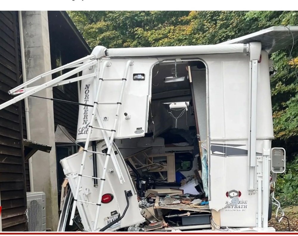

There have been several posts concerning furnaces not working (no flame) and full tanks. Nothing wrong with furnace including sail switch.
It turns out the gas stop or emergency cut off were the culprits. They restricted the flow of propane. This provided insufficient flow to allow the furnace to start and operate properly.
This information came from posts on Oliver Owners Facebook site.
