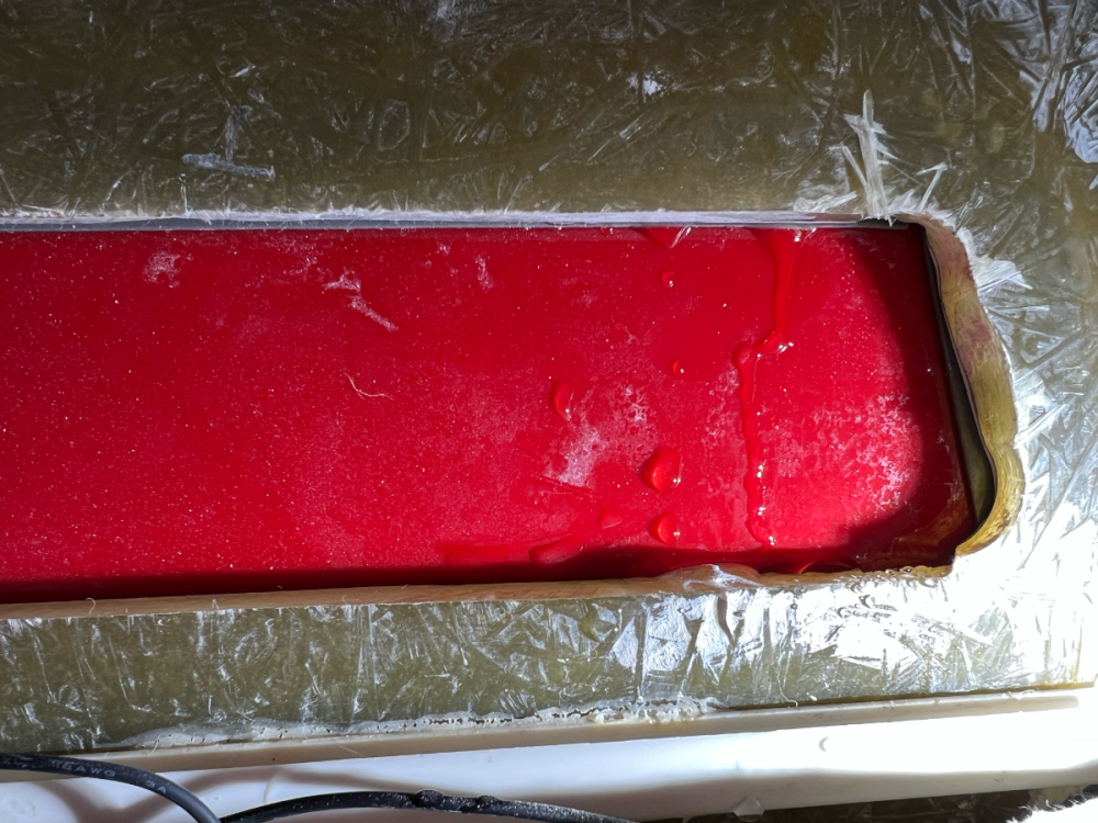

Allen Lee Rohner Posted February 4, 2024 Posted February 4, 2024 (edited) Here is a picture of my Oliver signage leak. Edited February 4, 2024 by Allen Lee Rohner Insert proper image format 2 2 2021 Oliver Elite II, Hull # 867, Shiloh, IL 2022 GMC Sierra 1500 AT4, 3.0L Diesel, CarbonPro
MAX Burner Posted February 5, 2024 Posted February 5, 2024 20 hours ago, Allen Lee Rohner said: Here is a picture of my Oliver signage leak. Don't discount the fact that one or more of the rear LED could be the culprit - and the water is passing along between the hulls to the Oliver sign cut away area. Just think'n... In either case, could be a good time to pop out the LEDs and the Oliver sign and re-seal the whole kit-'n-kabootle. Cheers! 1 2 Art, Diane, Magnus & Oscar (double-Aaarrf!) (SOLD) 2022 TUNDRA (SOLD) 2017 LE II; Hull #226 "Casablanca" HAM call-sign: W0ABX
