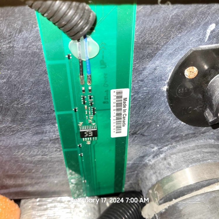

Alberta and Randy Posted February 17 Share Posted February 17 Hello from Hull 67, circa 2015! We are troubleshooting our black tank monitor that will only read as high as 35%. Starting with the tank empty, the monitor will display 0, all the way up to 35, and then stops no matter how full the tank gets (visually confirmed through the toilet). We've owned the trailer for about 2 years now and we are not in the habit of pooping in it, although we have a handful of times max. The monitor started acting up last fall. We have done multiple black tank flushes, in case there was some blockage on the walls of the tank. Any ideas to try resolving? Is it easy and simple to replace if the strip on the side of the tank has gone bad? I can't tell if there is one strip or two (maybe only the top one is bad...). Thanks for the guidance! Alberta & Randy 2015 LE II / 2016 Chevy 2500 WT Link to comment Share on other sites More sharing options...

Dave and Kimberly Posted February 17 Share Posted February 17 The explanation I've gotten is that any "crud" (lets call it) ... on the inside walls of the black tank can inhibit the sensor (your picture shows it) ability to read the content level inside the tank. We use ours toilet freely as needed. Occasionally while we have full hook-ups... I'll use a dedicated black tank hose and give the black tank a good flushing. This helps break off any crud and flush it away before it becomes a permanent part of our black tank. In addition, occasionally when I know we are going to be towing for several hours, I will first drain the tank... and then partially refill the black tank with fresh water and some Dawn dish washing detergent. As we are driving along this solution sloshs back and forth and cleans the inside of the black tank. If the tank hasn't been properly maintained it is possible that it could take a while to really get it clean again. All this said those sensors are not the most accurate things in the world... but they should be much closer than yours appears to be. Ours (for example) will read about 85% when it's really full. 1 4 2022 Elite II, Hull #1097 Elli Rose 🌹 and she has the solar panels with the 390Ah lithium batteries. Our tow vehicle is a 2019 Ford Lariat F-150 4wd, 3.5L Eco-boost, 3.55 rear end, with the Max tow package. Elli Rose also has the street side awning and several walnut and cherry mods on the inside. Link to comment Share on other sites More sharing options...

Alberta and Randy Posted February 18 Author Share Posted February 18 Thanks everyone for your comments or suggestions! Tom and Doreen - thanks for the link, that was an informative read. I need to measure, visually verify, our tank to see if it is less than 14" tall, indicating there is only one sensor strip to go out. In my troubleshooting imagination, I could see two stacked strips and the top one went bad. 🙂 Jason Foster - we use the black tank flush port (multiple times), that sprays water into the tank. Geronimo John - I have not tried dusting the sensor, thanks for that suggestion. I'll get a can of compressed air to blow on the sensor, from a distance. Mike and Carol - we have put Dawn dish liquid in the tank before using the black tank flush port, to help break down whatever. We have not tried to soften the water so I can try that with borax....or driving around with a full-ish tank and dish soap & borax. We have regularly used Happy Camper for maintenance during our ownership. Two years of ownership and the readings started acting up in the last few months so I suspect this is nothing to do with the previous owners. SeaDawg - we regularly use our toilet, just not for poop. We will try using Mike & Carol's method, with more attention to detail on where our previous methods have differed from theirs and see (hopefully, fingers crossed) if we get different results. I would much prefer to clean then replace a part, if possible. Thanks again everyone for the input! We will keep plugging away on this issue until we get it resolved one way or another. 🙂 Alberta 7 Alberta & Randy 2015 LE II / 2016 Chevy 2500 WT Link to comment Share on other sites More sharing options...

Alberta and Randy Posted February 21 Author Share Posted February 21 On 2/18/2024 at 9:12 PM, Geronimo John said: First check the connections. If they are firm, then dusting likely will not make any difference other than it will be cleaner. Yep, if we press slightly on the black lead wire at the connection/solder point it causes the tank reading at the monitor to jump numbers. So this may be the culprit! We are going to monitor on our upcoming trip and may end up trying to put a daub of solder back on to "tighten" that connection, if possible. 6 1 Alberta & Randy 2015 LE II / 2016 Chevy 2500 WT Link to comment Share on other sites More sharing options...
