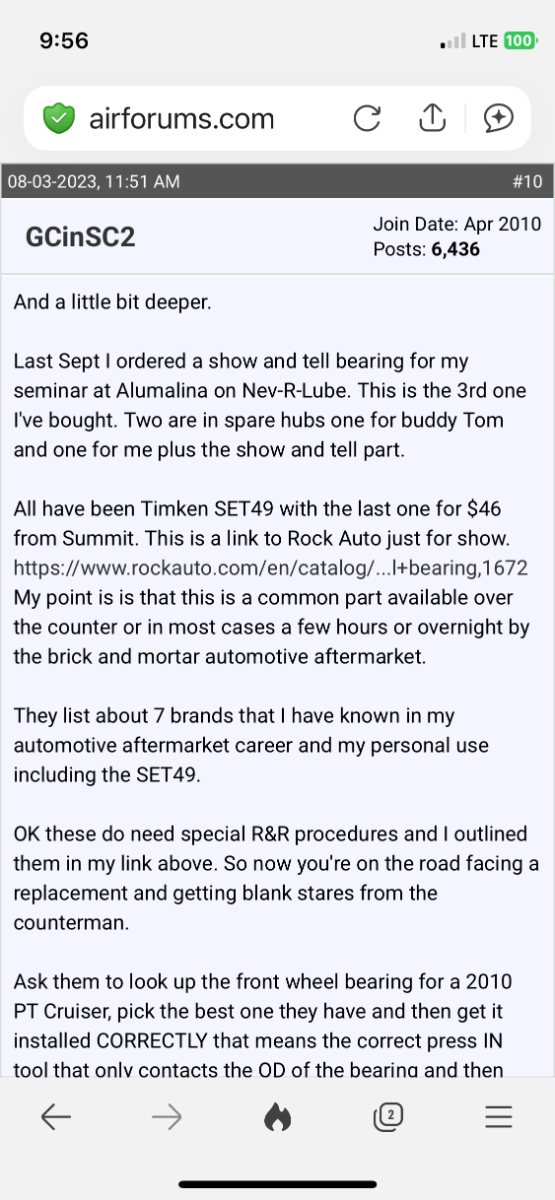

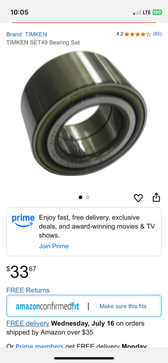

jd1923 Posted July 27, 2025 Posted July 27, 2025 (edited) 38 minutes ago, mountainoliver said: Okay, risking banishment from the planet and the inevitable public humiliation, my one and only update on my recent axle and spring upgrade... I also found out (not totally confirmed yet) that the Timken bearing used is a standard Set 49 bearing sold at every auto parts store for a fraction of what Dexter charges. I plan to call Alcan this week to check status on our special order Dexter axles (the 50.00" length that only a few older hulls have). I'll be installing them myself and based on one failure I read about here, I plan to open all 4 wheel assemblies to make sure they were assembled correctly! I will look for markings/part #s on the Nev-R Lube bearings to see if they are marked Timken and hopefully find a part number. I will determine what kind of job it would be to change a bearing. They key to the correct bearing press/puller is to have the correct diameter spacers to match the bearing diameter. We should all have a couple of new bearings on hand! I also will compare increase in brake shoe surface area, going from 10" to 12" brakes. It will be well into August by the time I get this work started, let alone finished. I will write up a NEW and complete installation post with these particulars when I get finished. Now that this thread is about to be 28 pages! EDIT - Wow, my post just made this thread 28 pages! Thanks Ken, for being partner to our humiliation! (Lance too) 🤣 Edited July 27, 2025 by jd1923 3 Chris & John in Prescott, AZ | 2016 EII #113 | '01 Ram 2500 Cummins!
CRM Posted July 27, 2025 Posted July 27, 2025 2 hours ago, mountainoliver said: I have done a little research on the Nev R Lube Dexter axles with very limited cell service so more research to come. The bearings used for the 5200 pound axles are also used for the 6000 pound axles. So there is a little bit of extra capacity there. I also found out (not totally confirmed yet) that the bearings are also used for front and/or rear axles in several smaller cars. I also found out (not totally confirmed yet) that the Timken bearing used is a standard Set 49 bearing sold at every auto parts store for a fraction of what Dexter charges. The bearings are fairly easy to replace using a standard automotive wheel bearing press kit. So can be done on the road if needed. The bearing press is available at Harbor Freight and Amazon and I’m sure dozens of other places as well. Of course all the above information is to be confirmed once we get home in August sometime. Others are more than welcome to join in the research. Yes, I posted a while back that a friend replaced his Dexter Nev R Lube bearings in his work trailer with Timken's that he bought from Summit. If I remember right they were used in several older Chrysler vehicles and he paid a little more than this, so I'd be wary at that price, especially from Amazon where counterfeit bearings are common . Personally, I would still carry a spare hub with a new bearing installed, because unless you plan on carrying a large enough bearing press with you you're not going to be able to change them yourself on the road. 3 sets of new bearings and one new hub would be the way I'd travel with these axles. 2 2010 Elite II Hull #45, the first LE2 sold. 2020 Toyota Tundra TRD Off Road 4WD 5.7 with 38 gallon tank, 4.30 axle and tow package.

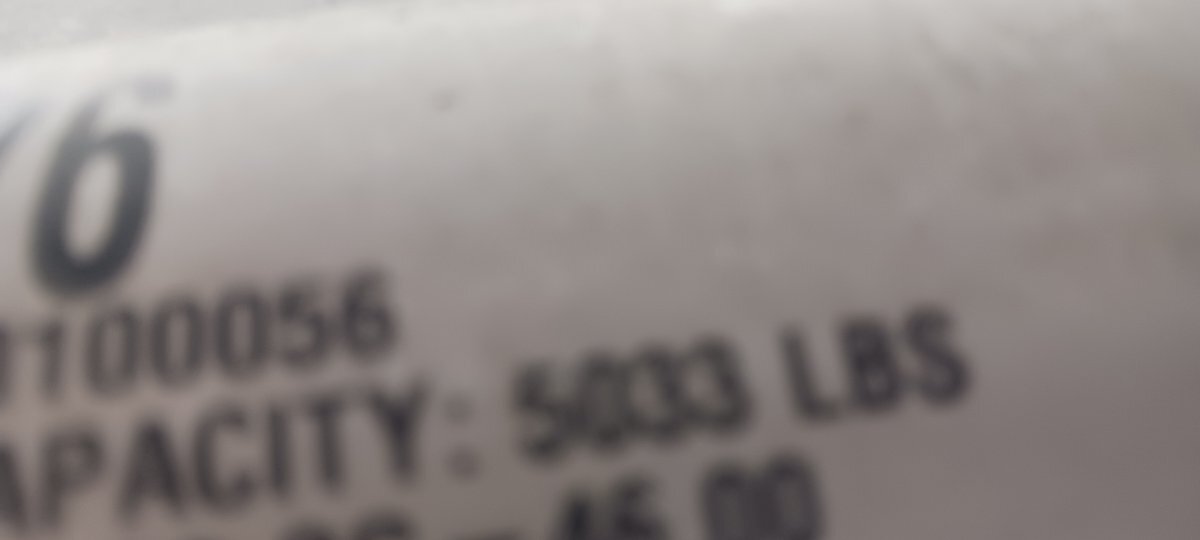

srthomsen Posted July 27, 2025 Posted July 27, 2025 (edited) On 4/15/2024 at 2:17 PM, Golfnut said: fYI, justed looked at my axle , i have 6 leaf spring on my 5033 lb. Axle. LEI. July 2022.. just thought i would it out there for LEI owners.. ( very few of us,😁).. All my welds look good also. A 2023 LE1 owns us also. Number 1403 and it too has a 5033# rated D52 axle with 12" brakes and Never Lube bearings. The main leaves number 5 and there is what I consider a spacer at the bottom that is only the width of the lower spring mounting plate and does not extend in length beyond the width of that lower spring mounting plate. Yes, you are correct; there are not many of us out there. Edited July 27, 2025 by srthomsen spelling 2023 Elite #1403--2019 Ford F150--2.7 Ecoboost V6--10 speed auto--without Max Tow
jd1923 Posted July 27, 2025 Posted July 27, 2025 50 minutes ago, srthomsen said: A 2023 LE1 owns us also. Number 1403 and it too has a 5033# rated D52 axle with 12" brakes and Never Lube bearings. Why is it 5033#? I thought the standard D52 meant 5200 LBS. I'll have to see what my new axles state on the label when they arrive. Chris & John in Prescott, AZ | 2016 EII #113 | '01 Ram 2500 Cummins!

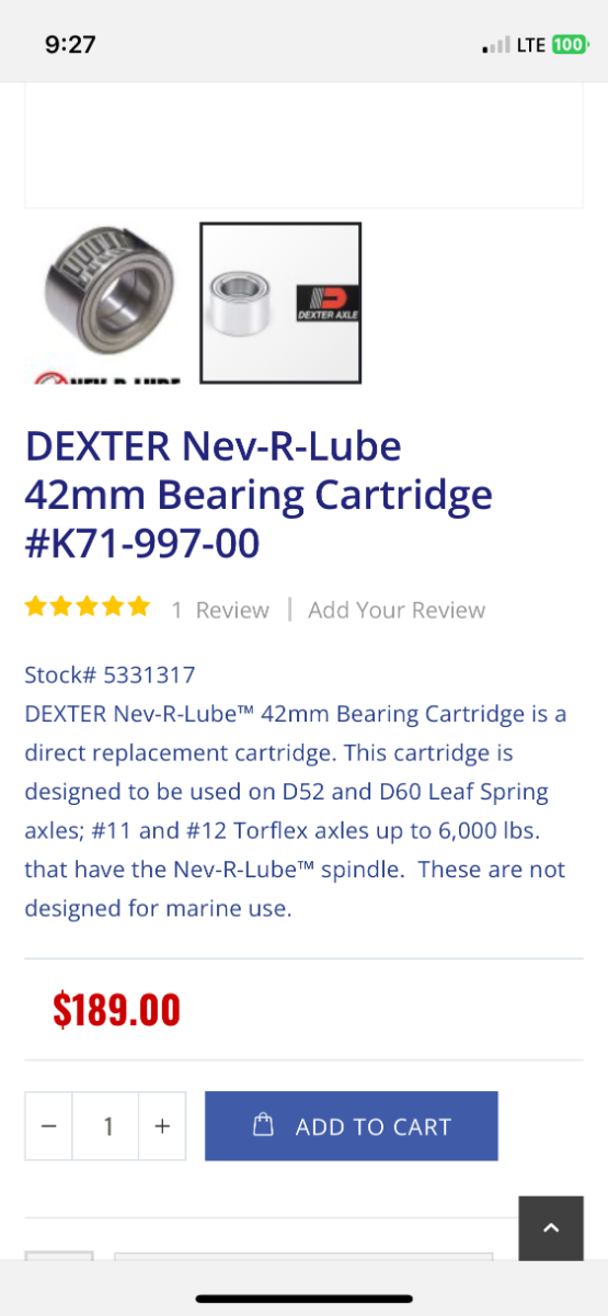

mountainoliver Posted July 28, 2025 Posted July 28, 2025 Several years ago I was going to replace the bearings and brakes on my 3500 pound axles. I contacted a local Dexter dealer and the hub/drum assemblies were over $100 each and the loaded brake assemblies were close to that as well. Of course e trailer was even higher. I called the Dexter distributor that Oliver was using at the time, Textrail. The hub/drum with Chinese bearings were something like $46 each and the loaded brake assemblies were like $45 each with the manual adjust brake assembly even less. Anyway, e trailer is not necessarily the price leader so check around. And absolutely yes! I’d never buy Timken bearings from Amazon. I bought mine from a local industrial supply company that I dealt with for years. Bearings ordered directly from Timken. I think even the ones from Summit may have been knockoffs as well. I could be wrong on that but it seems like someone did a deep dive into this at one point. Anyway, buyer beware! 2 2017 Elite II, Hull #208 2019 Chevy HD 2500 Duramax
jd1923 Posted July 28, 2025 Posted July 28, 2025 1 hour ago, mountainoliver said: Anyway, e trailer is not necessarily the price leader so check around. And absolutely yes! I’d never buy Timken bearings from Amazon. Yes, there’s got to be better pricing for real Timken bearings and the hub-drum assembly! (I’ll get 2 extra bearing kits and the proper tool, no hubs for me.) For those of you who have service companies do your maintenance and repairs, just buy a couple bearing kits to have with you. I do not believe this style bearing will immediately freeze up. There will be warning signs, heat and noises, allowing you time to tow more slowly to a trailer repair shop. But if you don’t have the parts, you’ll be there waiting 2-3 days! Think about the etrailer price of $655. We just purchased whole axles for $1,001 each that include two hub-drum assemblies, two brake assemblies and all working (spare) parts! Who would buy a hub at this price? Maybe I should have ordered three axles!🤣 Alcan was going to price the bearing kit for me, now that I remember. I’ll have a couple items to talk to them about this week. Will keep you posted! 2 Chris & John in Prescott, AZ | 2016 EII #113 | '01 Ram 2500 Cummins!

srthomsen Posted July 28, 2025 Posted July 28, 2025 17 hours ago, jd1923 said: Why is it 5033#? I thought the standard D52 meant 5200 LBS. I'll have to see what my new axles state on the label when they arrive. I have no idea. The tag on the axle on my trailer is located on the top of the axle tube and I wasn't able to get a decent photo of it. The photo that I did get shows a capacity of 5033 lbs. 1 2023 Elite #1403--2019 Ford F150--2.7 Ecoboost V6--10 speed auto--without Max Tow
srthomsen Posted July 28, 2025 Posted July 28, 2025 (edited) Why is it 5033#? I thought the standard D52 meant 5200 LBS. Here is a blurry pic of what I was able to capture on my phone yesterday. I do know that the axle itself may be rated at or to one spec but that the actual numbers can be less if, for instance, the D52 5200lbs axle is outfitted with leaf springs that are rated to a lower # Edited July 28, 2025 by srthomsen punctuation. added content 1 1 2023 Elite #1403--2019 Ford F150--2.7 Ecoboost V6--10 speed auto--without Max Tow

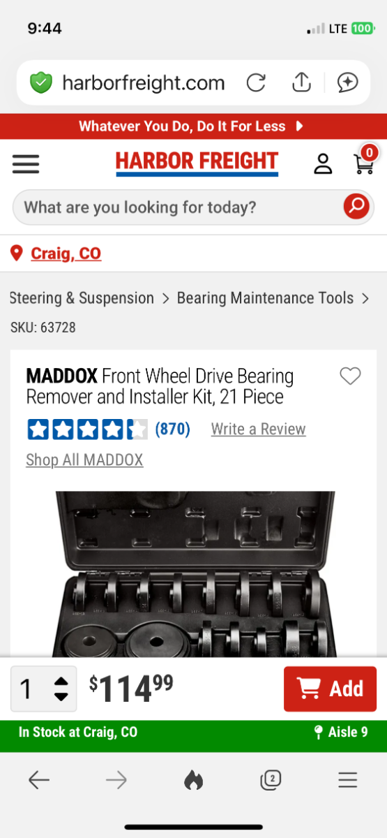

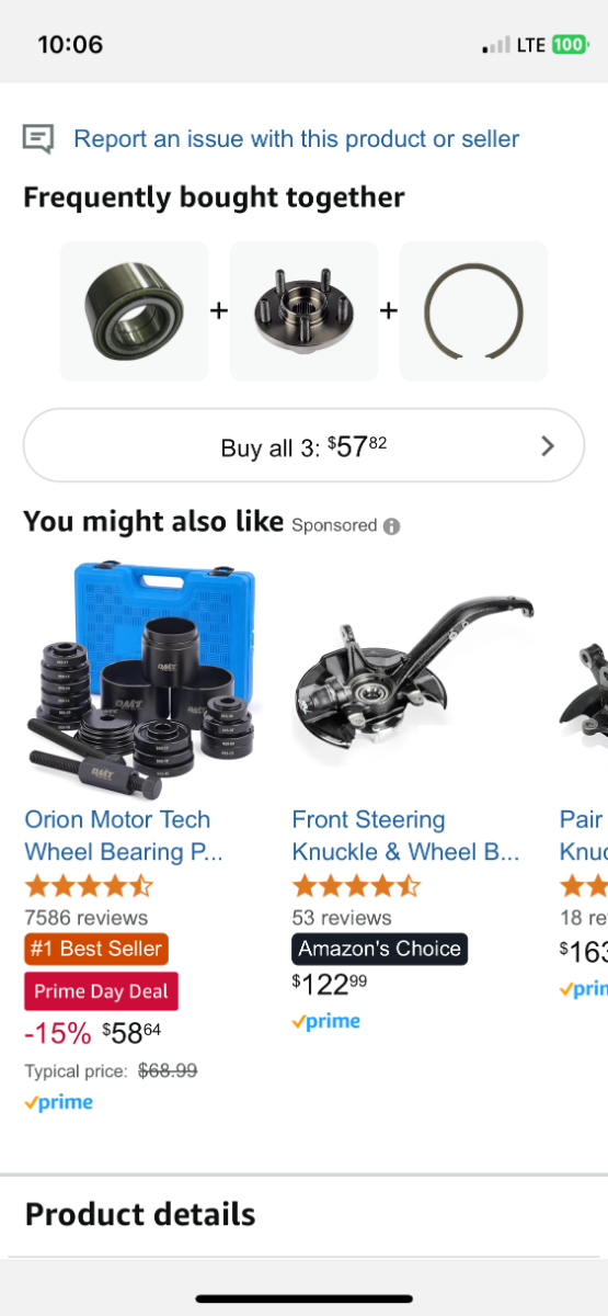

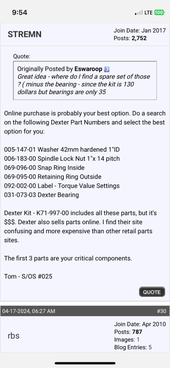

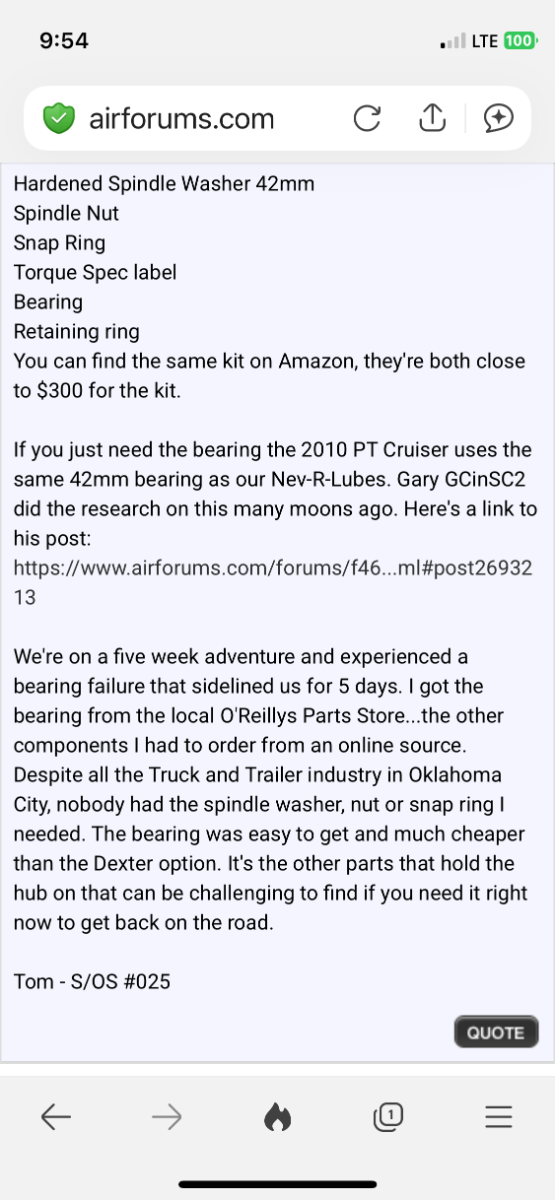

jd1923 Posted July 28, 2025 Posted July 28, 2025 (edited) Thanks @srthomsen. I'll get a photo of the label off my new axles when they arrive for comparison. And thanks again Ken @mountainoliver. I really like the forum post that mentioned it is the front wheel bearing for the 2010 Chrysler PT Cruiser! Went straight to RockAuto.com and found this very reasonable Timken Bearing. Rock Auto for the PT Cruiser shows a different kind of non-locking spindle nut. They do list the larger snap-ring which along with the washer can be reused. I will verify when my axles come that this is the right part. The spec shows 1.654" ID which does convert to 42mm. Nice! Re the bearing press. This bearing has a 76mm OD. We'll need a kit that has a 75mm puck to pull and press this bearing. The Maddox kit that Ken showed from Harbor Freight has one at 2.96" which converts to 75mm. This kit will likely work well and Harbor Freight just sent me a "We miss you" email with 15% off! Two bearings and this bearing kit at $200 OTD plus the cost of a couple correct spindle nuts, now we're talking! 😂 Edited July 28, 2025 by jd1923 2 Chris & John in Prescott, AZ | 2016 EII #113 | '01 Ram 2500 Cummins!

CRM Posted July 28, 2025 Posted July 28, 2025 3 hours ago, jd1923 said: Thanks @srthomsen. I'll get a photo of the label off my new axles when they arrive for comparison. And thanks again Ken @mountainoliver. I really like the forum post that mentioned it is the front wheel bearing for the 2010 Chrysler PT Cruiser! Went straight to RockAuto.com and found this very reasonable Timken Bearing. Rock Auto for the PT Cruiser shows a different kind of non-locking spindle nut. They do list the larger snap-ring which along with the washer can be reused. I will verify when my axles come that this is the right part. The spec shows 1.654" ID which does convert to 42mm. Nice! Re the bearing press. This bearing has a 76mm OD. We'll need a kit that has a 75mm puck to pull and press this bearing. The Maddox kit that Ken showed from Harbor Freight has one at 2.96" which converts to 75mm. This kit will likely work well and Harbor Freight just sent me a "We miss you" email with 15% off! Two bearings and this bearing kit at $200 OTD plus the cost of a couple correct spindle nuts, now we're talking! 😂 My only concern now with going Nev-R-Lube is whether or not the bearing tool can remove/install the bearings with hand tools. Maybe a couple of breaker bars? 2010 Elite II Hull #45, the first LE2 sold. 2020 Toyota Tundra TRD Off Road 4WD 5.7 with 38 gallon tank, 4.30 axle and tow package.
jd1923 Posted July 28, 2025 Posted July 28, 2025 4 minutes ago, CRM said: My only concern now with going Nev-R-Lube is whether or not the bearing tool can remove/install the bearings with hand tools. Maybe a couple of breaker bars? I would think given the hub-drum off the axle is substantial in weight, it would be easy to hold not allowing it to rotate. I would sit the drum on a piece of rubber on my truck tailgate. The press requires a specific socket with 1/2" drive ratchet or breaker bar. I would use some grease to allow the press parts to turn more freely. It should not be too hard. The press is designed for hand-use and advertised "while keeping the steering knuckle and strut assembly intact on the vehicle." Should be easier with drum on a flat surface. Chris is going to Harbor Freight for me today since she will be in the same shopping center for something else and my 15% coupon expires tomorrow. I hope it's the right kit. The numbers look right, but if wrong I can return it later. When my axles get here, I will remove one drum and mount the tool to see how it works and which of the many pucks and spacers are needed for this job. I'll post pics. I'll just need to figure out where to order the correct spindle nuts, given the Timken parts on Rock Auto are correct. 1 1 Chris & John in Prescott, AZ | 2016 EII #113 | '01 Ram 2500 Cummins!
CRM Posted July 28, 2025 Posted July 28, 2025 28 minutes ago, jd1923 said: The press is designed for hand-use and advertised "while keeping the steering knuckle and strut assembly intact on the vehicle." Should be easier with drum on a flat surface. You have more faith than I that it will be easier with the drum on a flat surface. When using it on a vehicle the knuckle will keep the housing from spinning when torque is applied to the press. If it doesn't come off as easy as expected maybe making a tool with a handle to attach to the wheel studs could help? Looking forward to hearing how it goes! 2010 Elite II Hull #45, the first LE2 sold. 2020 Toyota Tundra TRD Off Road 4WD 5.7 with 38 gallon tank, 4.30 axle and tow package.
jd1923 Posted July 28, 2025 Posted July 28, 2025 56 minutes ago, CRM said: ... maybe making a tool with a handle to attach to the wheel studs could help? Looking forward to hearing how it goes! A long HD screw driver or crow bar between the hub and two lugs should hold it. Your spouse or travel partner holding the bar may help for the 3rd hand! Yes, we'll see! At least we are preparing ahead of time vs. broke-down-on-roadside! 🤣 1 Chris & John in Prescott, AZ | 2016 EII #113 | '01 Ram 2500 Cummins!
CRM Posted July 28, 2025 Posted July 28, 2025 12 minutes ago, jd1923 said: A long HD screw driver or crow bar between the hub and two lugs should hold it. Your spouse or travel partner holding the bar may help for the 3rd hand! Yes, we'll see! At least we are preparing ahead of time vs. broke-down-on-roadside! 🤣 Better yet, maybe I could use the axle upgrade to get the wife to approve one of these? https://www.homedepot.com/p/DEWALT-20V-Brushless-Cordless-3-4-in-High-Torque-Impact-Wrench-Kit-with-Hog-Ring-Anvil-Tool-Only-DCF964B/332525396 1 2010 Elite II Hull #45, the first LE2 sold. 2020 Toyota Tundra TRD Off Road 4WD 5.7 with 38 gallon tank, 4.30 axle and tow package.
jd1923 Posted July 28, 2025 Posted July 28, 2025 10 minutes ago, CRM said: Better yet, maybe I could use the axle upgrade to get the wife to approve one of these? https://www.homedepot.com/p/DEWALT-20V-Brushless-Cordless-3-4-in-High-Torque-Impact-Wrench-Kit-with-Hog-Ring-Anvil-Tool-Only-DCF964B/332525396 Yeah, that would do it, no crow bar required! I have the baby 3/8" version and at home use air and a 1/2" drive Ingersoll Rand impact. They have an 1/2" model which should be enough, but if you buy this beast, get something like this to fit your 1/2" sockets. 🤣 https://www.homedepot.com/p/K-Tool-International-3-4-in-Female-1-2-in-Male-Impact-Socket-Adapter-KTI34016/207024761 1 Chris & John in Prescott, AZ | 2016 EII #113 | '01 Ram 2500 Cummins!

CRM Posted July 29, 2025 Posted July 29, 2025 9 hours ago, jd1923 said: CRM, now I believe you are correct in your thinking. Please let the misses know I approve. Get the friggin' 3/4 impact! 🤣 (Do note the press instructions show using an impact)! Now that I see the instructions I think you could *probably* get away with two breaker bars and sockets, and maybe some short sections of pipe for additional leverage? Still like the idea of bringing an impact wrench along though since it would make wheel removal quick and easy too. 1 2010 Elite II Hull #45, the first LE2 sold. 2020 Toyota Tundra TRD Off Road 4WD 5.7 with 38 gallon tank, 4.30 axle and tow package.
