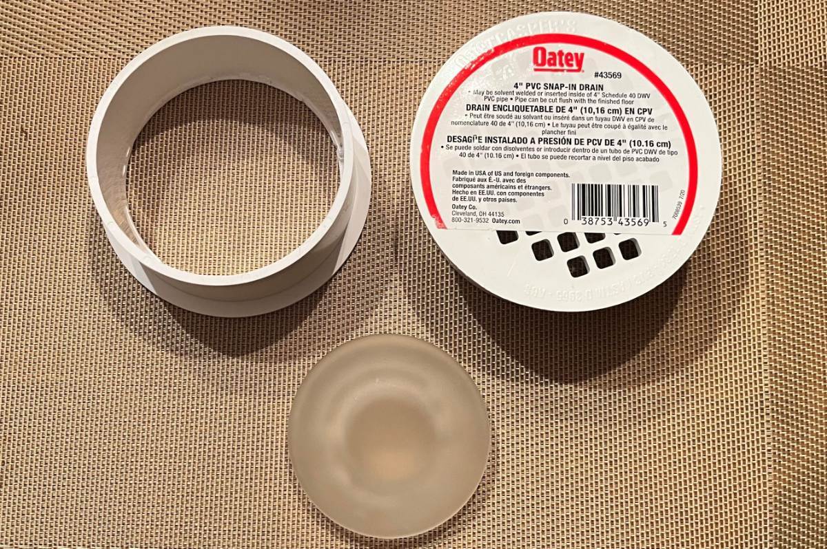

I've had this mod down at the bottom of my Oliver to-do list, and it's hard to imagine, but I'm down to the bottom! 🤣 We have the older glass LED lights that are 3 1/8"dia. The glare from the cabin lights is BRIGHT! And I certainly agree white PVC is the way to go, not black ABS for us and not something painted, extra work and would not age well. Long search looking at all the 3-4" PVC parts at Lowes and Depot and I found these 4" drain covers (see pic). With a 3 1/2" hole saw I cut the center out of one (not easy to keep the drill centered, use patience with the drill clutch on). It looks to be a good fit and these were only $3.60 ea at The Home Depot. They are 1 3/4" deep (off the ceiling). If you look at what @Fritz did above, he used VHB tape to mount his. I'm mounting at least 6 for Cabin and Dinette lights or a total of 12 to do all cabin lights. Getting 2-sided tape all around the perimeter of so many light shades would be a pain and if you don't seal the full perimeter light will come through the cracks. I wish 3M made a 1/4" round bead of VHB, but working flat tape around a perimeter is not fun. After cutting these parts, there is an 1/2" flat along the perimeter, a very good surface for sealing. I'm looking for suggestions for a proper sealant. It should bond to PVC to fiberglass, but not permanently! Something that could be removed with a solvent if necessary, and something that would not damage fiberglass. I know I don't want a silicone-based product (wish silicone caulk was never used on our fiberglass). Besides sealants that come in caulk tubes, or brush on, are there any thin bead sealants packaged like butyl tape? Would some brand of butyl hold these light shades? Any ideas? Thank you.
