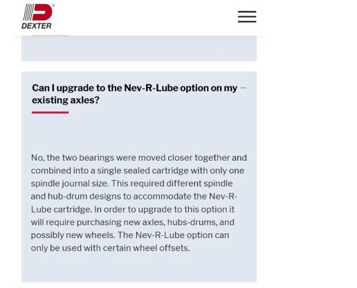

Can someone explain to me (with pictures and drawings if needed) how the Neverlube bearing system works. Being more of a tekkie and less of a motorhead, I have understood that axle bearings are - 1 an Inner race, and 2, an outer race on a common shaft. with shoulder bracing against inner movement of the inner race, and a nut preventing outer movement of the outer race. Someone recently posted on this forum that the Timken Set 49 was a direct replacement for the Neverlube. Price difference being "ΒΌ of" with Timken being the cheapest for once. I have looked at the Timken Set 49, and it is ONE outer bearing sleeve with two inner races. Maybe 2" long. I cannot begin to guess how that works. Please help the mentally challanged.

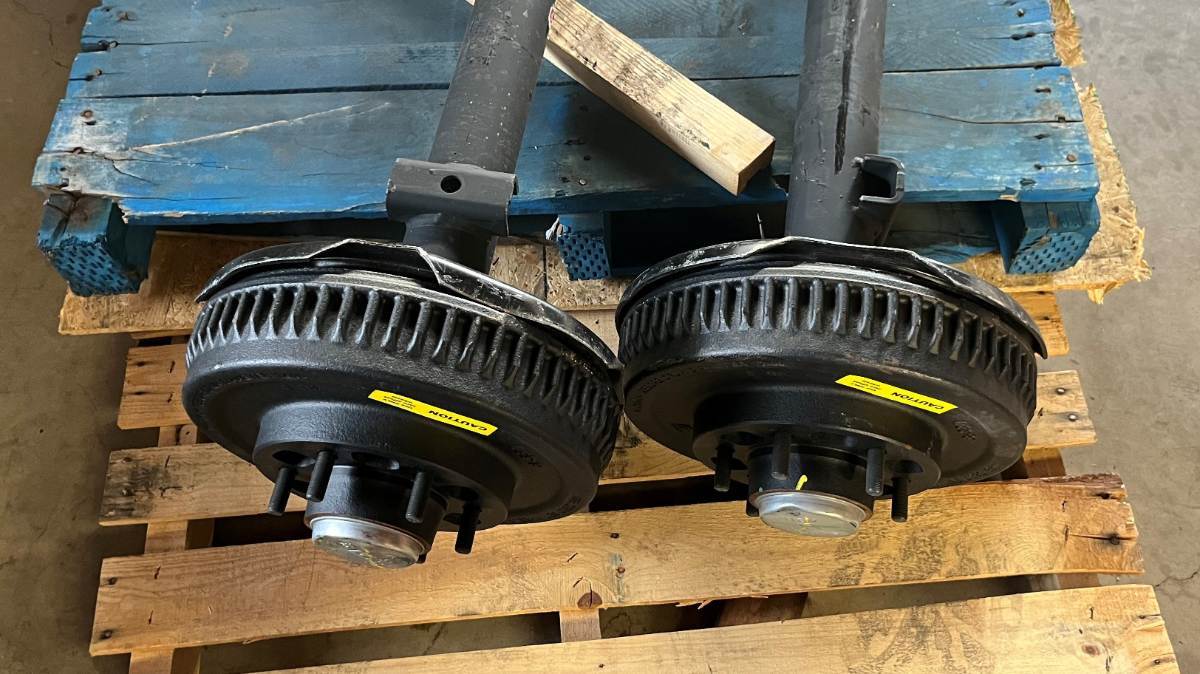

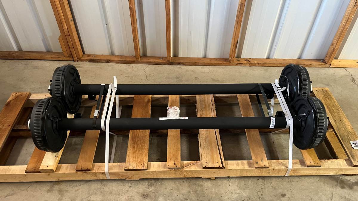

Sorry Orca, those would be my axles! I got really lucky. Tim and Lew got Dexter to replace them on a 2-week rush order, refund my $200 shipping charge which was very reasonable to start with, and keep the first set of axles too! They shipped the second set right, strapped to a pallet 9 ft long! I'd like sell the second set of axles, but I only know of one hull besides ours that has D35 SC=50" axles. That owner wasn't either interested or trusting of half price axles. The first set, although damaged in shipping really only need one brake baking plate and new bearing caps to be whole again. I could fix them up like new in a few hours, but instead I have replacement parts for life! π (Pictures of damage and replacement sets. Notice the difference in the skids!)

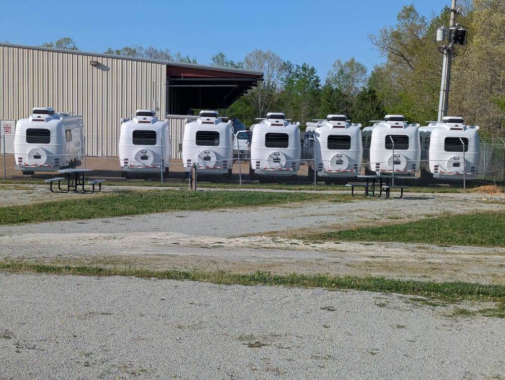

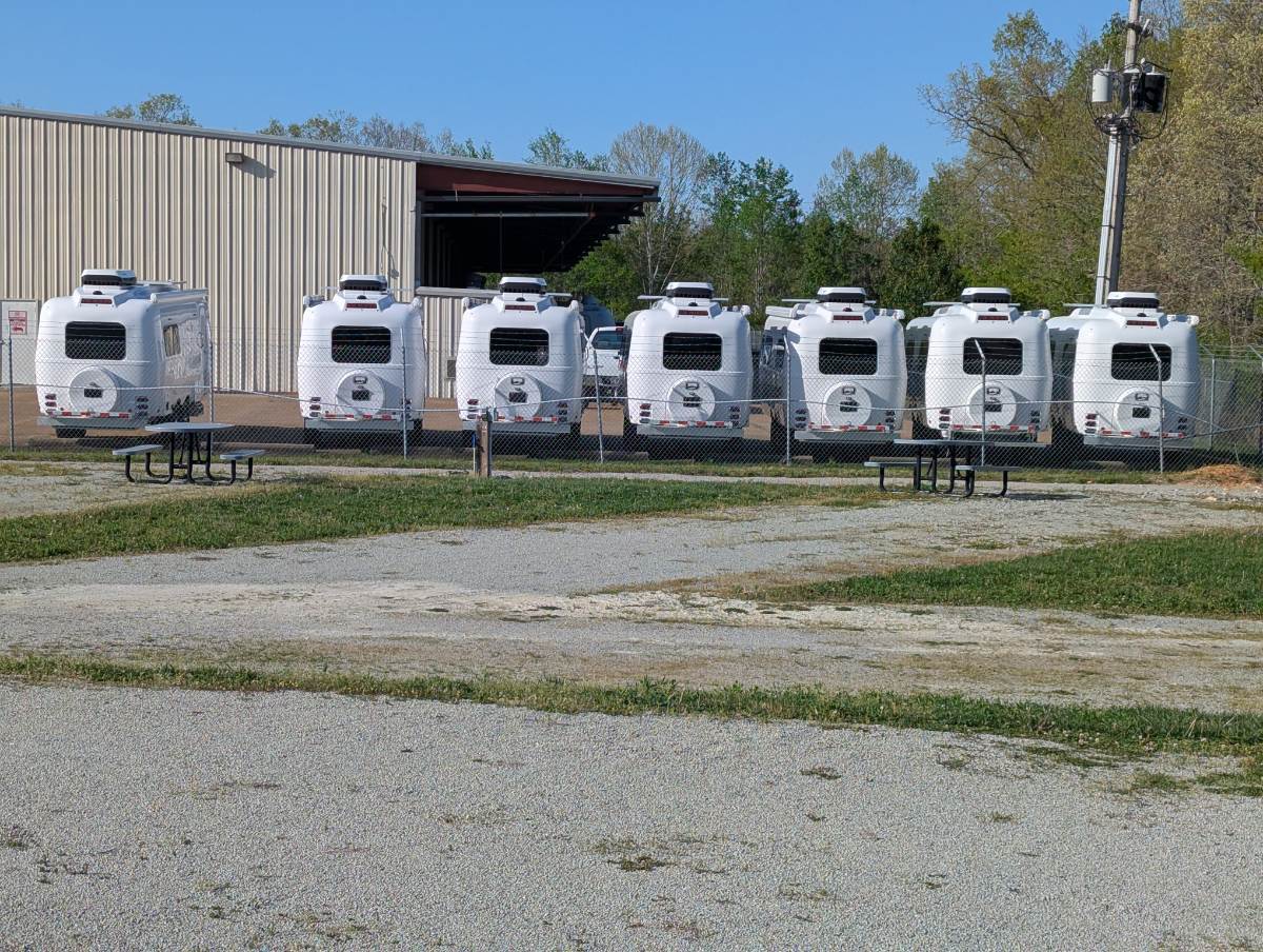

Looking at new trailers in the lot at the mother ship. There are 7 of them. 3 have the second awning. Not exactly scientific, but maybe that gives some indication of the overall popularity of the option?

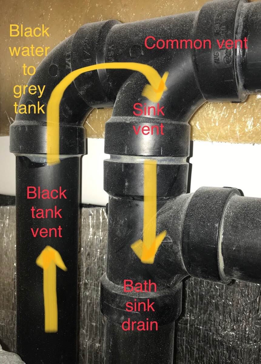

Are they sure itβs kitchen water? Are they adding water to the black tank using the No Fuss Flush fitting? If they are flushing the black tank and have let it get too full and the shower drain valve is closed the water from the black tank can back up in the black tank vent and flow over into the sink drain and rise up through the shower drain and fill the shower pan and could actually overflow the pan and flood the trailer floor. Do not rely on the tank level display when diagnosing water level and drainage problems, or any other time really. I apologize for the βandsβ and the run-on sentence. Bill -

Seems the problem was that the gray tank was full but for others: On older trailers (mine for example, a 2020) you might have a manual gray tank valve. Pulled out is open allowing the gray tank to vent as water from kitchen sink flows in. If it is closed (pushed in) then water could back up into the shower drain if you run a lot of water in the sink. Also, if you leave the valve open while driving down the road, then gray water could slosh up onto the floor from the shower drain. -
