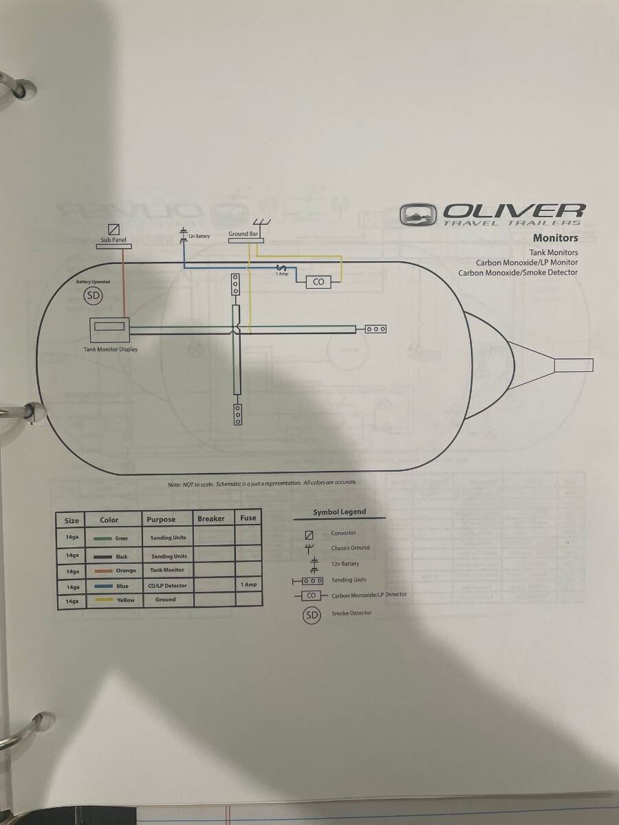

I have a manual for model 709 and 709-PH. The battery level displayed is determined by the voltage supplying the SeeLevel panel. As others have said see if it’s getting power. You said the tech plugged a new panel in and it was dead also. I can’t believe that the tech didn’t also check the fuses as that would have taken a few minutes. I would check the voltage going into the panel and work back from there This schematic is for 2018 LEII hull 313 so it might not be the same for your hull Bill

Our tank monitor is not giving any readings, including battery level. Just wondering if this has happened to anyone else. Some background info, we were in for service at the end of April and the tanks read prior to the service. One service issue was a replacement water heater and I’m wondering if something got knocked loose somewhere between hulls. Unfortunately for us our pickup from Service was on a Friday close to closing time and they couldn’t get out fast enough so we didn’t find the problem until later in the day. We were able to stop in on Monday afternoon and one of the service techs took a look at it and even tried a new monitor panel, but no success. The tech did mention a possible pulled wire somewhere but they didn’t have the time in their schedule that day to find a fix. If there’s an easy fix/solution we’d like to try that before we haul it down to Hohenwald.
