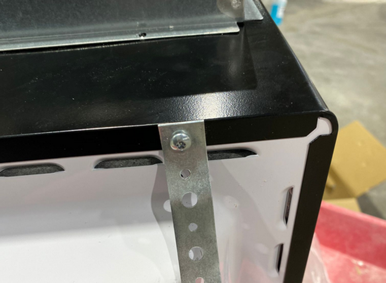

Microwave: Am I missing a piece?
Snackchaser replied to John and Jodi's topic in Mechanical & Technical Tips

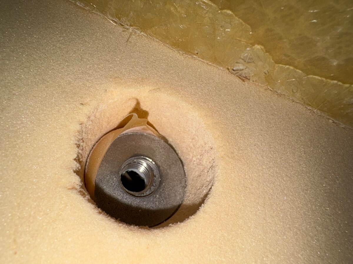

It looks like you're missing the hold-down jack screw. See the my post: "A different refrigerator fan option" for a picture of it. It looks like the nut part is still there from your photo, so the bolt might be in there somewhere too. Look behind the master switch panel, through the round port access, that is where it's tightened or loosened from. Good luck, Geoff -

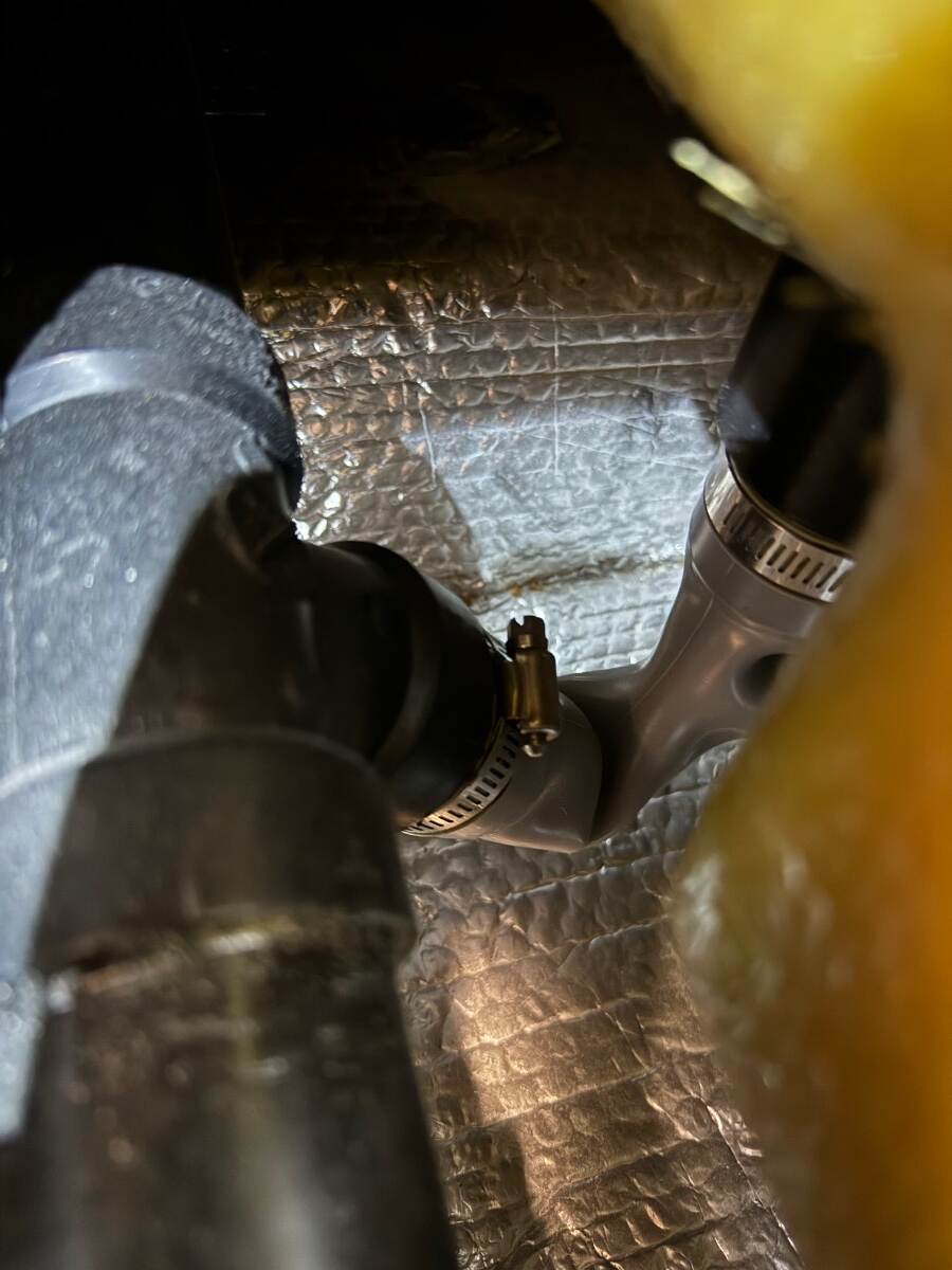

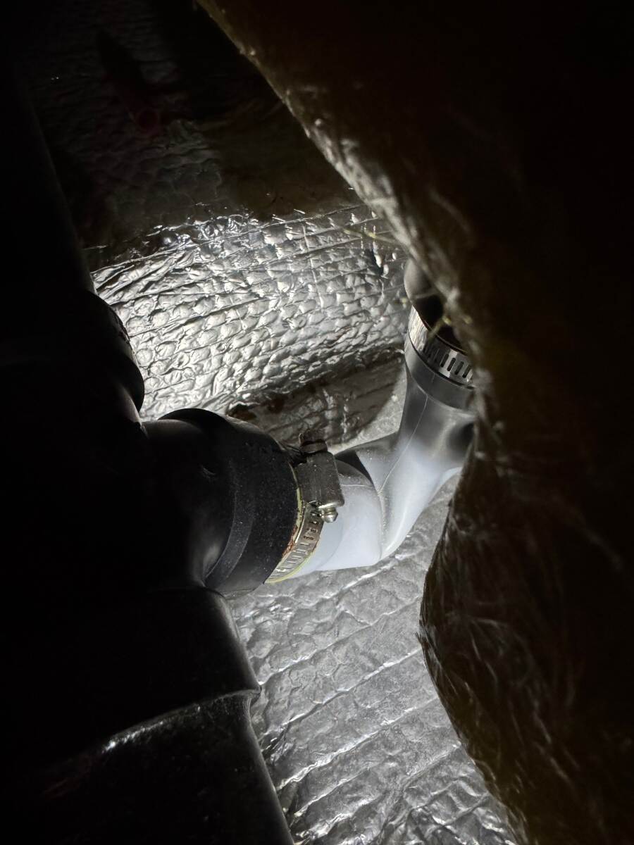

I'm not very handy so I haven't looked a lot under and around the bowels of our trailer, but recently I had an occasion to do so. Looking at my shower drain pipe I saw this: It appears that the 1.5 inch drain line has collapsed. The shower still drains slowly and there's no leaks (yet?), but I'm a bit shocked. While the pipe from the shower pan is vertical, the connection to the gray tank(?) pipe appears to be at a 45 degree angle so that buying a new P Trap doesn't appear to be a good option unless I'm willing to re-plump. Is this normal? I'm open for suggestions.

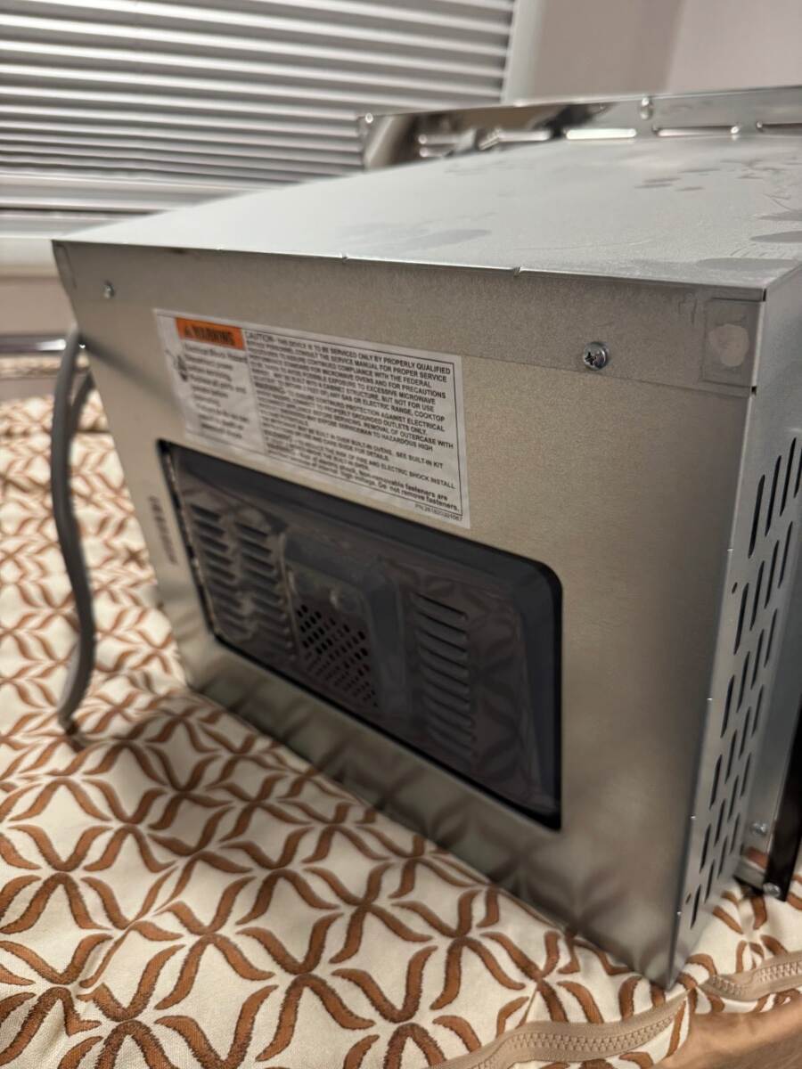

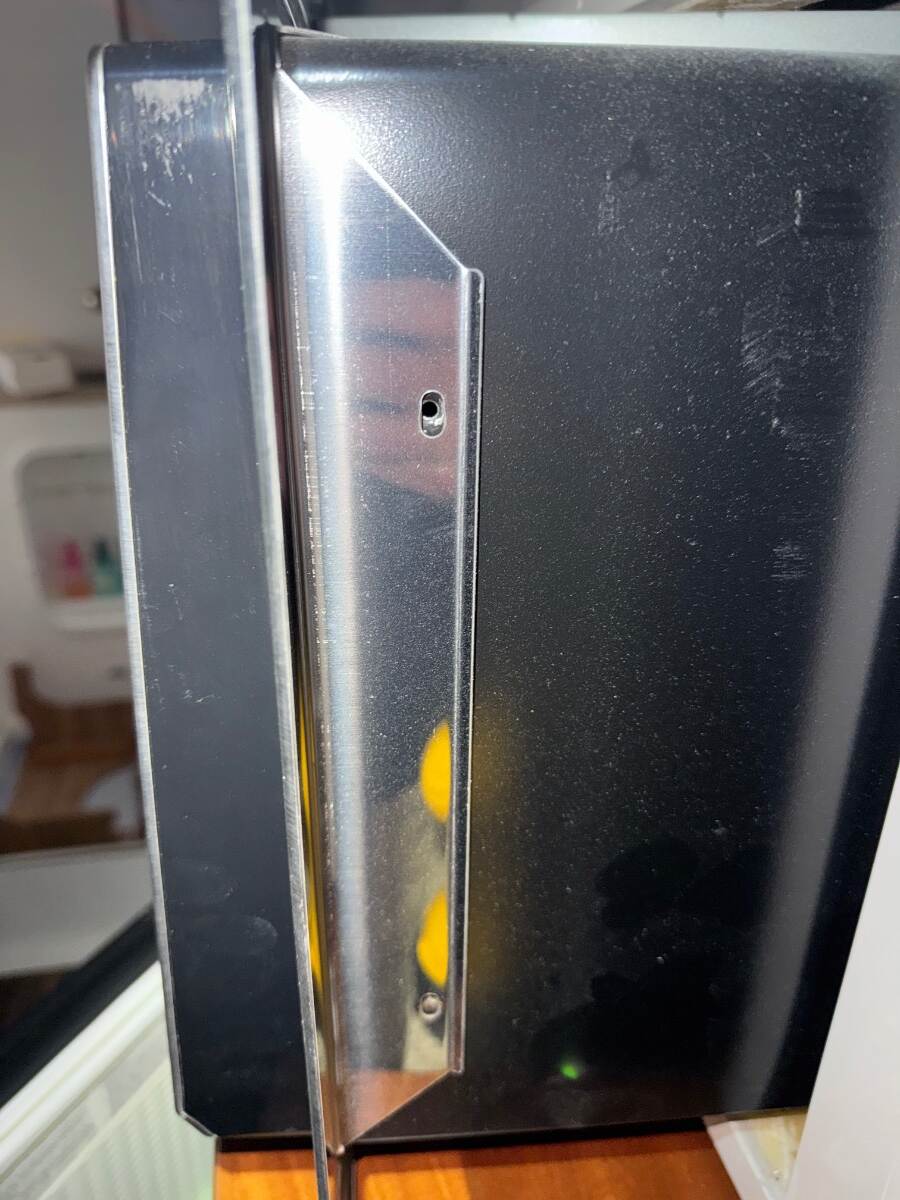

My microwave is loose and moves around inside its cabinet. A review of the forum suggests this happens from time to time and various fixes have been proposed. I'm asking the forum if I'm missing a piece that should have been installed originally. The photo below shows the two screws on the right side of the microwave stripped. This is the cause of the movement. The photo below shows a threaded socket(?) in the microwave cabinet ceiling immediately above the microwave. Nothing is attached or ever was screwed in there. I was informed by another owner that visited me, that there is supposed to be a piece that screws into this spot to hold the microwave in place. Is this true? When I called Oliver, Tech Support told me that I'm supposed to have straps to hold the microwave in place (see Oliver-provided photo below). However, my microwave (see below) has never had straps and there's no remnant of torn straps or stripped screws. Because my trailer is four years old, I'm being told that it's out of warranty and I will have to fix this. I'm not very happy with Oliver right now. I'm looking for confirmation of a missing piece or not and what that piece is called so I could maybe order it. Tech Support said I will have to run straps through the foam, secure them somehow, and reseal the compartment to correct what I think is their manufacturing defect. Thoughts?
