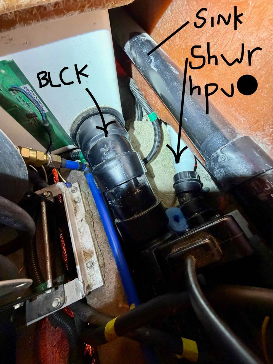

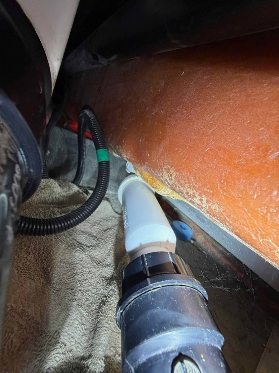

The configuration beneath my front dinette seat differs from yours a lot. While you have a furnace in that area, I have one of my favorite things about The Wonder Egg, a 45 ft 30Amp extension cord on an electric windup spool! My furnace is in the galley area, resulting in a loss of some kitchen drawers from your configuration. Here are two pictures which will show the white HEPvO valve which Larry inserted into the PVC line from the shower to the grey tank. Good luck and let us know if you manage to have a HEPvO valve installed in your trailer. - Today

Hello, any chance that you have photos of the installation? Ron

DBL-R, I also have an early model LE I (2008 - #14) with the same plumbing configuration up front and for years, I dealt with the potential back flow of grey water into the shower pan if the handle for the valve on the back wall of the shower was not adequately closed before travel and the spring actuated foot valve was open. Then, many years ago, a good friend, Larry Gamble, of Little House Customs, fixed the issue by installing a HEPvO valve and magically solved the back slosh issue. The HepvO valve is a one way valve which closes like a duck bill and prevents the grey water from backing up into the shower during nose down or deceleration while braking. Now that handle on the shower wall is always in the out position, allowing water to drain from the pan into the tank and the HEPvO precludes it from making the return trip. I've removed the foot actuated drain plug and replaced it with a small sink screen to catch any small items and prevent them from gumming up the HEPvO valve. Larry said the clearance to install the HEPvO was very tight, but with his skill he managed to get it done anyway. He's retired now making music instead of bending wrenches, but there should be some skilled RV mechanic you can find to make the same modification on your trailer. Good Luck, Pete -

Sorry about the confusion, it’s our first Olli! Yes, it is a 2015 Legacy Elite I Ron

Hey Ron, After seeing this picture, I realized you must have a 2015 Elite I, the single-axle baby Ollie! You should add a signature line so we realize that more quickly. Calling on @SeaDawg, @DavePhelps, @bugeyedriver and others with an older EI to advise! Most of us have the dual-axle larger EII with furnace right rear and there's so much different to which us EII owners would have no clue. Best wishes, JD

I’mmmmm back! So I was able to access my Oliver today and attached is the photo under the seat closest to the bathroom. The circled area on the lower right is the cable that attaches to the pull handle in the bathroom. I tried to follow the cable but there is no what that I can get my hand under there. I am assuming that the circled area on the left is the black tank valve. Any thoughts will be greatly appreciated Ron
