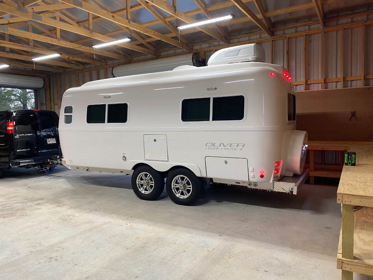

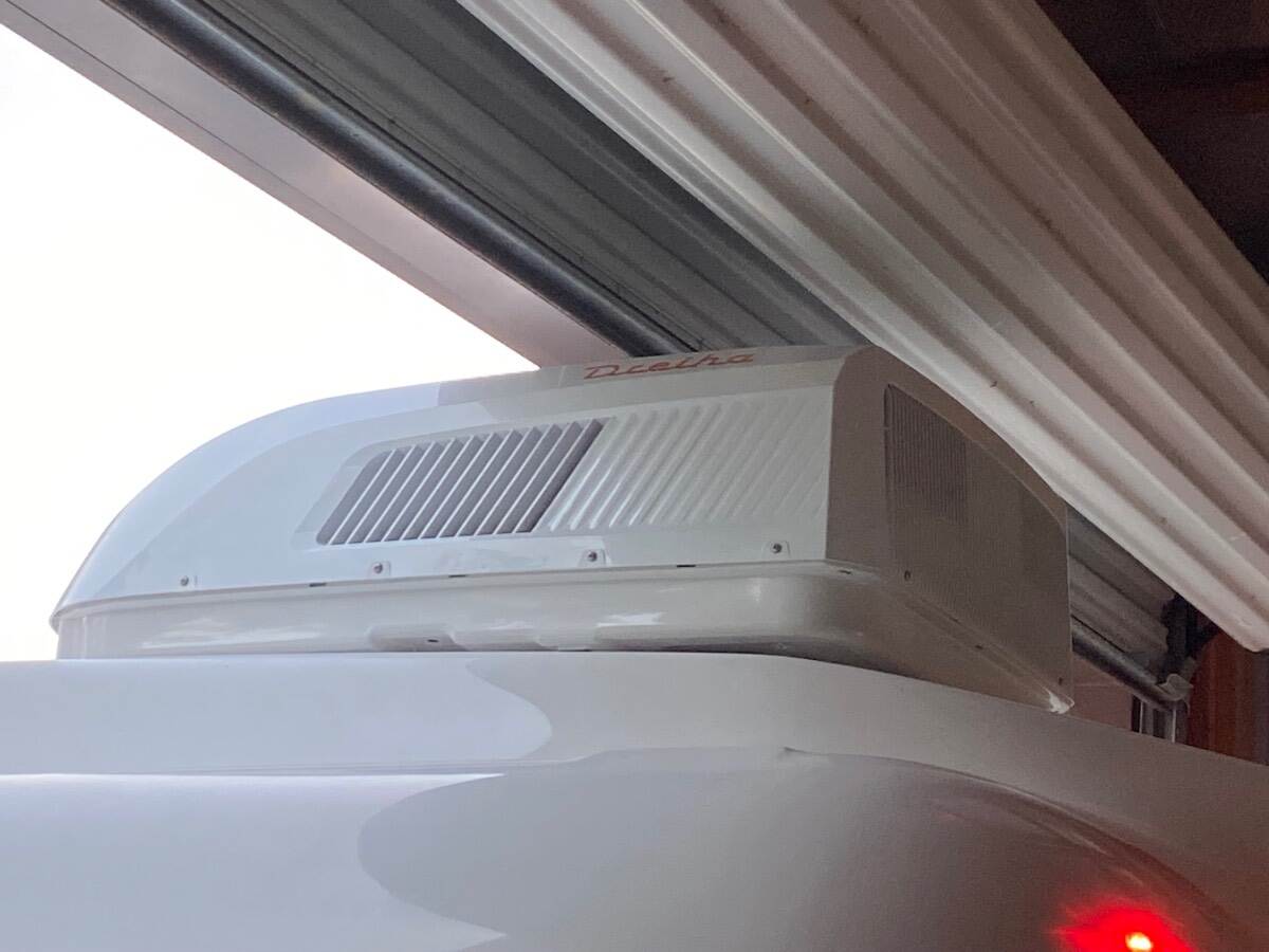

The height of my new shop door is exactly 10’ and with a little gain by the Atmos 4.4 a/c there is clearance, but not much. Gonna have to get up there and take an exact measurement before a spring upgrade. Thanks for your response! - Today
