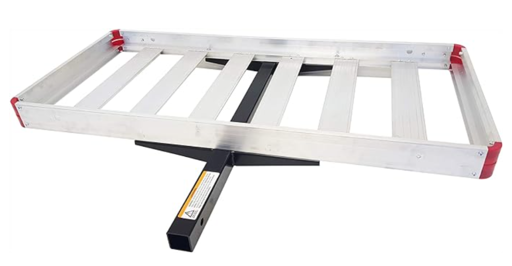

This is the way to do it. You need dual receivers for a viable carrier. Not a 1 1/4" receiver, but TWO 2" receivers!  @rich.dev has a great example, see picture above.
The 1 1/4" single receiver with something like the cheap Kurt carrier (Amazon link above) will bounce and wobble all over the place. Just for a "tank tote" as @Rolind suggested OK, but not much more!

@HDRider coolers are very heavy when full, a tank tote is light when stored empty. Pull your 1 1/4" hitch bar off completely, buy some 2x2" Aluminum stock and build something like what @rich.dev showed above (an excellent example).
You really need the two receivers, so it doesn't wobble up-n-down and left-to-right. The beauty is OTT already installed two perfect receivers for any kind of well-supported shelf or basket. They say 150 LBS MAX for the bike rack. I would think Rich's design could easily hold 250+ LBS, if you want that much weight, that far rear. You want to over-engineer such a cargo carrier so that it is safe and sits nicely for years.

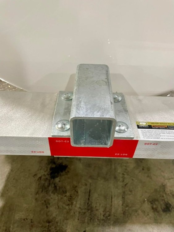

Just spoke with Mike at OTT Service. This new 2” receiver will not retro fit or swap out into the existing bolt holes on your bumper.
It has a wider bolt pattern.
I'd just sandwich the cross member with a larger secondary backing plate in between and below with proper hole spacing for the hitch and throuth bolt the whole thing. It would be stronger than the above arraignment and solve the problem of the mis-aligned holes.

No worries, get yourself one of these or similar, much studier than that new Oliver 2' receiver!

It's not standard and free, you would have had to specified wanting it in the original order. I'm sure you can still buy it, but you will have to drill four vertical, perfectly spaced holes down through the back end of the frame rails to mount the two receivers.
I agree that that is a much better Hitch Receiver but he would still have to have the crossbar to mount it on.
