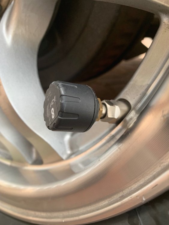

Can anyone tell what breand of metal valve stems work well on our rims (2021 Elite II). I purchased a TST TPMS system and want to use metal stems. Had a local dealer install the metal stems. The TPMS sensors have been on three days. Today when checking the tires to see if the tpms read the same as my guage, one tire was a few pounds low. I removed the sensor, added air, then when I screwed the  sensor back on there was a distinct air leak. Yjought it was the core, but it seems air is leaking where the stem meets the rim. must be a bad seal. So my thought is our rims may need a particular brand of stems? Monday moring i'll be on the phone with delaer.

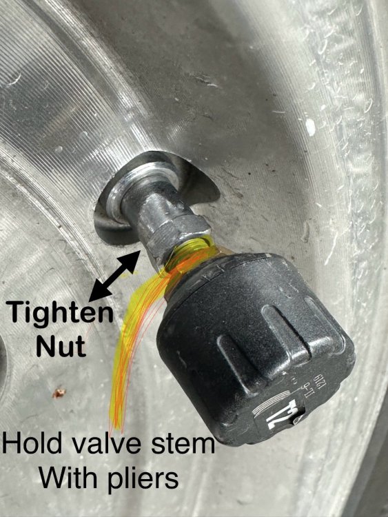

We had a similar issue until I figured out that Metal stems can be tightened down at the nut to stop leaking.
To do the job, take off the sensor.  Hold the threaded valve stem with needle nose pliers while tightening nut.  Careful to not damage stem threads.

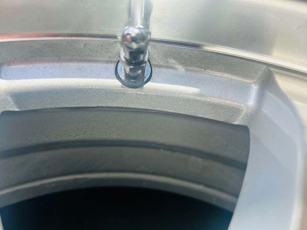

Conversely, I had two of the OLEll stock rubber valve stems fail on a return trip from West Texas last summer, ambient daytime temps were 110-115°. After the second time, I pulled into a Discount Tire in Fredericksburg, TX and had metal stems installed on the Oliver and a set in hand for installation on the TV once home. At the time of TST purchase, the instructions stated use of rubber stems was acceptable. However, their instructions have since been revised advocating use of metal stems only. Based on Discount Tire’s assessment, the extreme heat caused the rubber stems to flex more along with the added weight of the monitors, thus stress fractures resulted in failure. I was told they recently had several other trailers brought in with the exact same issue. The metal stems are shorter than the rubber ones and have not presented any problems thus far.

This is what Discount Tire installed on my Oliver. I also bought a set of the exact same stems from them for my TV; took it to DT upon my return home and they did the install. No issues to date.

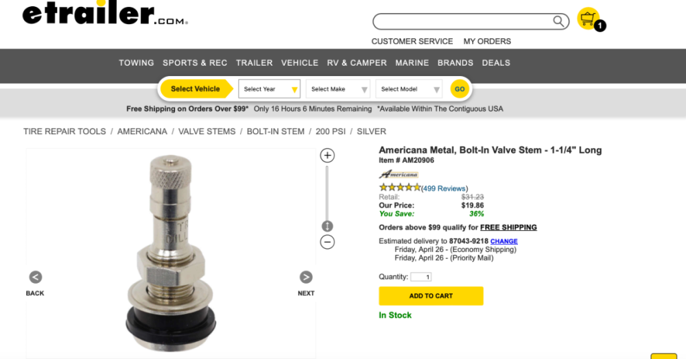

In fact in New Mexico (I understand in other states, as well), State Police will issue citations for those driving on E-rated tires and rubber stems.  Evidently, metal stems are far less to cause a catastrophic tire failure at the higher pressures than rubber stems - not that anyone in this community runs at 80psi...
Rule of thumb - if you're running any tire over 80psi, you should consider metal valve stems.  These, for example, are rated at 200psi and are recommended by eTrailer for E-rated tires, FYI:

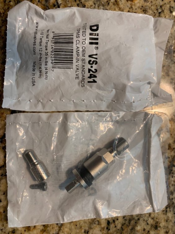

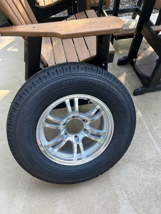

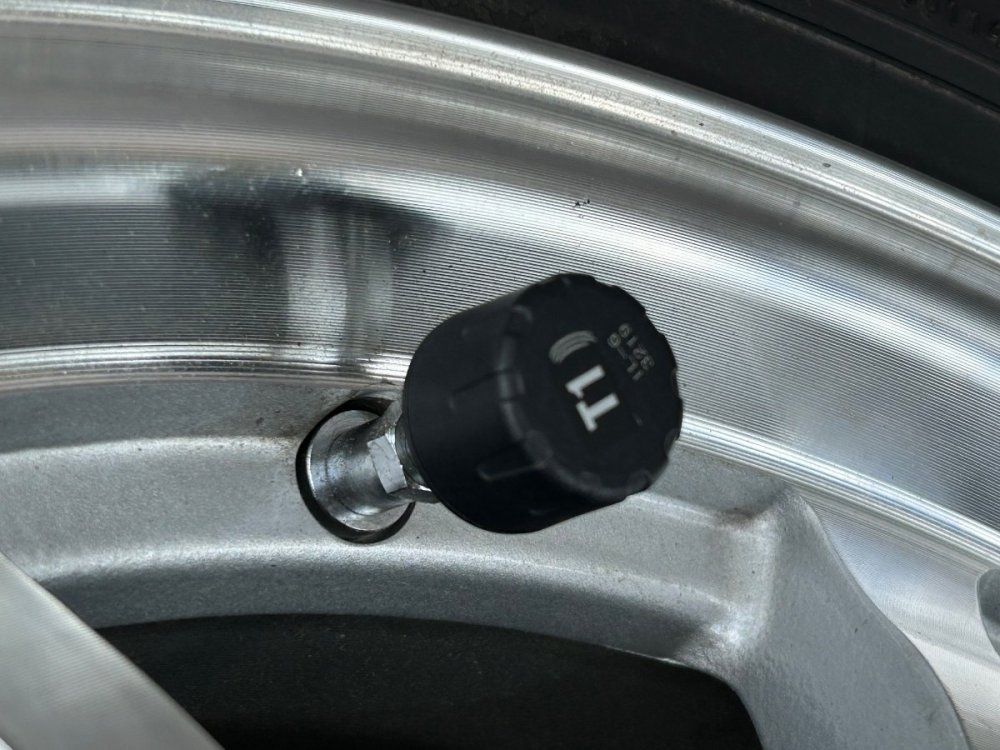

A short follow up:
I dropped off my (spare) tire/wheel today just to be sure that my local DCT had the metal stem I needed in stock. I have an appt Wednesday morning to have all 4 tires rotated, balanced and the remaining 4 new metal stems installed. They just could not squeeze me in today. Not a big deal, and fair enough as they were pretty slammed. They were kind enough to at least get my spare swapped out. No charge of course.
I returned home, remounted the spare on the back of XPLOR. This precludes me having to remove the bike rack etc at DCT this Wednesday when I get the rest of the wheels done.
This metal stem seems to be a bit lower profile or shorter than the OEM rubber stems which suits me fine. I am thinking it will keep the TST TPMS cap TPMS transmitter a little closer to the inside of the wheel away from road rockets. I am really liking the Cooper tires and as they appear to be wearing really well. I will replace them with a new this set next year. Very happy to have 16” rims as well.
Cheers!
Roll On!!
Cheers!
Its also nice have a full/same-size spare, roger?

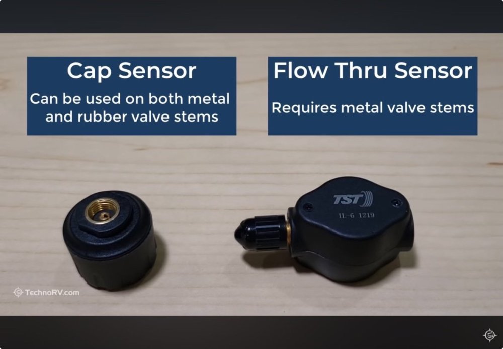

For a little bit further clarification:
I called and spoke with Customer Service rep Maria at the TST Office in Cumming, Ga. (770) 889-9102. I asked her if rubber valve stems can be used with the 507 TPMS bottle cap style sensors? She said yes. She went on to say, that an application requiring flow through sensors, it would require metal valve stems. To their knowledge nothing has changed in the install instructions with regard to use of rubber stems with the bottle cap signal sender.
Safe Travels!
Thanks for bringing this information to our attention, I stand corrected!  Going back to a past FB comment I wrote: I went with the equipped rubber stems until they started failing. Our Texas heat is brutal and in the 110°+ heatwave where traveling my tire temps reached 105°+. Hopefully the aluminum stems will perform better in these extreme conditions.
I have no regrets switching to the metal stems, for peace of mind if nothing else. Again, thanks.

You bet Ron, we all get by with a little help from our friends. I kept my appt this morning with DCT and still had all my tires balanced and rotated and stems switched from rubber to S/S. I think it’s the best path forward. 👍🏻
