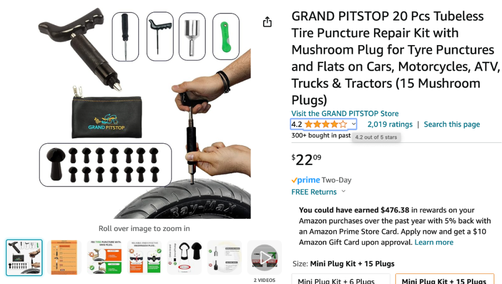

We keep the ViAir tucked in our collapsible plastic milk/tote crate inside the "garage."  The tire plug kit (same one we use on for the scooter) sits right next to it...(actually plugged a rim pinch flat on a GS1200 with about 6 of those mushroom plugs with a healthy amount of glue and the guy made it out to the pavement and to a shop):Screenshot2024-04-25at8_13_01AM.thumb.png.73f1dc59e112f82f700e2c9a60789751.png
