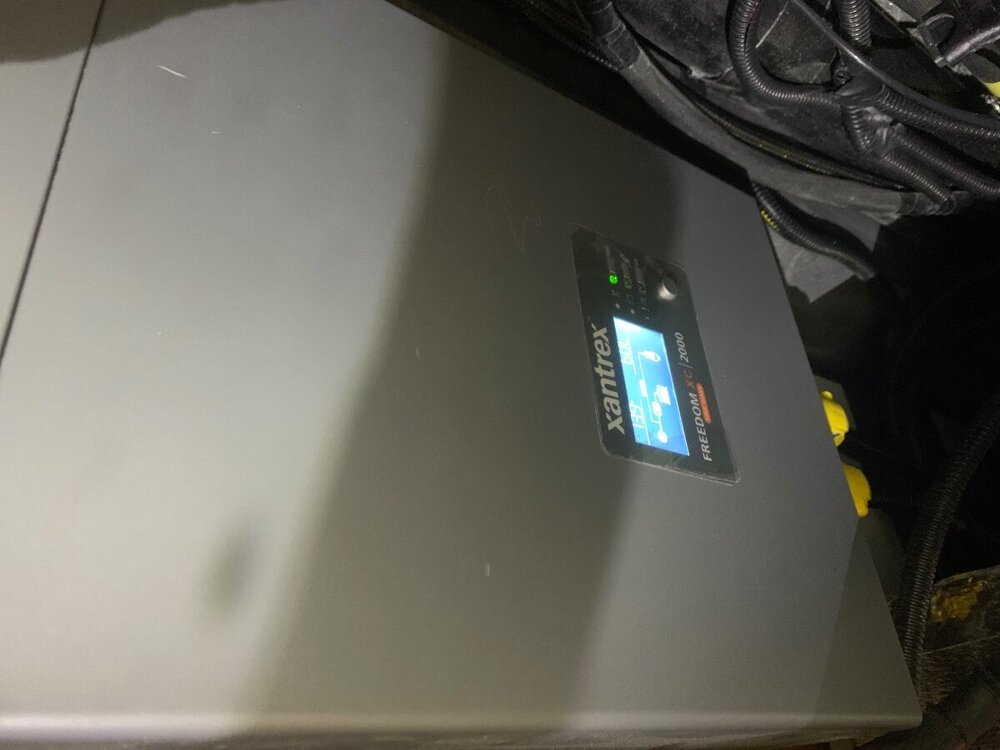

I recently realized I did not have my inverter in the Off position at both the Xantrex and wall-mounted remote. The VictronConnect app now shows -0.24A Current, which is in line with your results.
2020 OLEll, Twin, 579:
Ron... how exactly do you turn the "inverter" off ?    You mention two locations, one of which is the wall mount.   Thats the only place I've ever turned it on/off.   Where is the second place?  Is it the breaker (under dinette)?   I have only recently tested that location as well.  SO off on the remote and off at the breaker panel under the dinette.
   Our 2022 Ollie has the 3000 watt inverter but I'm guessing all things considered both are the same.
There is also a control panel with an On/Off button on the face of my Xantrex 2000. The wall-mounted remote is used to control power to the unit and the one on the Xantrex is kept in the Off position.
