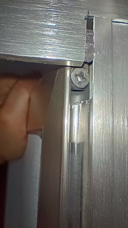

I've had the same problem with mine. Initially when I inspected it I found the door and frame to be surprisingly square and the mitered joints to be firm enough to resist torquing easily by tugging on them. The only points of visible wear were a little at the latch and the plastic seal thing at the bottom. The odd thing to me was that the door would lift a little when closing and drop when opening. Thought that was a feature.
Recently I looked closer at the hinge and think I found the issue. The hinge is a solid aluminum pin flange running top to bottom though the barrel. It is  held in place  At each end by a there is a small steel bar that is tapped for a screw that holds the pin in place. It looks like the top hard steel bar grinds on the soft aluminum pin shaving it away letting the door drop slowly over time.
My thoughts to remedy this is to place something like washers on the pin to raise and protect it, but I have not had the time to remove the door to see what could be done.
Hopefully this will make a lot more sense with these photos.
This is the bottom of the hinge with me  lifting the door up. Couldn't get the image to orient properly.

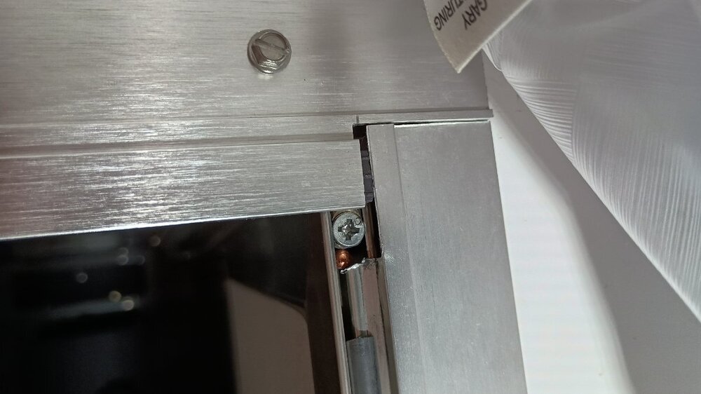

This is the top hinge, notice how the top of the pin is getting deformed. I think the angle on the top of the pin explains why the door lifts when closing.
This is the top hinge with me lifting the door up, so there's a considerable amount of play.

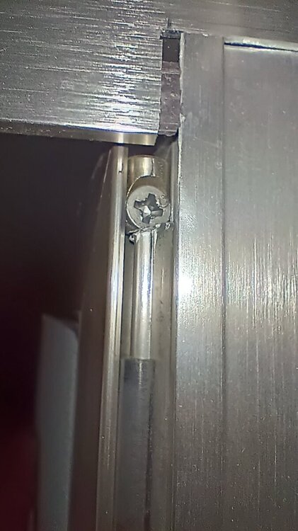

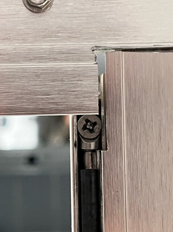

I just took a look at my door and it doe not have a bushing under the hinge. It appears that the screw at the top and the screw at the bottom of the door are adjustment screws. My initial thought is if you loosen both top and bottom screws then retighten both screws while lifting the door up slightly in the process to achieve the clearance you need at the bottom lip of the door to get it to clear and close properly.
Please let us know what you learn from service.
Bottom-
Edited by Patriot
Thanks @Patriot
In my door those pieces above and below the screw (in yellow area on your pix) are missing.
tried loosening, lifting  and tightening to no avail.
I think something fell off or wore away

TopLookingout.thumb.jpeg.95354fe10962268364bbda3e20724a66.jpegBotLookingoutt.thumb.jpeg.9469ce6d6d4dca56966de25ce3350f11.jpeg
Yes, it appears so.
Just added.  It also appears in the pic's as though the Phillip's Head driver 'spun' in the screw head during the install...
Edited by SNY SD UP

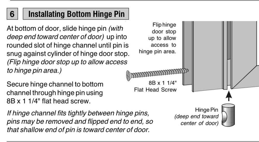

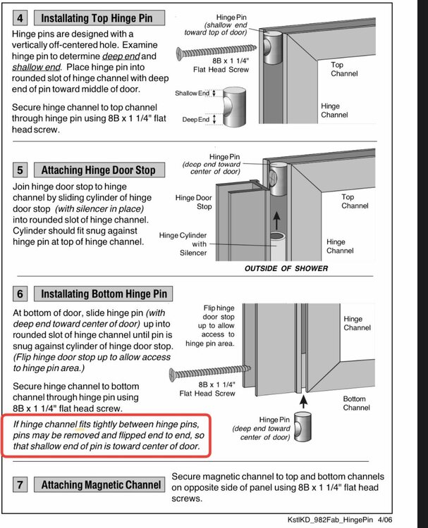

From the company that makes the door:
KstlKD_HingePin_982.pdf
Excerpt below of bottom.  It appears my hinge pins have worn away the silencers sleeve so it now drops the door down.
once I get confirmation of what’s happening I’ll update.

Thank you for posting the assembly instructions.
What stands out to me is the instructions say to insert the deep end of the hinge pin toward the center of the door. Both of mine have the shallow end toward the center of the door. Maybe the deep end acts as a buffer (bushing?) to prevent it from wearing away the hinge door stop. The weight of the door is mostly supported by the top end of the hinge door stop where the hinge pin rest and that is where mine is damaged.
Judging from the photos it looks like Patriot's hinge pins were put in correctly or they are different. Your hull and mine are closer in production than Patriots.
Do you know if Oliver buys these doors as a kit and assembles them or buys them already assembled? If the former it might explain some inconsistencies in assembly.

What stands out to me is the instructions say to insert the deep end of the hinge pin toward the center of the door. Both of mine have the shallow end toward the center of the door. Maybe the deep end act as a buffer (bushing?) to prevent it from wearing away the hinge door stop. The weight of the door is mostly supported by the top end of the hinge door stop where the hinge pin rest and that is where mine is damaged.
I just looked at my hinge pins and they appear to be installed opposite of those directions also.

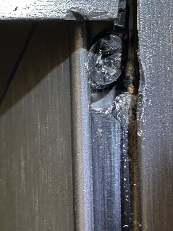

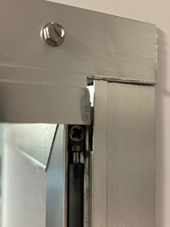

Here’s the failure:
top hinge lins have worn away on the lower side of the pin.  This causes  door to drop and stick.
Another owner put 2 BBs in that space, but new hinge pins are the fix.
below pix is with door lifted and you see the space that has ground away.

When I read the door installation instructions, there does not seem to be a wrong way to insert the hinge pins.  They suggest putting the long portion of the pin toward the middle of the door, but then state that the hinge pins may be installed with the short end toward the middle of the door if the hinge channel is too tight between the hinge pins.
It does seem that the hinge pins would last longer with the long portion placed toward the center of the door.

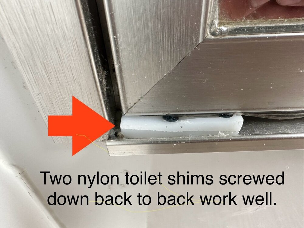

In my case the ball bearing on the top hinge didn’t work, so my temporary solution are some nylon toilet shims screwed down to the threshold.   They hold the door up and are slick enough to bear the load.
When I get home I’ll do the full repair (assuming the parts arrive.)
