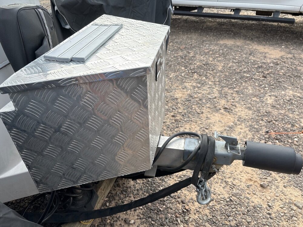

I wanted a front storage basket that my generator could travel in that would also have enough extra space for a couple other items. This basket fits over top of the jack so there is no wasted space behind it, and I didn't have to drill any holes in my LEII to attach it securely! I used two pieces of heavy guage 1" aluminum pipe across the bottom of the tounge and four 8" bolts that are through bolted to the basket on the sides. I used square rubber spacers between the rack and the fiberglass tounge which allows cargo straps to secure items in multiple locations. An added bonus is the basket framing is spaced perfectly to allow the rubber feet on my generator to fit securely over it (I did stick four more rubber spacers to the bottom of the generator where it straddles the basket framing. The basket, the generator, and the other items add about 100lbs to the tounge. I will be offsetting this added weight with a receiver style bike rack I will be adding to the rear of our LEII (more on that in a future post). I measured how tightly I will be able to now turn (especially while backing up), and I should be fine. I am very happy with this storage basket and the price! 😊
I would be more concerned when turning sharp corners or turnarounds with your setup; even backing up into a campsite pad could be challenging, which is usually not a straight shot! Aside from that, you’ve made good use of this valuable real estate; really like the gas can mounts. Many owners have added weight to the tongue and seem pleased, rear additions or not. Good luck with your endeavor!
2020 OLEll, Twin, 579:
Sea Biscuit Metal Designs has generator boxes that are enclosed specifically designed for Oliver TT along with other accessories.
I know a lot of owners have them.
Ditto.  I would only say "Danger Will Robins Danger".  There is a good reason OTT cut off the corners of the front box.  I and many other owners have the "witness marks" to prove it.  😞

Certainly a good price on this one. You made the frame weaker by drilling through it in 4 places. They show it mounted with U-bolts. I would add a steel plate under the compressor, large enough to cover all frame members short of the outer perimeter. Hold it down by the same 4 bolts to strengthen those points and better support your generator.
I also like the ability to pull U-turns, steering fully cocked. I've found that even with my long-bed truck, Oliver in tow, I can pull a rather tight U-y when needed, as sharp as I can turn without the Oliver in tow.

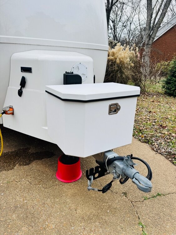

I'm happy with the basket OTT installed. We don't carry a generator, and our LP fire ring and several accessories fit nicely up there.

We have the Oliver front storage basket, and use a Rubbermaid Action Packer 24. There is extra space around this, as it doesn't completely fill the basket. We'll sometimes stuff wet tarps of carpets in there rather than inside the trailer or SUV.
