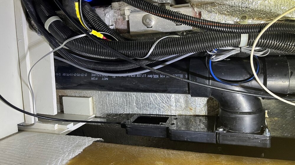

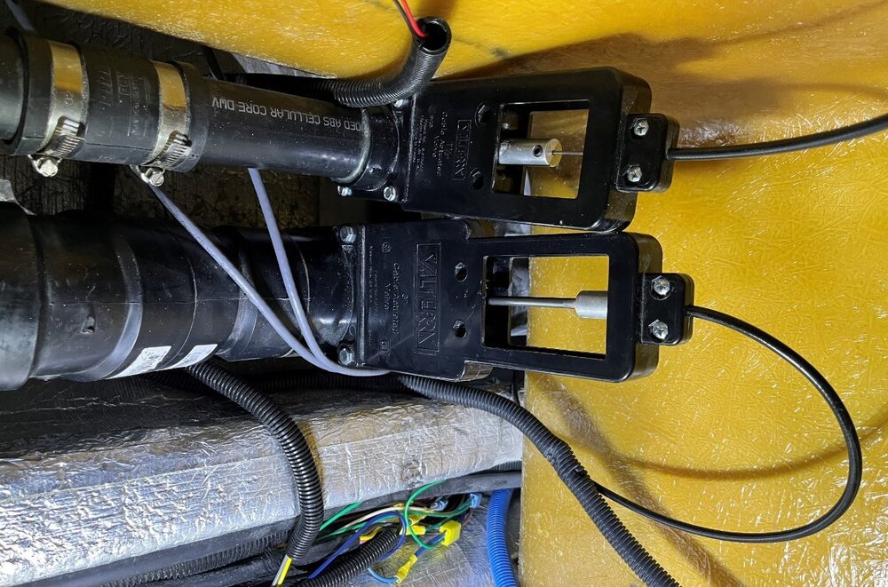

To start, I removed both valves under the front dinette seat. The 3" black and the 1 1/2" gray valves were originally installed angled towards and touching each other, with the gray valve jammed against the fiberglass wall. I sawed off the 1 1/2" ABS at the waste valve flange so that larger motorized valve could be installed. Purchase of a new flange and two couplings was all that was needed, as I was happy we had some ABS glue. With the plumbing out it was so easy to run wiring for our DC-DC charger from the hitch to rear dinette seat, an added bonus.
At first, I wanted to install the power switch near the entrance door so that it could be reached while standing outside. Thinking through the extra work and that it could be easily damaged or switched accidently, I installed it right there under the dinette seat. Here the provided wiring harness reached the buses under the rear dinette seat w/o modification. I cut a tight-fit rectangle opening for the switch alone, tossed the large faceplate and by-passed the odd fuse/reset button, adding a 5A fuse at the +bus. When the valve is open a thin red LED shows which can be seen from outside the entrance door. It is soooo great to merely press a button to work this valve!

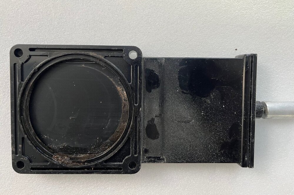

A bench inspection of all 3 valves showed something quite interesting. With cables detached, the black waste valve opened and closed easily yet the seals were crusty and looked more worn. The seals on the gray valves looked to be in better condition yet the valve mechanisms on both gray valves were stuck, all gunk-ed up!
My thinking is soap and/or tank additives in the gray plumbing caused this and the black tank is certainly a different chemistry. I cannot be sure with 3 prior owners of our hull what was used through the years. I remember our good friend Steve @ScubaRx writing that he does not use additives, has not for years, and I believe we’re going with that plan going forward.

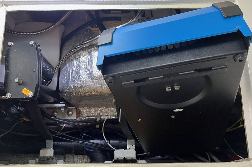

I was so hoping not to have to replace the gray waste valve since I had installed our Victron MP2 directly over it. Last week I reached down and around the inverter and with much pain and patience. I loosed the Allen key on the cable and the two Phillips screws to remove the sheath. With the cable detached I found the valve was near impossible to move by hand. What I feared came true, and today with much pain I removed this valve.
Was very happy to get the valve out and in only 2 hours, considering all. First of course, I removed the ground to the batteries and switched off the solar. I had to unstrap the inverter and pull the 42 LB beast up far enough out of the way to work below it. I used a steel bracket to hold it up. I feared I had taped the shelf down strong with the VHB tape, but it popped off with a strong pull due to the slick shelving material.
The waste valve was jammed so hard into the floor that the two bottom bolts were extremely difficult to remove (see impression of the waste valve in the floor insulation in 2nd picture). They were also rusty given their bottom location. You needed two open-ended 7/16” wrenches and the back bolt is extremely hard to reach being under the aisle floor. I spent 30 min on these two bolts alone! I’m really good at wrenching in tight spots from considerable experience. Most of you reading this, I strongly suggest getting OTT to replace this valve when you feel "it’s time." If they charge more than a hour labor, a good retort would be, “Well you put it there!”
There was a rubber mat installed under the gray tank which was halfway under the waste valve. I cut this rubber out in the area where the valve is bolted to make the reinstall a little easier. The gray valve was much worse than the picture reveals and the fact that this valve was installed horizontally makes all the residue collect on the lower side causing friction on one side adding to overall pull & push resistance.
I replaced entire valve assembly for the gray and just the seals on the black. The gray pull cable is about 4' short and looks fine with a slight curve. I will replace the 144” black cable when it arrives. Before we travel next week, I’ll get the garden hose in the Oliver, fill the black and gray tanks some, run water into the shower drain to test all 3 valves.
Tomorrow I should install the new gray valve. It will not be easy as the two flanges do not sit parallel. The two bottom bolts will be fun again! Then I need a plug and some fiberglass repair for the hole in the bathroom wall, and I'm sure I'll see other needs.

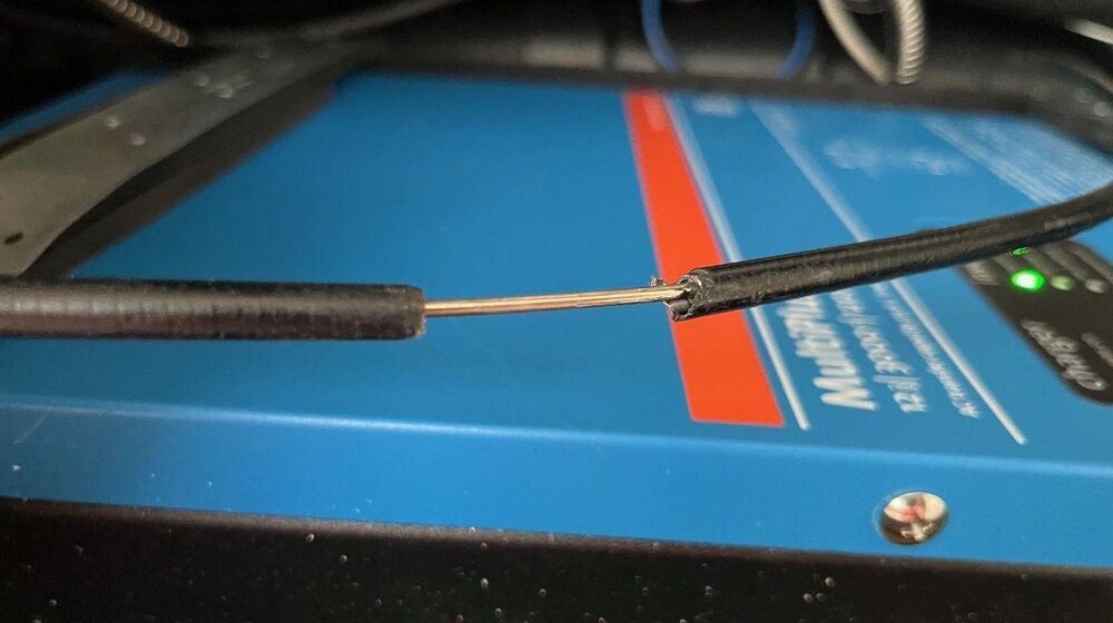

My original symptoms were a black tank T handle that was VERY hard to pull out - to the point I was sure that the plastic T handle would break off. OTOH, it pushed in very smoothly and easily.
From past experience with cables of this kind, the cable “core” wears into the cable housing or sheath. This wear happens on the “pull” stroke to the inner radius of the cable bends. There are two 90 degree bends in the blank tank dump cable.
Anyway, since I wasn’t keen on temporary fixes like lubing a compromised cable, I opted for the fix OTT suggested: installing an electric valve.

For the long black cable an easy way to run it is to first remove the old inner cable. Then cut the old cable sheath at the area under the streetside bed. Insert the new cable through the outside opening and feed it into the sheath and use electrical tape to keep them together. Then detach the old sheath from the waste valve and pull it through from there. This way it will run exactly where the old cable was with minimal effort and neck strain! Another 20-30 minutes of work for me when we return from our short trip.
Worked this step yesterday. The new cable pulled into place as written above. See picture, taken under the streetside bed. On the left is the new cable. On the right is the cut-off sheath of the old cable. Then I pushed these two sides together, taped them together with electrical tape, and it pulled through nicely.
Don't forget to put the nut on the new cable before pulling this! Now the entire waste valve system is restored. The rebuilt gray is a feather-lite pull and push. The black still takes a little tug, due to the 144" cable and the 180 degree turn at the end, but it is much better than before. We should be good for many more years to come.

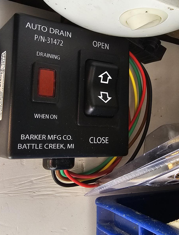

We've had the same issues with our blackwater valve cable.  Impossible to pull out and when closing the valve, it never closed completely so I always had to go back into the trailer to push on the metal stop to ensure it was well-seated.  In the last few days, we installed a Barker AutoDrain. The switch is located along the upper edge just inside the basement. We placed it there because the switch is too large for the space created when we removed the black tank handle. We also located it where we felt the risk of damage would be reduced, but we still need to be careful when stowing supplies in the basement.
image.thumb.png.d328c1c727232fb682da10cf90d7cc6d.pngBarker valve in situ

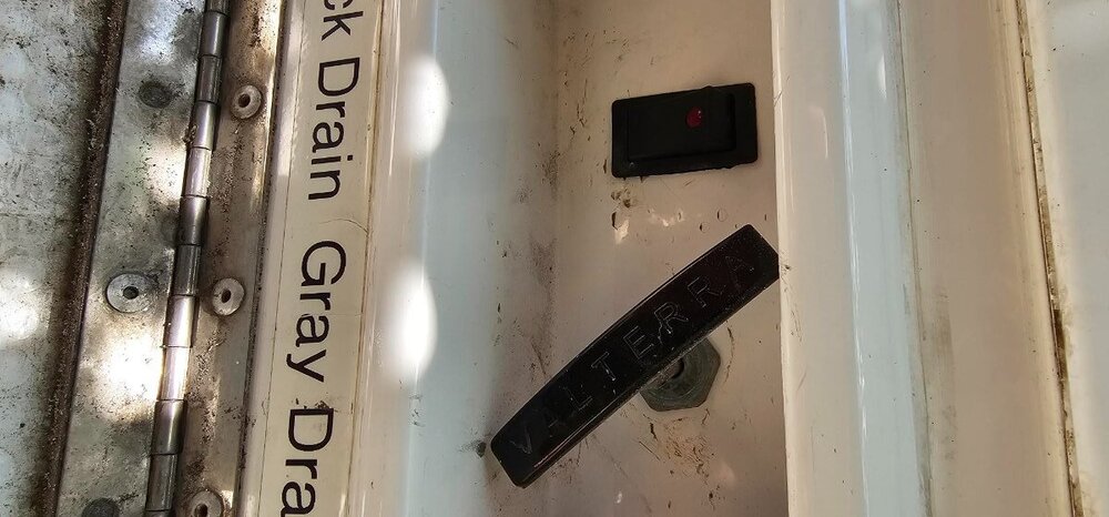

As long as we are talking black tanks, I have been perpetually annoyed when, after dumping the black tank, having to go back into the trailer to turn on the water pump so I can wash my hands.  To address this minor annoyance, I added a marine-grade, water-pump switch that is mounted where the black tank valve handle was previously located, and I can now turn the water pump on and off from outside next to the shower. No more going in and out of the trailer at the dump station to wash my hands.
Water pump drain mounted where decommissioned where the black tank valve handle was.

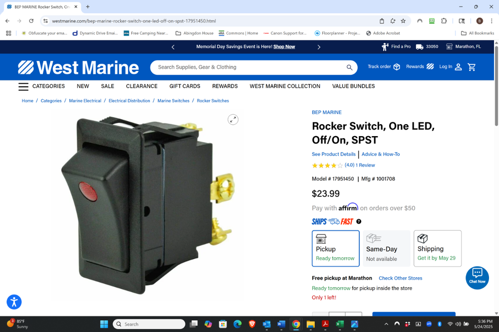

Awesome job, do you have a part# or link for this switch?
Here you go

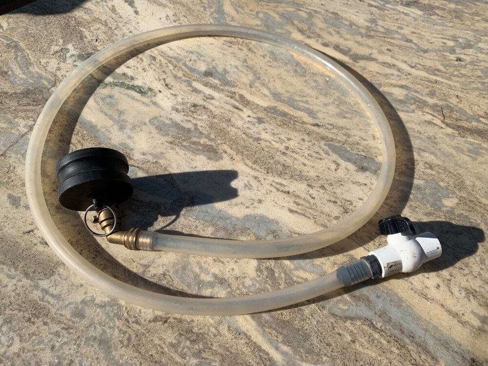

I have already ordered the cam lock waste connector and 20ft sewer hose that collapses to 6ft in length. They also sell an adapter if you need or want to use the old system. Love the built in features like 4:1 compression, see through terminal end with cutoff.
https://drainmaster.com/rv/product/waste-master-20-sewer-hose-system

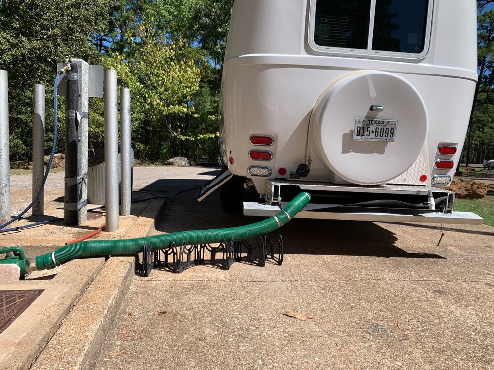

@rideadeuce do you still use the bumper sewer hose compartment with your modified bike rack?  If so, please let us know how the 20' hose fits into it and if you can leave it connected all of the time.
You seem to understand why I am so interested in this setup. It is on back order, so I believe it will be 2-3 weeks before it ships. But I will report back when I get it installed. I hope that the cam lock handles clear okay and that I don’t have to change the pipe length at all.
Ditched the bayonet style waste hose years ago, very pleased with this cam lock system. The hose keeps its shape, no snaking around when in use or while stowing away. The valve head has to be aligned at the curbside top notch of the rear opening for adequate clearance of the valve handle. Also made up a clear silicone hose with a terminal valve that cam locks onto the discharge pipe to primarily manage gray water, as needed. However, I generally keep it attached to the discharge pipe with the end valve closed; makes it easy to see if there is a valve leak from either holding tank, think no surprises!
