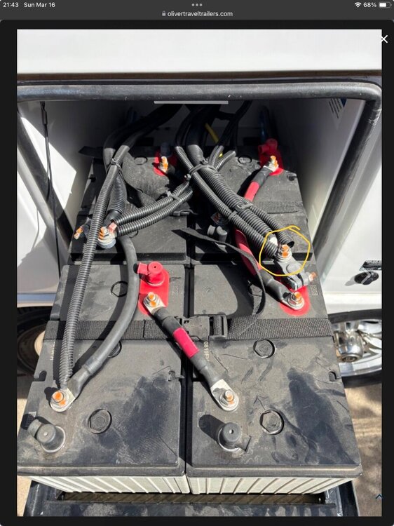

jd1923 Posted March 17, 2025 Posted March 17, 2025 3 hours ago, tallmandan said: JD’s battery set up has a simple cable configuration. I have more spaghetti in mine (photo) - guessing this is due to solar charging? Do you not have solar, @jd1923? I have solar and everything else, but when I did my installation I cleaned up the OEM installation. They had secondary 6 AWG cables from the solar charger and to the internal 12V DC system and I got them out of the battery bay and attached them to internal +/- buses. Yes, you could stack them up but you have another issue. It appears your main 4/0 cables have lead automotive post-style terminals. You will need to change these to 5/16" eyelet style lugs, something like this: https://www.amazon.com/SELTERM-Marine-Terminal-Battery-Eyelets/dp/B073FD8ZDR/ This work will require a hydraulic crimper and you would either need to do this yourself or tow your Oliver to a local trailer shop or battery store. You could likely make the two 300s work. Disconnect all the wire ties and remove everything holding the main cables down and measure how far they come towards the battery door. If you do that, I'll measure mine to verify if it would work for you. I have a 2x4s behind the batteries and another in-between and without these the batteries would be 3" closer to the inside wall. Your main cables come from the right (rear) side wall so the way I have mine should work for you. Yes, one 460AH battery, posts positioned in the rear would work but everything would be crammed in the rear and with the tray full out you would have to reach in above the battery with a wrench to connect the cables. They will not be exposed with the tray full open. The Epoch Essentials 460AH weighs 84 LBS and that was another reason I preferred the two 300s, because I could just barely lift one at a time. You got me on the trailer harness wire. Our hull does not have that crazy junction box under the bath vanity. I would look for the + bus I showed you before or disconnect it at the plug as @Derek B mentioned. Chris & John in Prescott, AZ | 2016 EII #113 | '01 Ram 2500 Cummins!

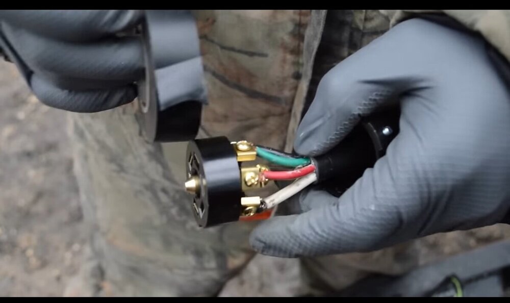

Derek B Posted March 17, 2025 Posted March 17, 2025 (edited) 4 hours ago, tallmandan said: Feeling less confident… Really appreciate the help from this group! Thx For the 7 pin 12 volt connection no need to disconnect anything under the vanity. Just disconnect the black wire from the 7 pin plug itself. Disconnect and tape the wire and tuck back into plug housing. Below is example of 7 pin plug diagram and how the plug looks when disassembled. Google replacing and rv 7 pin and should find plenty of videos showing how to pull back the plug housing. My battery compartment started out looking like yours but now looks like @jd1923. The smaller gauge wires can be brought inside the trailer by installing additional bus bars but may be more than you have in mind. For ease you can just stack multiple in same battery connections but may need longer bolts then supplied by epoch. If your 4/0 gauge connections seem short you likely have some extra length of cable of cable on inside of trailer under bed. The large 4/0 negative cable should be going directly to your inverter or a shunt if installed. If so you can pull some of the length into battery compartment by loosing the grommet in battery bay. Hope this helps. Edited March 17, 2025 by Derek B 2 Derek and Deana | 2019 LE II, Hull #484 | 2023 F150 EcoBoost | SE Louisiana
Derek B Posted March 17, 2025 Posted March 17, 2025 20 minutes ago, jd1923 said: It appears your main 4/0 cables have lead automotive post-style terminals. @tallmandan check your connection. I believe as my trailer was you have eyelet terminal connections they are just bolted to auto post style terminals due to your batteries requiring this type. 1 Derek and Deana | 2019 LE II, Hull #484 | 2023 F150 EcoBoost | SE Louisiana

jd1923 Posted March 17, 2025 Posted March 17, 2025 2 minutes ago, Derek B said: @tallmandan check your connection. I believe as my trailer was you have eyelet terminal connections they are just bolted to auto post style terminals due to your batteries requiring this type. Thanks Derek, good find! Looking closer, I believe I see three lugs below the nut. If this is what Derek had then it's likely the case. Therefore, no hydraulic crimper tool required. 1 Chris & John in Prescott, AZ | 2016 EII #113 | '01 Ram 2500 Cummins!

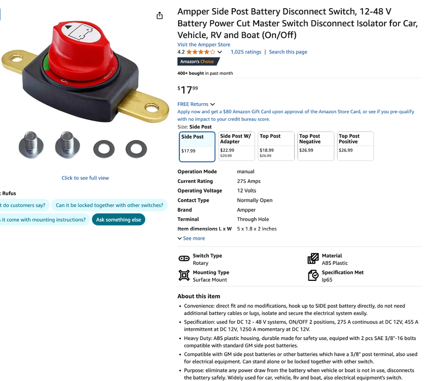

jd1923 Posted March 17, 2025 Posted March 17, 2025 (edited) 4 hours ago, tallmandan said: I'd like to use this simple disconnect switch and install it on the main negative terminal. This would give me a convenient switch for when in storage and it would also give me a bit of extension since the cable may be a bit short to reach forward in the tray. It's rated at 275 amps. OTT and most Oliver owners have gone with a Blue Sea Systems. Given you will switch the ground, I would get the black one. This ON/OFF switch is rated 300A: https://www.amazon.com/Blue-Sea-Systems-6008-Selector/dp/B00558LSJE/?th=1 Given your switch will just sit on top of the outside battery, I would tape it down to the top with some 3M VHB 4950 tape. Given you're thinking the two 300AH Epoch Essentials, your picture shows two good jumper cables that should fit like I mounted mine. One of the two shorty cables can be used to go from the negative battery post to your cut-off switch. This should add a good 6" to the main negative cable which in my installation is the furthest out. Yes, get bolts long enough, but just long enough. There is less than 3/4" of thread in the batteries. You need enough threads to hold well but not too much to bottom out the bolt where it would not hold the cables tight. Two included bolts may fit where you would have just one cable bolted down. Two should be about 1/2" longer to hold the main cable, the jumper cable and two of the thinner 6 AWG cables. The manual calls for M10 bolts (metric) torqued to 35 Nm (25 lb-ft). I used a short 13mm box-end wrench, short so not to over-do it and got each "good-n-tight" by hand. I would buy today and not wait until the last day. Remember, we're here to help. Take the plunge! Since last summer, I have been extremely happy with ours. 🤣 Edited March 17, 2025 by jd1923 1 Chris & John in Prescott, AZ | 2016 EII #113 | '01 Ram 2500 Cummins!
tallmandan Posted March 18, 2025 Author Posted March 18, 2025 9 hours ago, jd1923 said: OTT and most Oliver owners have gone with a Blue Sea Systems. Given you will switch the ground, I would get the black one. This ON/OFF switch is rated 300A: https://www.amazon.com/Blue-Sea-Systems-6008-Selector/dp/B00558LSJE/?th=1 Given your switch will just sit on top of the outside battery, I would tape it down to the top with some 3M VHB 4950 tape. Given you're thinking the two 300AH Epoch Essentials, your picture shows two good jumper cables that should fit like I mounted mine. One of the two shorty cables can be used to go from the negative battery post to your cut-off switch. This should add a good 6" to the main negative cable which in my installation is the furthest out. Yes, get bolts long enough, but just long enough. There is less than 3/4" of thread in the batteries. You need enough threads to hold well but not too much to bottom out the bolt where it would not hold the cables tight. Two included bolts may fit where you would have just one cable bolted down. Two should be about 1/2" longer to hold the main cable, the jumper cable and two of the thinner 6 AWG cables. The manual calls for M10 bolts (metric) torqued to 35 Nm (25 lb-ft). I used a short 13mm box-end wrench, short so not to over-do it and got each "good-n-tight" by hand. I would buy today and not wait until the last day. Remember, we're here to help. Take the plunge! Since last summer, I have been extremely happy with ours. 🤣 Thanks @jd1923. Really helpful. I placed my order today for the two Essential 300aH batteries. I have the Blue Seas switch ordered from Amazon. This evening I disconnected, capped and taped the black charging wire from my 7-pin lead under the bathroom vanity. Once the delivieries show up, I'll start pulling apart my AGM set up and hope things go smoothly 🙂 Thanks for taking time to think about my questions and replying with your help and advice! 4 1 2020 Elite II #627, 2021 Silverado 1500 3.0L Duramax, Colorado
