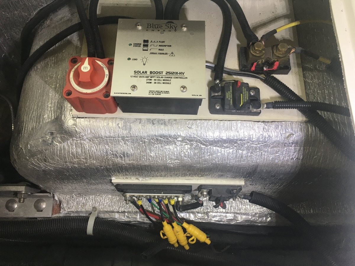

Tony and Rhonda Posted Thursday at 07:49 PM Posted Thursday at 07:49 PM We are still getting to know our Oliver now that we have a storage location close to home. We have a couple of questions about the trailer, one specific to the 2017 models and one more general. Our trailer had solar and AGM's when manufactured and was upgraded to lithium by a previous owner. I've read on the forum that the solar panels should have a disconnect switch but I can't find one. Did the 2017's have them? If so, any idea where they were located? Our general question is about the screen door. We've noticed that the screen door doesn't completely cover the door opening. The screen door is not centered in the door opening and only overlaps the fuzzy, latch side door weatherstripping by about 1/8 inch. It has rather large gaps at the bottom and at the upper radius curve on the latch side. Has anyone else run into this? If so, do you have a solution? Thanks for any comments and/or advice. Tony New to us 2017 Legacy Elite II Hull #251 (with updates) TV: 2023 Tundra Double Cab 4x4 TRD Sport (still with original engine) Formerly 2004 Tundra with 2015 Four Wheel Camper Fleet

Moderators topgun2 Posted Thursday at 08:54 PM Moderators Posted Thursday at 08:54 PM Check under the street side bed for that switch - what you're looking for is a large red switch . Bill 2 2023 Ford F150 Lariat 3.5EB FX4 Max Towing, Max Payload, 2016 Oliver Elite II - Hull #117 "Twist" Near Asheville, NC
Ray Kimsey Posted Thursday at 08:57 PM Posted Thursday at 08:57 PM 1 hour ago, Steph and Dud B said: Pretty common with these RV doors. Not sure about 2017 but 2020 did not. I added one when I upgraded my batteries. 2019 Ram 1500 5.7L V8, 3.92 axle ratio - 2020 LEll - Hull676
jd1923 Posted Thursday at 11:51 PM Posted Thursday at 11:51 PM 3 hours ago, Tony and Rhonda said: Thanks for any comments and/or advice. Like Bill @topgun2 mentioned, look under streetside bed where you should see the big red Blue Sea switch shown left in the picture. You likely have the same Blue Sky solar controller too. Our screen door has a 1/4" gap all the way around it, but it does touch the fuzzy edges and seals OK. 1 Chris & John in Prescott, AZ | 2016 EII #113 | '01 Ram 2500 Cummins!

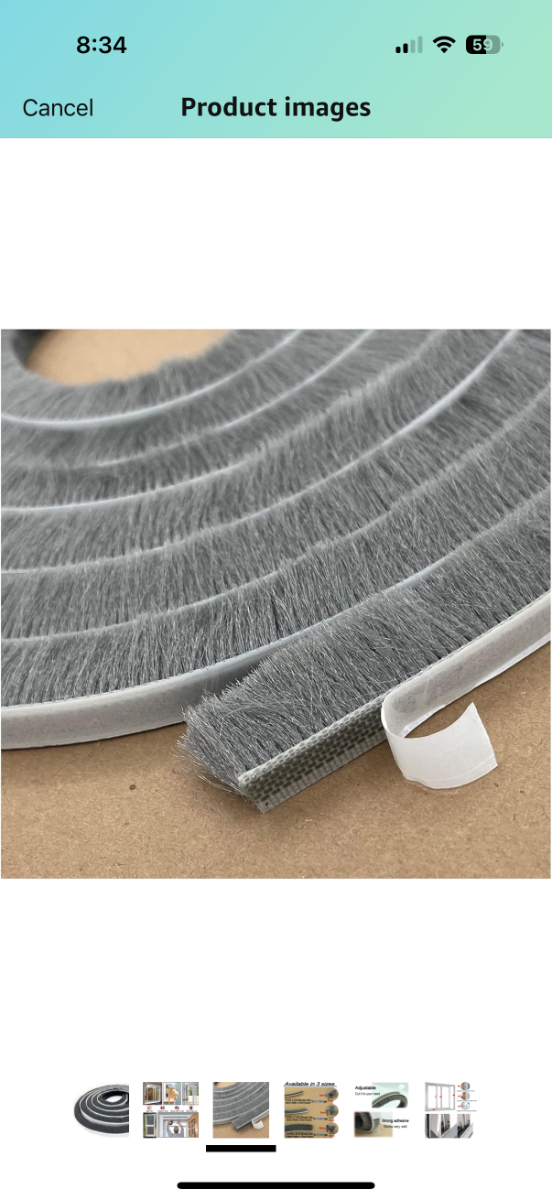

QuestionMark Posted yesterday at 01:35 AM Posted yesterday at 01:35 AM Yes, I have noticed that all the screen doors on the Oliver trailers (many different year models) do not match the curve in the fiberglass. This is what I used when going to Alaska to keep the mosquitos out. https://a.co/d/7h8kzG5 It is weather stripping (furry stuff that is on the screen door from factory). I just put some on the opposite surface where it does not meet. Worked well and still on the trailer 2 years later. 2 2020 F250 Lariat Supercrew 6.7 Diesel 4x4 2020 Oliver Legacy Elite I * Hull #664 (April 2, 2022 Incident) 2017 Oliver Legacy Elite II * Hull #293 (Purchased Used April 16, 2022) YouTube @OliverTravels293 Located SE Texas Region

Tony and Rhonda Posted yesterday at 01:57 AM Author Posted yesterday at 01:57 AM (edited) @QuestionMark Thanks for the suggestion and product link. Did you stick it to the inside of the screen door or the door jam. Or maybe on the screen door edge. I'll give this a try. Thanks again! Edited yesterday at 01:58 AM by Tony and Rhonda New to us 2017 Legacy Elite II Hull #251 (with updates) TV: 2023 Tundra Double Cab 4x4 TRD Sport (still with original engine) Formerly 2004 Tundra with 2015 Four Wheel Camper Fleet
Moderator+ ScubaRx Posted yesterday at 02:11 AM Moderator+ Posted yesterday at 02:11 AM 18 minutes ago, Tony and Rhonda said: Thanks for the responses. I've looked under the street side bed/seat and didn't see the big red switch. Don't remember seeing the Blue Sky box either. Tony Your trailer will not have a Blue Sky Solar Controller. If you have factory solar, it will have the Zamp system instead. Steve, Tali and our dog Rocky plus our beloved dogs Storm, Lucy, Maggie and Reacher (all waiting at the Rainbow Bridge) 2008 Legacy Elite I - Outlaw Oliver, Hull #026 | 2014 Legacy Elite II - Outlaw Oliver, Hull #050 | 2022 Silverado High Country 3500HD SRW Diesel 4x4
QuestionMark Posted yesterday at 02:16 AM Posted yesterday at 02:16 AM 15 minutes ago, Tony and Rhonda said: @QuestionMark Thanks for the suggestion and product link. Did you stick it to the inside of the screen door or the door jam. Or maybe on the screen door edge. I'll give this a try. Thanks again! On the screen door. I will take a photo of it next time I go out to the trailer. Also, when in Alaska we asked the locals what was the best way to get ride of the mosquitos once they get into the trailer as they are extremely hard to "get" with all the curved surfaces in our trailers. Answer we got and we have since proved it works great is "Windex spray bottle on mist. Knocks them right out of the air and it smells good at the same time". Also, helps keep the trailer all nice and shiny inside when we wipe it clean. LOL. 4 2020 F250 Lariat Supercrew 6.7 Diesel 4x4 2020 Oliver Legacy Elite I * Hull #664 (April 2, 2022 Incident) 2017 Oliver Legacy Elite II * Hull #293 (Purchased Used April 16, 2022) YouTube @OliverTravels293 Located SE Texas Region
Tony and Rhonda Posted yesterday at 12:31 PM Author Posted yesterday at 12:31 PM Thanks @jd1923 and @ScubaRx, yes our Oliver has the Zamp. I should have known that from look at the display inside the camper. I'll look for the switch under the seat again next time I go to the camper. We're working on a project at our house for the next two weeks (weather dependent) so it will be after then before I can do much with the camper. Tony 1 New to us 2017 Legacy Elite II Hull #251 (with updates) TV: 2023 Tundra Double Cab 4x4 TRD Sport (still with original engine) Formerly 2004 Tundra with 2015 Four Wheel Camper Fleet

QuestionMark Posted 1 hour ago Posted 1 hour ago (edited) Close your screen while standing inside and look at the top curve in the screen door meets the frame. Keep the actual door open as you will not be able to see the gap with the actual windowed door closed. You will clearly see a gap where the door does not meet the frame for the screen door. I think it is just a side effect of the frame being mounted to the curve surface of the trailer. I would not try to bend the screen door to match as I think it would collapse the thin door frame. Simple enough to just add the furry seal. I looked at several different year models while at the rally, including the two 2025 ones on display and the all had the same gap. Hope that helps. Edited 1 hour ago by QuestionMark 1 2020 F250 Lariat Supercrew 6.7 Diesel 4x4 2020 Oliver Legacy Elite I * Hull #664 (April 2, 2022 Incident) 2017 Oliver Legacy Elite II * Hull #293 (Purchased Used April 16, 2022) YouTube @OliverTravels293 Located SE Texas Region
