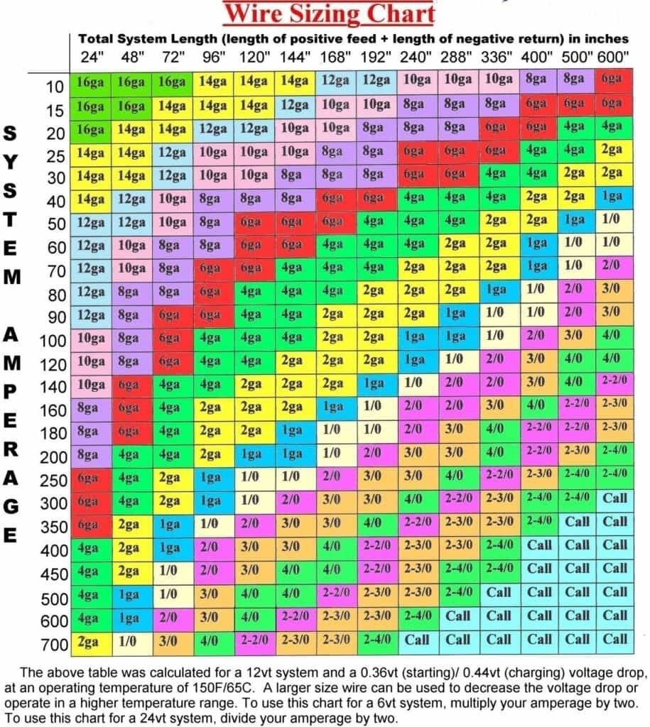

jd1923 Posted June 17 Posted June 17 12 hours ago, Geronimo John said: The Solar Disconnect (DISCO) only needs to handle the power of the solar panels. Likely 200 to 600 watts. The Battery disco needs to be able to handle 350 Amps at say 12.7V which is 4500 watts. For the main battery fuse, check your inverter spec. OTT had a 250A ANL fuse installed in our hull for the 2KW Xantrex that was our original system. When I upgraded to the Victron Multiplus II 3KVA Inverter-Charger the manual stated using a 400A fuse. Most applicable inverter specs will be in the range is 250-400A. When choosing a cut-off switch, it should be rated equal to or above the proper fuse rating. Most go with the available Blu Sea 300A or 350A rated switches. For your solar, use what is specified for the solar charger. Or if your MPPT Solar charger is rated for 30A, then a 35A or 40A breaker or fuse is appropriate. Our Blue Sky SC is rated for 25A and OTT installed a 30A breaker. When I added a Victron 30A MPPT SC, I believe the book said 35-40A and I installed a 35A breaker. So not to get shock while working with battery cables --- It is common practice when installing battery cables is to install the B+ side first since when the ground is not connected, the B+ side has no potential. When removing battery cables, use the reverse order, remove the B- side first. This is why in my battery installation, I positioned the main B- battery closest to the door. This way I can remove the ground (vs. having a switch) even without sliding the tray open and the closest B+ connection is 8" deeper into the battery bay, providing a very low chance of touching it by accident. 1 Chris & John in Prescott, AZ | 2016 EII #113 | '01 Ram 2500 Cummins!

Geronimo John Posted June 17 Posted June 17 3 hours ago, jd1923 said: For the main battery fuse, check your inverter spec. OTT had a 250A ANL fuse installed in our hull for the 2KW Xantrex that was our original system. When I upgraded to the Victron Multiplus II 3KVA Inverter-Charger the manual stated using a 400A fuse. Most applicable inverter specs will be in the range is 250-400A. Good safety tip JD. For our replacement 3,000 watt inverter I was able to reuse the OTT OEM 300 Amp for the protection of the 4/0 cables that feed the Inverter. In all three cases the fuse protects cables not attached loads. The inverters self protect if you overload them. But if your cables are too small they become a problem. Especially if your OEM cables were sized for 250 amps with a 400 amp fuse. So, in addition to checking the inverter manual for fuse size, VERIFY your cables are rated for the fuse size as well. 3 hours ago, jd1923 said: When choosing a cut-off switch, it should be rated equal to or above the proper fuse rating. Most go with the available Blu Sea 300A or 350A rated switches Ditto. I suggest that if you are installing such a safety switch, that for the minor cost difference, get the 350 amp Blue Sea switch. That way when you upgrade to the 3,000 watt inverter you don't also have to upgrade the switch too. Why? The switch must always be rated higher than the fuse protecting the wires. 3 hours ago, jd1923 said: This is why in my battery installation, I positioned the main B- battery closest to the door. This way I can remove the ground (vs. having a switch) even without sliding the tray open and the closest B+ connection is 8" deeper into the battery bay, providing a very low chance of touching it by accident. I wish that I had thought of that one two years ago! 3 hours ago, jd1923 said: So not to get shocked while working with battery cables --- It is common practice when installing battery cables is to install the B+ side first since when the ground is not connected, the B+ side has no potential. When removing battery cables, use the reverse order, remove the B- side first. Great reminder as well! GJ 1 TV: 2019 F-150 SuperCrew Lariat, 3.5L EcoBoost, 10 Speed Trans, Max Tow, FX-4, Rear Locker OLLIE: 2018 OE2 Hull 342, Twin Bed. OLLIE DIY’s: Timken Bearings, BB LiFePO4's, Victron 712 Smart, 350 Amp Master Switch, Houghton 3400, Victron Orion DC - DC, 3000-Watt Renogy Inverter, P.D. 60-amp Converter, Frig Dual Exhaust Fans, Kitchen Drawer Straps. Front Wardrobe Shelves, Snuggle Shelf. TV DIY’s: 2 5/16" Anderson System, Nitto recon’s, Firestone Rear Air Bags, Bilstein 5100’s, Mud Flaps & Weather Tech all, installed Ham Radio (WH6JPR).

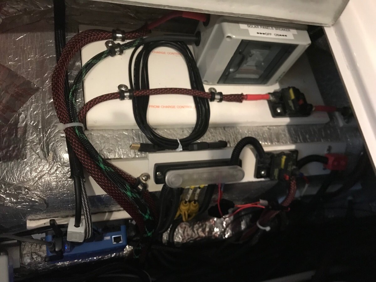

Snackchaser Posted June 17 Posted June 17 19 hours ago, jdmmtx said: Can someone please educate us on why one would choose a solar disconnect versus a battery disconnect and why you wouldn't have both? Is the solar disconnect primarily a safety feature? We do understand a battery disconnect is used to eliminate parasitic draws during periods of storage. We currently have neither in our 2019 LEII and are wondering about having one or both installed. @jdmmtx, I'll try to explain it better if I can. First of all, I didn't install my solar switch as was suggested, it was installed by Oliver during manufacturing. There were NEC and local codes that required solar switches, but i don't know where that stands now or why Oliver apparently stopped installing them. Regardless, it’s still a reasonable safety feature, because with no sun the system can test completely dead. Then surprise when the sun comes out! The solar wire is not as obvious, or as easy to find and disconnect as the battery, so a switch is a good idea and easy to install. Also, it’s nice to be able to switch off the solar to avoid low voltage warnings such as @Tony and Rhonda were experiencing when they started this thread. But I wouldn't worry a second if I did't have one! The battery is more straight forward. A switch wasn't required by code, and the manufacture didn’t install one. A switch isn’t needed for modifications because it’s best to disconnect the battery. There are few credible or realistic scenarios where a battery switch would prevent disaster. The most persuasive reason is to disconnect the parasite loads during storage as you stated. But you can do that without a battery switch as I’ve previously explained, and you won’t be inadvertently de-energizing the emergency breakaway brakes… which is a code violation. Yet there is nothing wrong with adding a main battery switch if you want to. Just don’t be coerced into it by safety concerns, and make sure you maintain “un-switched” constant power to the breakaway brakes. Also understand and consider what safety features already exist in your trailer. For example; my Lithionics BMS has short circuit protection, overcurrent shutoff, high voltage, etc.. The batteries also have power switches that disconnect power to the terminals, and there is a 300 amp breaker already in the battery circuit. Adding a battery switch would be totally redundant and completely un-necessary! Oliver and their liability insurance obviously knew that too! I hope this will help folks be better informed to make the right decision for themselves. Cheers, Geoff 1
rich.dev Posted June 17 Posted June 17 1 hour ago, Snackchaser said: First of all, I didn't install my solar switch as was suggested, it was installed by Oliver during manufacturing. There were NEC and local codes that required solar switches, but i don't know where that stands now or why Oliver apparently stopped installing them. On our 2023 we have a solar disconnect switch in the cubby above the street side bed. 2023 Elite II, Hull# 1386, Lithium Platinum Package (640AH, 400W Roof Solar, 3000W Xantrex Inverter), added 400W Renogy Solar suitcase with Victron MPPT 100/30 CC, Truma water heater & AC TV: 2024 Silverado 2500HD 6.6L 10-Speed Allison
jd1923 Posted June 17 Posted June 17 11 minutes ago, rich.dev said: On our 2023 we have a solar disconnect switch in the cubby above the street side bed. Sorry, I assumed Geoff installed his since he suggested adding the switch with installation instructions. It read to me like he had added his, my mistake. So now we see Rich has the same on a much newer hull. Who knows why OTT stopped switching the SC on hull #251 and perhaps others of that era! ? Chris & John in Prescott, AZ | 2016 EII #113 | '01 Ram 2500 Cummins!
jd1923 Posted June 17 Posted June 17 2 hours ago, Geronimo John said: the fuse protects cables not attached loads. The inverters self protect if you overload them. True, but you need to size wire AWG and the fuse rating based on load requirements. The single largest load in a 12V RV system is the inverter, given you have one. And inverters have overload protection and so do modern LiFePO4 batteries and either can fail, so we use fuses or circuit breakers. From the examples I've seen, OTT installs 4/0 battery cables whenever they install an inverter. This is more cable than you need, over-engineered. There are so many wire gauge charts but I like this one since it covers short wire lengths. Although I do not know the source of this tables, the numbers seem to make sense. When I pulled the original 4/0 cables in our hull, cleaned them up and reused them for new batteries and the larger capacity Victron inverter, I noted each cable was less than 5 ft long. Based on this table, B+ plus B- lengths of 4/0 cable adding up to 10 ft can safely carry 600A. Victron specified a 400A fuse for their product which also has a built-in safety factor. They spec'd 400A,so that is what I installed. There is another conclusion you can make from reading the data in this table. If the 250A fuse was all that was required in the 2KW Xantrex inverter that was originally installed in our hull (and others as the example pictured above), OTT could have installed 1/0 wire which can handle 250A up to 12 ft long. 1 1 Chris & John in Prescott, AZ | 2016 EII #113 | '01 Ram 2500 Cummins!

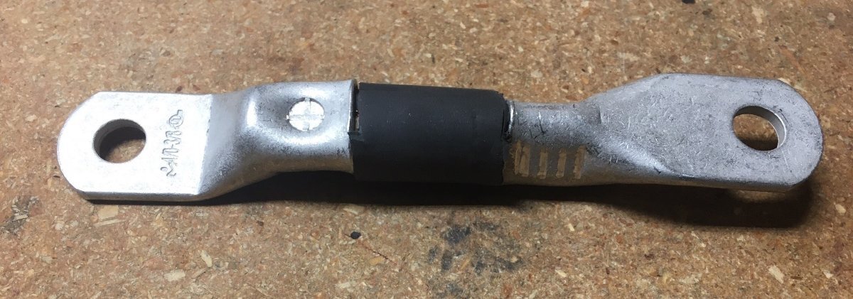

T-Oliver Posted June 19 Posted June 19 Any advice on how to bend on offset into a copper bar to connect to the disconnect switch. Also is 10mm x 25mm cu overkill vs 6mm x 25mm cu The ampacity calculations are not clear to me

Tony and Rhonda Posted June 19 Author Posted June 19 @rich.dev I watched the YouTube from Nate about installing a solar disconnect after reading the post by @mossemi above. Nate's video shows installing a double pole circuit breaker so both pos. and neg. wires are disconnected at the same time (per code). In my opinion, this would not be a very clean install for the upper cabinet. However, the two photos of disconnect switches posted here in this thread (by @Snackchaser and you @rich.dev) show BlueSea switches (assuming on the pos.) installed by Oliver. This is a clean install with no exposed wiring but may not meet code. I know you can't answer this but, if it doesn't meet code, why did Oliver install a pos. only switch??? Or no switch in our case? It seems the BlueSea switch is good enough, so that's what I'm planning to install. Also, I second @T-Oliver's question about bending copper busbars. I bought a 1/4"x1" busbar for my battery disconnect. From what I've read online, I can heat the bar almost red hot and bend it. I'm trying to find a way to make a smooth radius bend rather than clamping in a vise and whacking with a hammer. Any suggestions? But I can't work on it right now, the cat is sleeping on it. New to us 2017 Legacy Elite II Hull #251 (with updates) TV: 2023 Tundra Double Cab 4x4 TRD Sport (still with original engine) Formerly 2004 Tundra with 2015 Four Wheel Camper Fleet
rich.dev Posted June 19 Posted June 19 57 minutes ago, Tony and Rhonda said: However, the two photos of disconnect switches posted here in this thread (by @Snackchaser and you @rich.dev) show BlueSea switches (assuming on the pos.) installed by Oliver. This is a clean install with no exposed wiring but may not meet code. I know you can't answer this but, if it doesn't meet code, why did Oliver install a pos. only switch??? Or no switch in our case? Yah I'm not sure, but I have seen many other "reputable" solar installers use that red bluesea switch as a solar and battery disconnect. The Oliver double hull fibreglass is best in class quality, but as far as I'm concerned they can do better with some of the electrical (and other) components. I believe in 2023 they dumped the zamp and went with Victron charge controllers and the BMV712 which I'm a huge fan off! Next I would like to see a Victron Multiplus II inverter, Cerbo GX, and to clean up all the buss bars and fuses a Victron Energy Lynx Distributor - and yes I understand it boils down to $$. 2023 Elite II, Hull# 1386, Lithium Platinum Package (640AH, 400W Roof Solar, 3000W Xantrex Inverter), added 400W Renogy Solar suitcase with Victron MPPT 100/30 CC, Truma water heater & AC TV: 2024 Silverado 2500HD 6.6L 10-Speed Allison

Moderators mossemi Posted June 20 Moderators Posted June 20 My solar circuit breaker is installed beneath the street side bed. Mossey 2 Mike and Krunch Lutz, FL 2017 LEII #193 “the dog house”
Geronimo John Posted June 20 Posted June 20 On 6/17/2025 at 10:44 AM, rich.dev said: On our 2023 we have a solar disconnect switch in the cubby above the street side bed. Overkill, but highly effective! Hard to miss as well. Safety John Approved! LOL On 6/19/2025 at 6:36 AM, T-Oliver said: Any advice on how to bend on offset into a copper bar to connect to the disconnect switch. Several of us have used a vice, propane torch and machinist hammer. Suggest drilling the short leg hole first and make sure you have clearance over the switch and the door frame above. Mine is 1/8". I said good work. My wife said "Lucky". But then I tend to be the Clint Eastwood of this house..... GJ TV: 2019 F-150 SuperCrew Lariat, 3.5L EcoBoost, 10 Speed Trans, Max Tow, FX-4, Rear Locker OLLIE: 2018 OE2 Hull 342, Twin Bed. OLLIE DIY’s: Timken Bearings, BB LiFePO4's, Victron 712 Smart, 350 Amp Master Switch, Houghton 3400, Victron Orion DC - DC, 3000-Watt Renogy Inverter, P.D. 60-amp Converter, Frig Dual Exhaust Fans, Kitchen Drawer Straps. Front Wardrobe Shelves, Snuggle Shelf. TV DIY’s: 2 5/16" Anderson System, Nitto recon’s, Firestone Rear Air Bags, Bilstein 5100’s, Mud Flaps & Weather Tech all, installed Ham Radio (WH6JPR).

jd1923 Posted June 21 Posted June 21 (edited) On 6/19/2025 at 10:36 AM, T-Oliver said: Any advice on how to bend on offset into a copper bar to connect to the disconnect switch. Also is 10mm x 25mm cu overkill vs 6mm x 25mm cu The ampacity calculations are not clear to me 6mm by +/- 1” is certainly enough. 10mm is crazy big! (and no way your bending a 10mm bar! On 6/19/2025 at 2:47 PM, Tony and Rhonda said: From what I've read online, I can heat the bar almost red hot and bend it. I'm trying to find a way to make a smooth radius bend rather than clamping in a vise and whacking with a hammer. Yep, just clamp it in a vise and hammer it! You better have a real HD vise though. If you want to add heat OK., but it may not help unless done right. It’s just copper, so it heats and bends nicely. Take a 5 lb hammer! 🤣 Allow me to add a thought re this subject. If you really need to account for a height difference in where you bolt the lugs, I made this cable to account for adding a shunt to my batteries in a previous install. Just an idea, but you cannot purchase cables like this. You cannot even buy cables less that 1 foot off-the-shelf except maybe from Powerwerx, love this company: https://powerwerx.com/ Edited June 21 by jd1923 Chris & John in Prescott, AZ | 2016 EII #113 | '01 Ram 2500 Cummins!
T-Oliver Posted June 21 Posted June 21 I thought of that method, but I’d have to purchase lugs I’ll price it out The bussbar appealed to me, because I could over think the idea form the bar, tin the bar and then heat shrink The offset cable seems more practical 1
