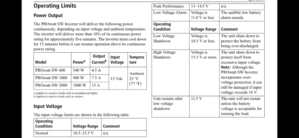

Your outlets will only work with shore power, a generator, or with an inverter turned on if you have one. More information is required. What batteries do you have
If your batteries are too low of voltage < 10.5v the 2000 watt inverter shuts down.  the inverter should alarm on low voltage or give an E01 code.
when you are in solar if the batteries drop too low the inverter will not turn on again until the batteries are charged
When we boondock we leave the inverter off unless we need 110 as it draws down the batteries just being turned on.
if you fully charge your batteries the inverter should begin working.

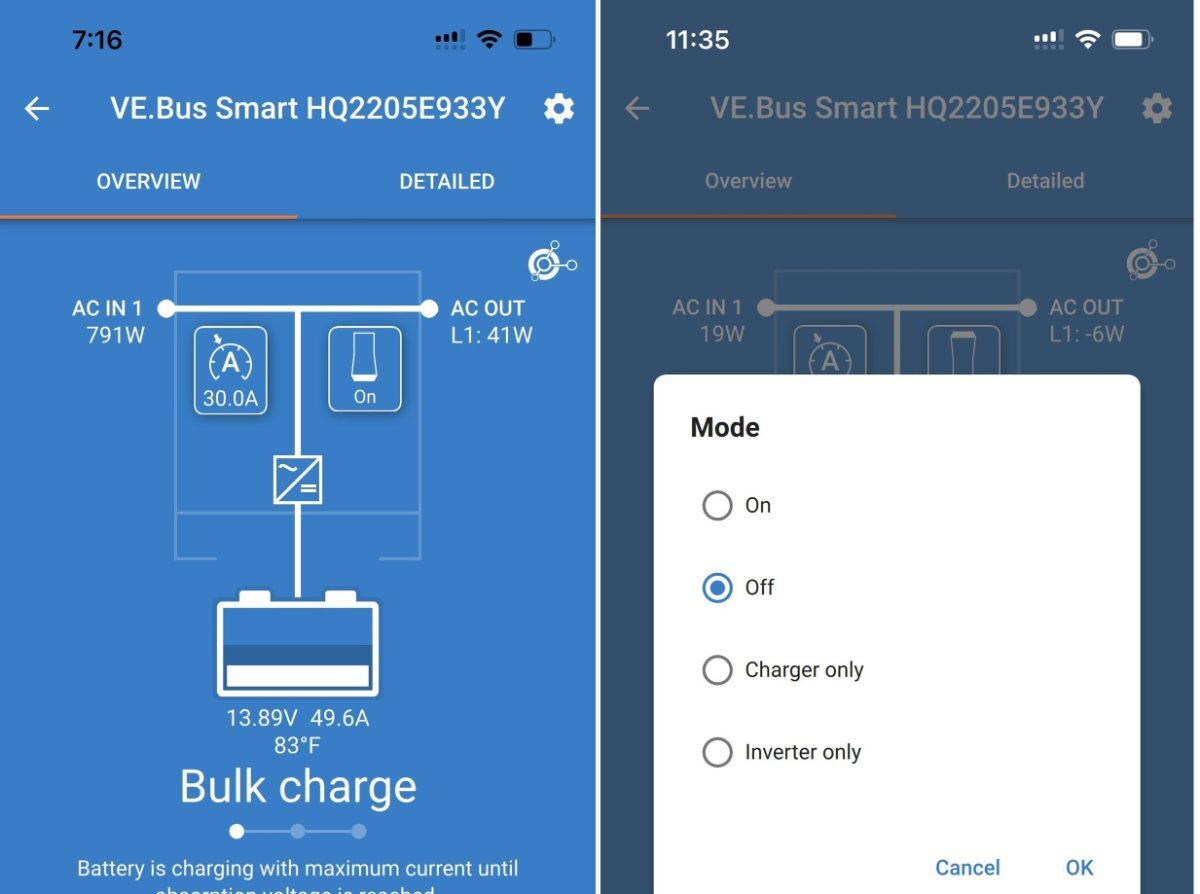

I recommend you leave your inverter off until you need to use 110, especially with AGM’s.  As mentioned above, just having your inverter on and not being used draws down battery capacity.  We rarely turn our inverter on.
2 hours ago, Trailblazers said:
I have four AGM batteries and the inverter is always turned on when using the solar.
Inverter should be off unless using microwave, outlets, or watching TV
Yes, in an OTT installed system, yet we keep our Victron system on always, 24x7x365! It’s ON now, as we sit on our deck with A/C set to 85F to keep things nice!
Solar on/off has nothing to do with 110VAC outlets working, PERIOD!
We could only guess, not knowing battery, inverter or any other particulars.
