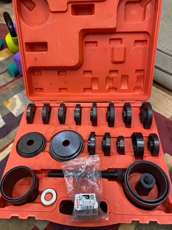

jd1923 Posted August 20, 2025 Posted August 20, 2025 (edited) The idea here is to understand what is required to service Dexter Nev-R Lube Bearings while on the road given a bearing failure. Specific knowledge, parts, and tools are required and it’s important to be ready for this issue that is likely to occur, sooner or later. Whether you are the person working the repairs or not, understanding this is equally important! Having the required bearing parts kits and the correct size bearing press tools would allow you to work this repair DIY, or at ANY local service shop, anywhere you happen to be in your travels when a bearing might fail. Without spares and tools, you’re stuck. No local repair shop will have the parts you need and very few would have the bearing press tools in the correct sizes on hand even if they have air tools and a press! Note this recent statement from an Airstream owner: “We're on a five week adventure and experienced a bearing failure that sidelined us for 5 days. I got the bearing from the local O'Reillys Parts Store...the other components I had to order from an online source. Despite all the Truck and Trailer industry in Oklahoma City, nobody had the spindle washer, nut or snap ring I needed. The bearing was easy to get and much cheaper than the Dexter option. It's the other parts that hold the hub on that can be challenging to find if you need it right now to get back on the road.” Once you remove the bearing cap with a light chisel or similar tool, this is what you will see -- Edited August 20, 2025 by jd1923 2 5 Chris & John in Prescott, AZ | 2016 EII #113 | '01 Ram 2500 Cummins!

jd1923 Posted August 20, 2025 Author Posted August 20, 2025 (edited) The bearing comes out towards the outside, towards the side where the snap-ring keeps it place, as shown in the first picture above. The first picture below shows the interior of the drum, the steel surface that the magnet grabs and on this side the opening to the wheel bearing is smaller. The bearing must be pushed through this smaller opening. In the second picture you can see the two sizes within the hub. It's a rather snug design! You need the 11# press fitting to push the bearing out. On the other end will be the 001# stay, bolted through it all. You should apply wheel bearing grease on the bolt where it will be threaded, both sides of the washers. After you pull the bearing out about 3/4" or more, when it bottoms out, you will disassemble and start over adding the 17# sleeve for additional clearance (not enough bolt length requires doing this in two steps). Then continue to crank down until the bearing releases, just pops out of the hub! I used the hand tools pictured which was doable but made the job tedious. A 1/2" impact would certainly help, so at home I used a HD pneumatic 1/2" impact to finish up. Remember, all auto shops have air tools and a 20 LB press would make butter out of pulling/pressing this bearing! This picture shows the hub of the drum now empty. You see the tools in order with the removed bearing inline. It came out nice and since it's a new part, it's going back in! 🤣 Edited August 20, 2025 by jd1923 4 Chris & John in Prescott, AZ | 2016 EII #113 | '01 Ram 2500 Cummins!
jd1923 Posted August 20, 2025 Author Posted August 20, 2025 (edited) Pushing the new bearing into the hub is much easier than pulling the old one. Apply some grease to to inside of the hub and reapply grease on the press bolt and washers. You'll need the larger 05# press on the opposite side (as pictured). I used a 1 1/4" closed-end wrench to hold the bolt on the inside and a short 2x4 under the drum to hold the wrench up in place. Edited August 20, 2025 by jd1923 3 1 Chris & John in Prescott, AZ | 2016 EII #113 | '01 Ram 2500 Cummins!

T-Oliver Posted August 20, 2025 Posted August 20, 2025 In 2017 when we purchased Hull 254 I purchased these tools You have inspired me to figure out which bits I need from the kit Any suggestions for the size of the snap ring pliers
jd1923 Posted August 20, 2025 Author Posted August 20, 2025 (edited) 4 hours ago, CRM said: In a pinch, I also wouldn't worry about re-using the snap rings, washer, or even the nut if I had to. I'd just pinch the nut slightly on the slotted end with a pair of vise grips and be on my way. Nice to see Dexter using high quality bearings in there from the factory, too. Agreed. If the bearing got badly damaged as it failed, it can cause damage to other parts but most of the time they would be reusable. I read somewhere that the spindle nut should not be reused and I do not believe pinching the nut would help any as this is hardened steel. But when asked on eTrailer, the rep replied as follows -- Does the Spindle Nut Need to be Replaced on Nev-R Lube Axles? Edited August 20, 2025 by jd1923 1 Chris & John in Prescott, AZ | 2016 EII #113 | '01 Ram 2500 Cummins!
jd1923 Posted August 20, 2025 Author Posted August 20, 2025 1 hour ago, T-Oliver said: You have inspired me to figure out which bits I need from the kit Any suggestions for the size of the snap ring pliers Your kit looks about the same. If they use different numbering, let me know and I can measure the parts and list sizes here. Re snap ring pliers, I have a full Blue Point set which is the Snap-On company value brand. You want the smallest possible since the holes in the little ring are pin-sized. Then you want the largest possible as the bearing snap-ring is large and heavy to compress. Chris & John in Prescott, AZ | 2016 EII #113 | '01 Ram 2500 Cummins!
