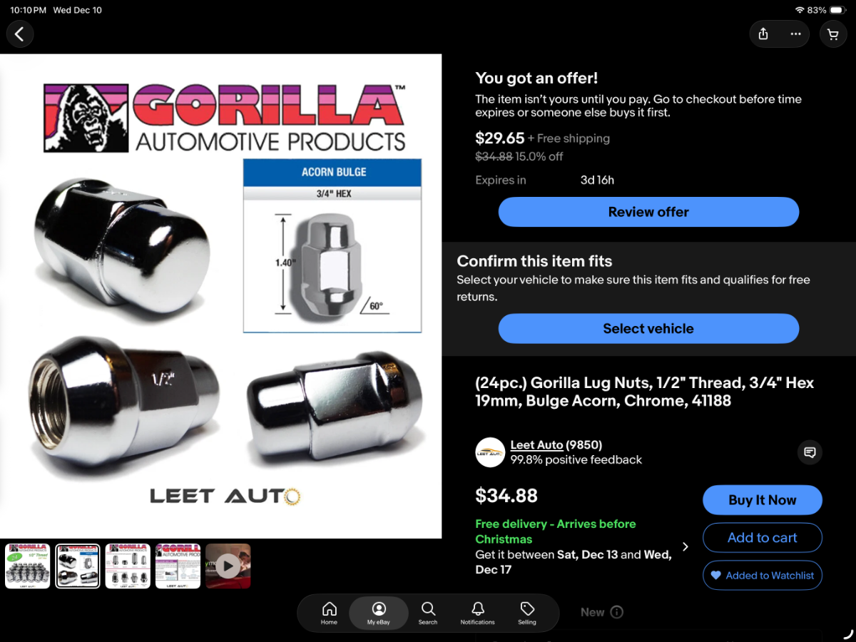

Jamie Peghiny Posted December 11, 2025 Posted December 11, 2025 On 11/24/2025 at 10:37 PM, Geronimo John said: This issue has been a long running one. Some time ago I copie Frank's post: OE2 LUG NUTS: Frank 😄 For anyone getting replacement lug nuts, make sure you get the proper type for aluminum wheels. The correct ones are the “bulge acorn” type which have a larger conical seating surface for use on aluminum wheels. Aluminum wheels are softer than steel wheels and require the larger seating surface. The ones installed by Oliver are the correct bulge acorn type so get the same style. “Acorn” type have a smaller conical face and are for steel rims. JPR: COMPARE SPECIFICATIONS! 24 required. I believe it was MaxBurner that turned me on th these chrome plated lug nuts from Summit Racing. My regular sockets work well with them and no interference with the wheel rims on our 2019. Hi, I’ve received an offer from an eBay seller for what I think are the same lug nuts referenced in these posts. I’m including a screenshot for verification. Are these the correct ones? They have the same model number 41187 but not the HTB designation. I think they are based on this thread. Thanks, Jamie Jamie and Sandi New Harbor, Pemaquid Point, Maine 2021 LEII Hull #802
Geronimo John Posted December 11, 2025 Posted December 11, 2025 (edited) Sadly I do not trust most of the items made in China that are sold on E-bay. Especially for life safety items such as lug nuts. GJ Edited December 11, 2025 by Geronimo John TV: 2019 F-150 SuperCrew Lariat, 3.5L EcoBoost, 10 Speed Trans, Max Tow, FX-4, Rear Locker OLLIE: 2018 OE2 Hull 342, Twin Bed. OLLIE DIY’s: Timken Bearings, BB LiFePO4's, Victron 712 Smart, 350 Amp Master Switch, Houghton 3400, Victron Orion DC - DC, 3000-Watt Renogy Inverter, P.D. 60-amp Converter, Frig Dual Exhaust Fans, Kitchen Drawer Straps. Front Wardrobe Shelves, Snuggle Shelf. TV DIY’s: 2 5/16" Anderson System, Nitto recon’s, Firestone Rear Air Bags, Bilstein 5100’s, Mud Flaps & Weather Tech all, installed Ham Radio (WH6JPR).
jd1923 Posted December 11, 2025 Posted December 11, 2025 If they are truly Gorilla brand or McGard (another good brand I've used) then they're good. What @Geronimo John is referring to is that there are a lot of China made knock-offs on eBay (Amazon too for that matter). Instead buy from Summit Racing or eTrailer or another reliable and authorized reseller. This eBay seller has Feedback number at 9850 and 99.8% rating, likely their parts are good, but who knows. @Jamie Peghiny I believe the lug nuts you found is the correct size and shape but cannot be certain w/o a forum signature with your hull#, etc. 1 1 Chris & John in Prescott, AZ | 2016 EII #113 | '01 Ram 2500 Cummins!
Jamie Peghiny Posted December 12, 2025 Posted December 12, 2025 @jd1923 I’ve now added my year and hull info on my forum signature. I’m new here and didn’t realize how to actually accomplish this but I figured it out. Hope this helps. Thanks for pointing this out. I vet my eBay sellers carefully for a few reasons - many sellers are simply drop shipping from Amazon and have no inventory in stock. Personally, I prefer not to buy from Amazon. On eBay, I look for actual businesses that have high feedback numbers, high feedback ratings and inventory that is consistent with their business model. I also look at their location to make sure the item is located in the US. I’ve waited weeks for items for arrive from overseas. In this particular instance, Leet Auto has a high number of feedbacks (9850), a high feedback rating (98.8%), 193 items in stock and they’re mostly Gorilla lug nuts. This narrow business model and inventory could be a red flag. They might be drop shipping, hard to tell without asking the seller that question, which I have done I do see a very high level of expertise on this forum and I will go with your recommendation to go with Summit Racing or eTrailer. I agree with @Geronimo John about safety equipment from China and it’s very difficult to find anything made in the USA. Generally, I have had very good luck buying from reputable businesses on eBay. One recent exception was a Propane/CO monitor that I purchased from RecPro. They passed all of my screening criteria but still sent me an outdated sensor which I returned and promptly received credit. I will check out this item and others on Summit Racing and eTrailer Thank you for your help, I appreciate it Jamie 5 Jamie and Sandi New Harbor, Pemaquid Point, Maine 2021 LEII Hull #802

Jamie Peghiny Posted December 12, 2025 Posted December 12, 2025 So, it’s a good thing I didn’t order those lug nuts because I specified the incorrect part number. (41188 instead of 41187). Neither Summit or eTrailer has these in stock though Amazon does. Maybe I should wait until spring so I can inspect what’s already on my Ollie and see if replacement is really needed. It’s too cold out there to mess around with it right now. Jamie 1 Jamie and Sandi New Harbor, Pemaquid Point, Maine 2021 LEII Hull #802

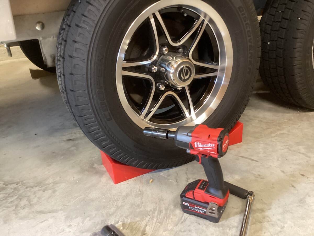

Tideline77 Posted December 14, 2025 Posted December 14, 2025 If you are considering getting a battery operated impact to carry on your travels ? These tools are expensive 🤔 but there are usually promotions and sales that you can wait for that offer steep discounts and even then they are expensive After considering one for a long time this thread kicked me over the fence and i snagged a Milwaukee 1/2” drive M18 model #2962-20 during a recent sale $189 with a 5 amp battery and a charger #2962-20 😳 $489.00 is the regular price Next I need to snag a heavy duty plug kit…….and TPMS for the Oliver You can search for sales on Search this page 3 Robert E 2022 LE II , LIthium Pro, 2018 F150 XLT 4WD 2.7 EcoBoost , 355 gears, tow package,36 gallon fuel, factory brake controller, transmission cooler

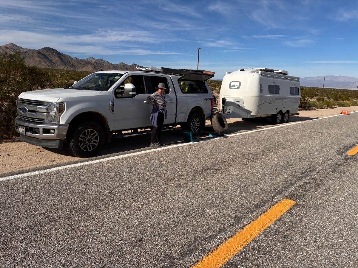

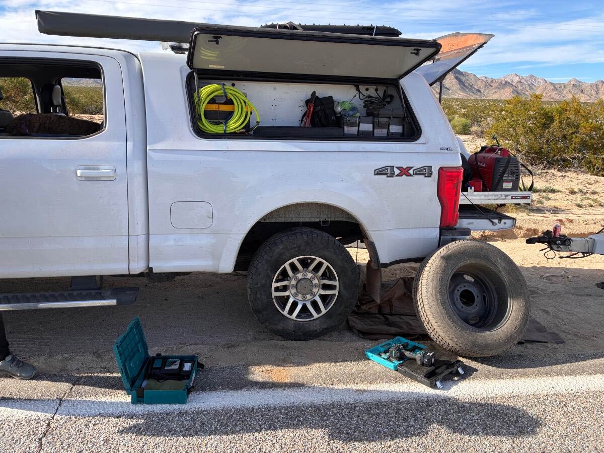

taylor.coyote Posted December 20, 2025 Posted December 20, 2025 (edited) it was our turn to change a tire in the wild. good news, we carry all the tools (impact wrench, bottle jack, impact socket set, gloves, torque wrench, on board air compressor and maybe the most important tool were my knee pads). All good, all lug nuts off, jack the wheel up for clearance and X!!!@!!, the aluminum wheels are bonded to the steel hubs, electrolysis in action). I kick, got a strap through the wheels and yak and they don't budge. I need a heavy hand sledge and a block of wood to bang the wheels loose from the inside of the wheel. The sledge is the only tool I don't carry. The good news we were not off the grid in the back country for the first time all week. Many of you may know AmBoy road that runs between Route 66 and the 29 Palms / Joshua Tree. Still remote but it didn't take gps cordanates to find us. We had to call a tow service just for a heavy hand sledge. Took about 2 minutes to knock the wheel loose... back on the road and my wife will be getting a hand sledge for Christmas. You may want to check your tool inventory for a hand sledge if you have aluminum wheels. Edited December 20, 2025 by taylor.coyote typo 5 2 2016 Legacy Elite II, Twin Beds, Hull #124 Tow Vehicle: 2019 Ford F250 4x4 / Short Bed / Crew Cab / 6.7 Diesel Fieldbrook, Ca
Rivernerd Posted December 20, 2025 Posted December 20, 2025 15 hours ago, taylor.coyote said: it was our turn to change a tire in the wild. Was the aluminum wheel bonded to the steel hub on your Oliver, even though the photo shows a tire change on your truck? Hull #1291 Central Idaho 2022 Elite II Tow Vehicle: 2026 Ford F350 Crew Cab with 7.3L gas engine
jd1923 Posted December 20, 2025 Posted December 20, 2025 (edited) 20 hours ago, taylor.coyote said: to knock the wheel loose... I think I would have lowered the jack on the wheel, lugs on just a couple threads. Then place a wheel chock on the inside rim, creating a downhill angle. Gravity/weight of the trailer should do it and lowering carefully it should do less harm than many heavy sledge hammer hits! Given your wheel seized so HARD, I’d bet all 4 wheels are in dire need of bearing and perhaps brake service! For sure this wheel had not been removed in some time. Edited December 20, 2025 by jd1923 Assuming it was an Oliver wheel. If it was the truck, rotate tires more often! 1 2 Chris & John in Prescott, AZ | 2016 EII #113 | '01 Ram 2500 Cummins!
taylor.coyote Posted December 20, 2025 Posted December 20, 2025 Sorry to mislead. Our flat was a truck tire. JD, I rotated every 5,000 miles and have serviced the brake and bearings . The wheels have seized before. I think it may have to do with my home being within 5 miles of the ocean on the north coast of California. I like your idea to drop the jack level to break the bond between the wheel and the hub. 3 2016 Legacy Elite II, Twin Beds, Hull #124 Tow Vehicle: 2019 Ford F250 4x4 / Short Bed / Crew Cab / 6.7 Diesel Fieldbrook, Ca
jd1923 Posted December 21, 2025 Posted December 21, 2025 1 hour ago, taylor.coyote said: JD, I rotated every 5,000 miles and have serviced the brake and bearings… Yeah, your humidity and ocean salt must be extreme! Perhaps an anti-seize compound would help. 1 3 Chris & John in Prescott, AZ | 2016 EII #113 | '01 Ram 2500 Cummins!
Geronimo John Posted January 3 Posted January 3 (edited) On 12/20/2025 at 1:23 PM, taylor.coyote said: I like your idea to drop the jack level to break the bond between the wheel and the hub. I like JD's idea. Loosen the lug nuts and then turn the steering wheel and gently drive forward at say a 45 degree angle a foot or two. The side thrust should break them free. Or just use some Nevr-Sieze on the rims to avoid the need for the bigger hammer or fouling the lug thread approachs. Maybe a "Better Option". GJ Edited January 3 by Geronimo John typo 1 3 TV: 2019 F-150 SuperCrew Lariat, 3.5L EcoBoost, 10 Speed Trans, Max Tow, FX-4, Rear Locker OLLIE: 2018 OE2 Hull 342, Twin Bed. OLLIE DIY’s: Timken Bearings, BB LiFePO4's, Victron 712 Smart, 350 Amp Master Switch, Houghton 3400, Victron Orion DC - DC, 3000-Watt Renogy Inverter, P.D. 60-amp Converter, Frig Dual Exhaust Fans, Kitchen Drawer Straps. Front Wardrobe Shelves, Snuggle Shelf. TV DIY’s: 2 5/16" Anderson System, Nitto recon’s, Firestone Rear Air Bags, Bilstein 5100’s, Mud Flaps & Weather Tech all, installed Ham Radio (WH6JPR).
