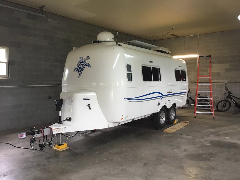

ScottyGS Posted July 17, 2018 Posted July 17, 2018 "The very best thing you can do is to store the trailer under complete cover. That minimizes all the bad things that slowly degrade your rig, plus it hides it from bad guys." A picture is worth a thousand words.... Scotty PS... yes we realize how fortunate we were to find a house with a garage like this. Nice to have our trailer under cover. Gregg & Donna Scott and Missy the Westie - The Flying Sea Turtle - 2016 Hull # 145 2024 Nissan Titan XD - Western NC
