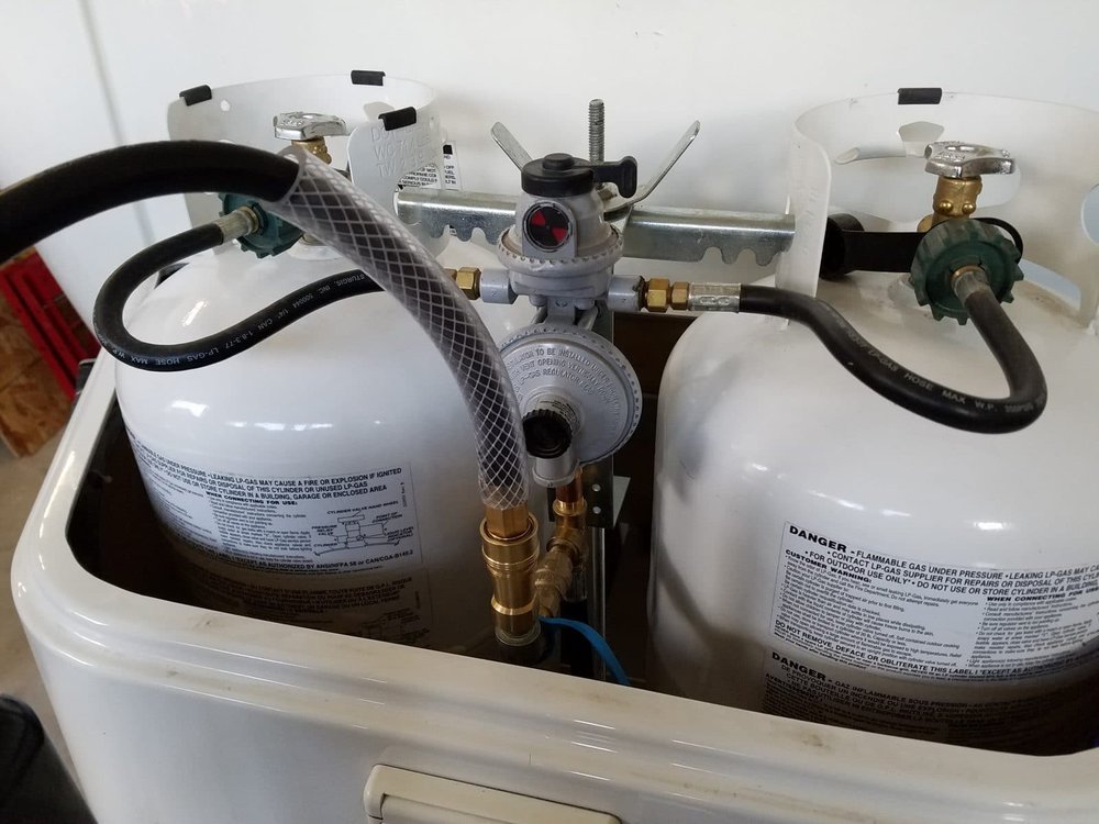

I've found that no matter how easy the new propane cover latches might be, the porthole is super easy and doesn't require lifting off that big cover to get to the valves.  I mounted a quick disconnect propane fitting inside where I can reach it through that porthole too.  Then I can run our outside stove without the moving the big cover as the hose comes out of the port.  For me, that was the best place for the quick disconnect and did not require running any pipe to another location.

Great idea about the propane quick connect at the tank. Where did you get the fittings? We thought we would pop the cover, disconnect the tank and screw on a hose to the stove. Your idea so much simpler and quicker.  We are thinking about moving the tanks as far forward as possible and putting a rectangular hatch in on the side. Would be a great place to store chocks and blocking. We saw that idea in this forum, but can't find who or where again. We will have to wait until we get our unit home to see what exactly is involved.

I'll post a picture of the quick disconnect later today.  I found a kit at an RV place with the quick disconnect  and an 8' hose with the male fitting.  I also put on a ball valve to isolate it.  I have a Harbor Freight welding table that folds up and an outdoor stove.

Canoe, I’ll post a picture of the quick disconnect later today. I found a kit at an RV place with the quick disconnect and an 8′ hose with the male fitting. I also put on a ball valve to isolate it. I have a Harbor Freight welding table that folds up and an outdoor stove.
