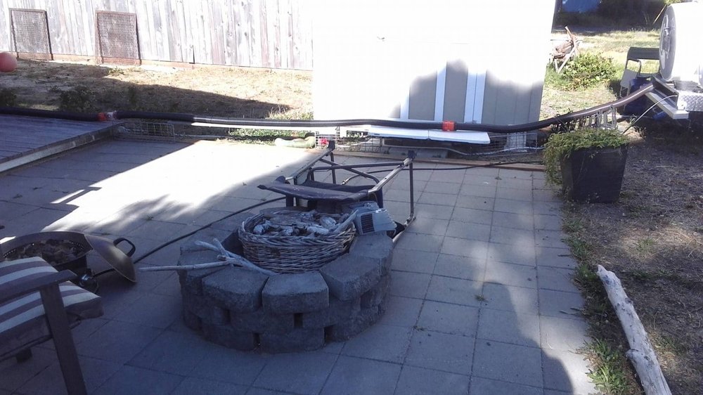

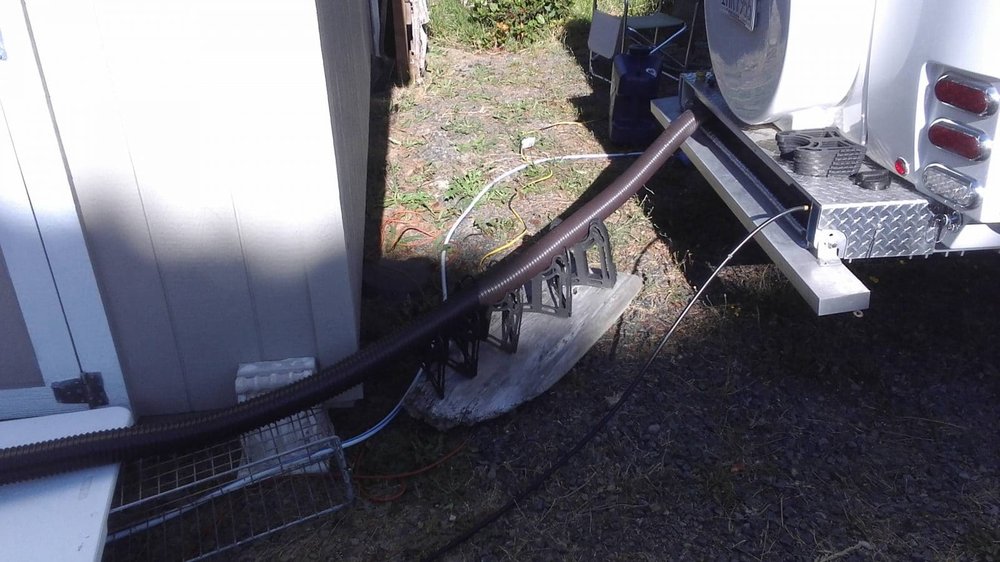

Everything from driftwood to the kitchen table is what it takes sometimes to flush the toidy :)
This is our little 35' run to her sewer clean-out. We have flower baskets, a piece of 6' dog eared fencing, the driftwood, slinky's, and even a deck involved in this fun little run. The Oliver is high enough to make almost anything possible, just add in a cozy fire pit, and it's all downhill from here :)

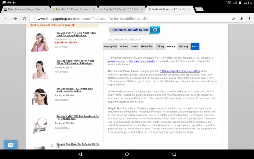

CPap machines...I thought most, at least ours, was really 12 volt. If so you could eliminate the small inverters too. Just use a 12V cord and plug it in direct?
CPap machines…I thought most, at least ours, was really 12 volt. If so you could eliminate the small inverters too. Just use a 12V cord and plug it in direct?
Tali and I both use a CPAP machine.  When we were having the Outlaw Oliver built, I had 12 volt outlets installed inside the cabinets over our twin beds. I also plumbed a fitting thru the floor of the cabinets to attach our hoses to.  I found that the commercial 12 volt cords were over $50 each and they had a proprietary plug that went into the machines.  I went to our local home health office that provides our machines and supplies and asked if they had any old non-working power supply's.  With two in hand (for free) I went home, cut the cords off, attached a 12 volt male plug and viola, free cords. We run both all night, every night with a draw of less than 4 amp hours.
It's 24vdc

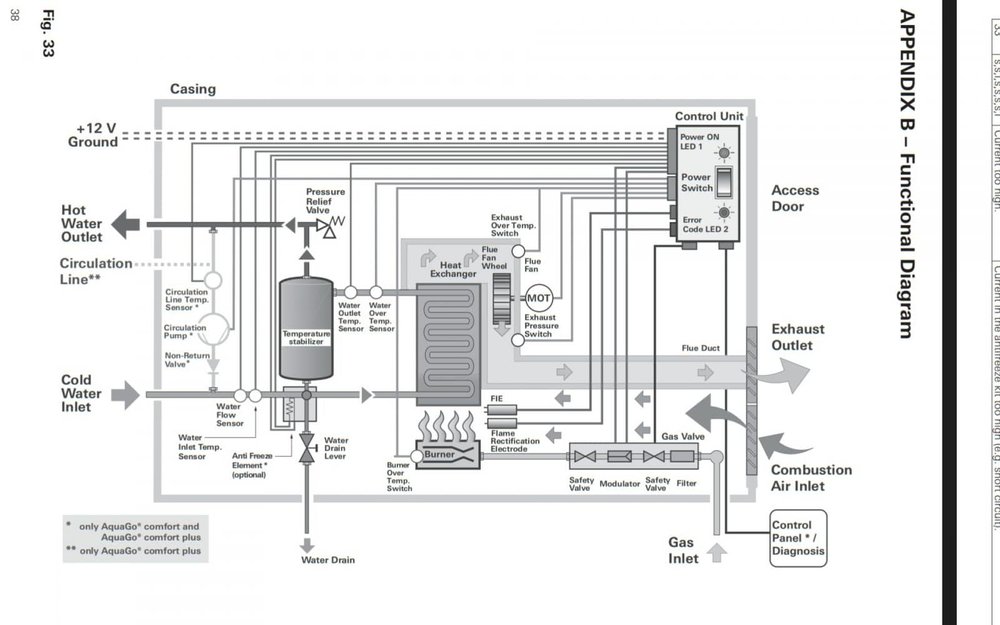

Oliver has the Truma AquaGo decalcification tablets now and Jason is sending me out a parcel today with some tablets and a new control switch. I've never had the yellow light or LED3 come on, so... now that the hot water is cooling down a bit, it's time to decalcify our water heater. We still get hot water, it just doesn't stay up at 120° when running full blast... So if the control panel light was working, it would be telling me to clean it right now... The main LED1 is green and I'm not getting any error codes on LED2, so our first cleaning is right around the corner :)
I would have already finished the movie on the sewer system if the wind would calm down, and now the next movie is almost ready to be filmed... I will completely go thru the Truma AquaGo hot water system along with the cleaning, maintenance and decalcification process in a video of its own. I will also address the 65lb maximum water pressure limit and why we need to keep our systems set to run below that. I've waited 6 months for that darn yellow light to work... lol and now I'm getting a new one. I talked with Truma Service and talked with Jason about it, and because the water heater is working fine, the LED3 is burnt out. If it was the wire or the remote panel itself, then the water heater wouldn't be working. So another quick fix is in the process :)

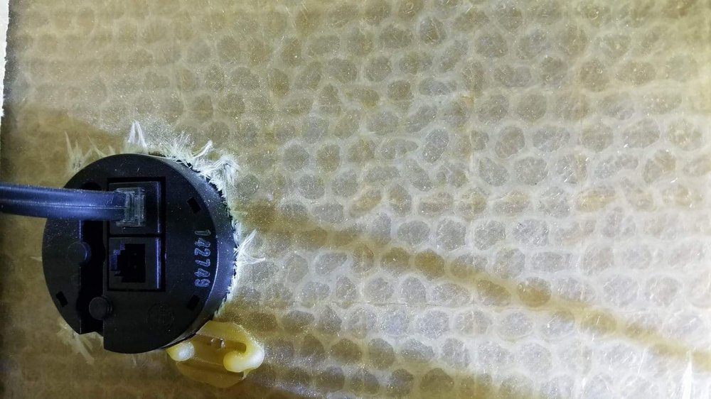

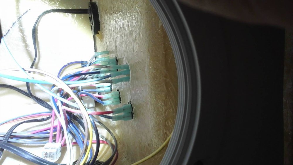

It's an easy fix with just 4 screws to pull from the front. I pulled the front panel off last night just to check it out, everything works except for the little light itself. It just runs on the power supplied from the phone cord. There's two plug sockets in the back of the switch and either of them will work. I tried both on mine and still no light, but it all functions like it's supposed to except for LED #3...

Not all CPAP are 12v unfortunately.  My current one is 24v so I use a small inverter.
