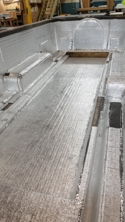

Try2Relax Posted December 4, 2017 Posted December 4, 2017 I'm not really sure, after his (hull 69) they may have just incorporated the "extra" insulation as standard, I don't really know what they look like during production. These are some of the photos from his build, does anyone else's look like this? Randy One Life Live It Enjoyably 2017 F350 6.7L SRW CC LB 2015 Oliver Elite II Hull #69
KountryKamper Posted December 5, 2017 Posted December 5, 2017 Here is what they were doing last August when we were at the plant. 2 Tom & Cheryl LE II #305 2018 GMC 2500HD SLT Duramax
