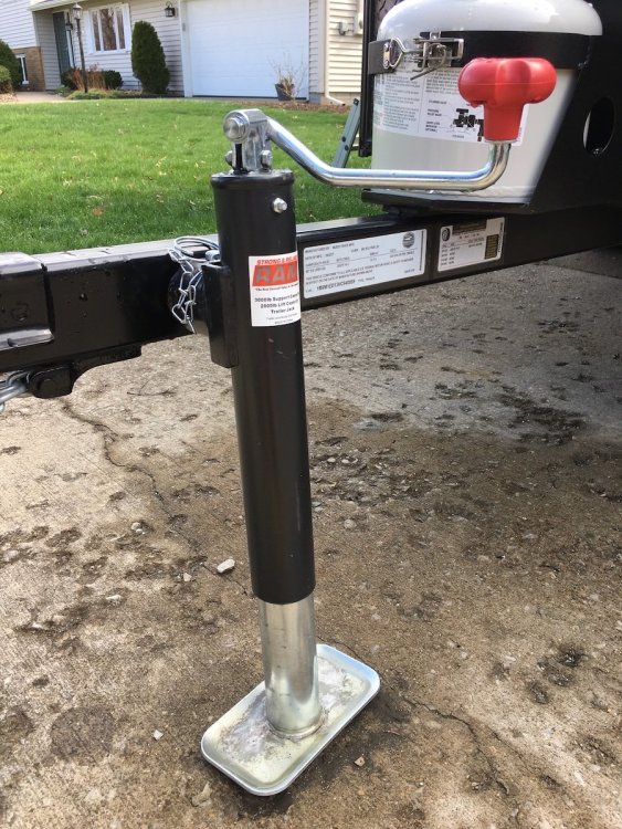

I think that I've got a drill extension that I used to use for the stabilizers on my old stick builts. If you are attending the Owner's Rally, I'll bring it along and you can have it if it works for you.
Mentioning the gap beneath the bottom bolts made me go check mine. Oliver did the install and I'd just assumed they were flush to the bottom of the tongue. They look like they do from the side, but there's actually about a ⅛" gap. I'm not sure if I''m worried about it though. It doesn't look like it wants to move, and if it does get knocked out of place that ⅛" I can always remount it. On the other hand, if I find myself standing next to some ⅛" aluminum at Home Depot I might as well grab it.
It's an interesting install underneath the trailer. For occasional use I can't see anything wrong with it, though for me using it every time we unhitch it would be too inconvenient. I've found that the springs on the two sets of pins are fairly stiff and so you might find that pulling them from that angle is difficult. But maybe if you grease them well they'll slide smoothly and not give you trouble. I wonder if an access port on the side of the propane cover would allow you to run a long extension to the crank from the outside, sort of like an old starter crank for a car.
Bill, thanks for the offer. I won't be at the rally as that is my busy time for work. The "crank" on these is not standard, the head is approx ½" long and ⅜" wide with straight sides and rounded ends, their handle is welded together with that custom socket head welded to the handle. I need to find a ratcheting crescent wrench thingy.
The new tongues are much taller, so they fit the mount better, I wouldn't feel as bad with just ⅛", whereas it supports the weight of the trailer I would have just put the bottom tight and left the gap at the top.
I don't mind lying on the ground when I deal with the handle, I only plan to use this for tight space positioning (it takes me forever to get it turned around in my driveway with the truck) and getting down there gives me the opportunity to keep an eye on things.

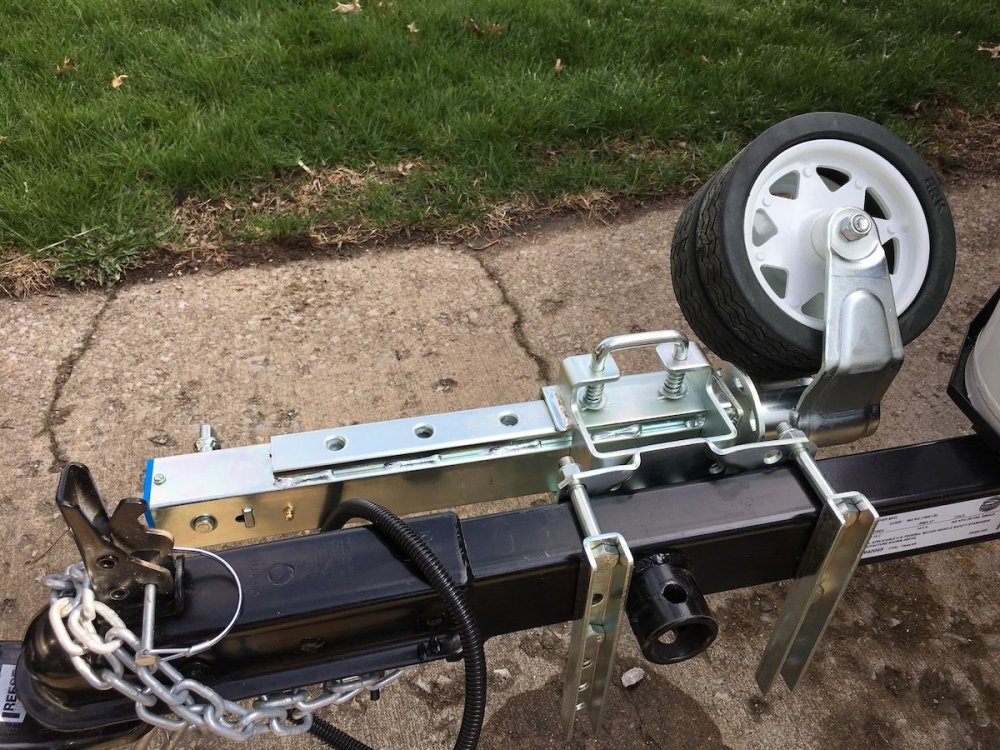

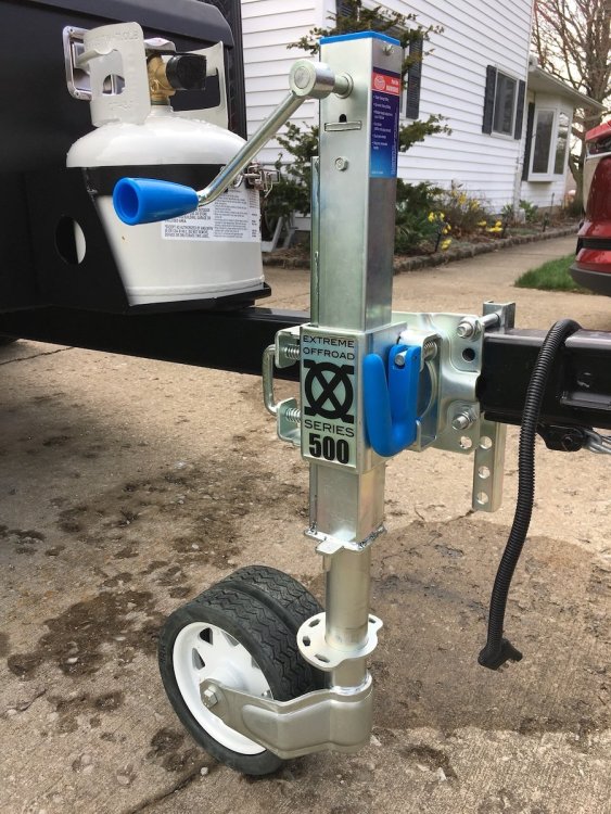

The XO has been received and mostly installed. There is no room on the old frame, in the outside area, which was fine as I planned to install it out of the way anyways. This thing is seriously robust and will add some tongue weight. The only real drawback to this location is the extension crank handle won’t work, the mechanism is smoooth enough working though that I can turn it with my fingers at this point
That is a very cool installation. OTH I have some serious reservations about the location, since the jack will be dead center in the blast of spray and gravel coming off the tires of your TV. How do you intend it keep it functioning smoothly and not get totally blasted and corroded?
I do have to say that a Stone Stomper would provide excellent protection, but getting access to the jack would be time consuming and a little frustrating at certain times.

I'm deciding between the tube mount vs the trailer jack. Any ideas?
Hiker Trailer uses a tube mount for their standard jack, and that's what was originally on mine. When I installed my ARK, there wasn't a tube version available, so I straddled the tube with the clamp version.
Hiker now offers the ARK as an option using the tube version, so I've physically seen both in use. There seems to be a lot of slop in the tube to mound fit and in the cross-pin fit, resulting in a substantial amount of movement. One that I saw at the annual Hiker gathering had the jack tilted back 3-5° from vertical. There's also slop in the lateral direction. In hindsight, I'm glad that there wasn't a tube version when I got mine, because I don't think I'd be nearly as pleased with it as I have ben for six years.
So my two cents would be to go with the clamp on version.
Steve - Northern Ohio, USA
Facebook - Instagram
Clamp on it is! Thanks 🙂
