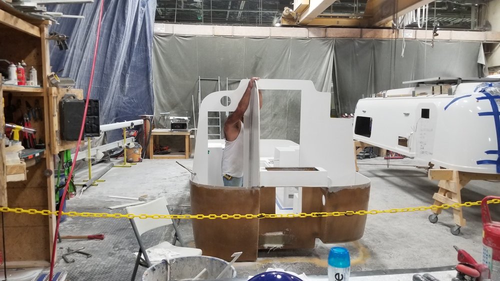

You also have to be careful when drilling on the bath walls that abut the main cabin and the closet. Those walls are really thin and you could drill through if you aren’t careful.
Tell me more about these walls. How thick is the fiberglass and how much space is there between the walls? I can remove a screw somewhere and use a wire to measure the spacing but what have you seen on your Oliver?

That would surprise me, if Oliver used plywood anywhere, especially in a bathroom wall where moisture would be present, I would expect it to be the honeycomb layer they employ in other areas that require extra support, I hope.

They do use wood on the bath wall and the wall dividing the closet and bath. They showed it to me during our tour and said its the only wood in the camper. They said they do it because people want to be able to hang stuff on that wall. In ours I can see the wood inside the closet looking up at the speaker cutout. Here is a picture of that wall being set in place.
