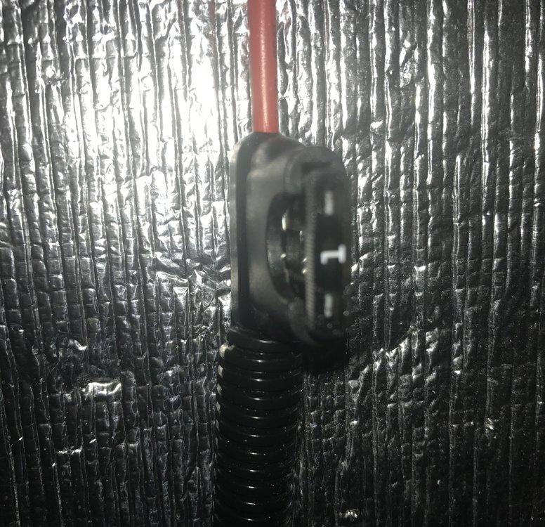

Mainiac Posted July 8, 2018 Share Posted July 8, 2018 Was looking at my fuse panel to make sure I knew what size fuses to get for spares. (I did noticed the factory had put an undersized fuse on one circuit). That is when I noticed the CO/LP monitor was off. How long it has been off is unknown. I looked around and could find no obvious source of power. I looked in the owners manual and the wiring diagram states: Note not to scale, but colors are accurate. That appears not to be true. The diagram says the wires are blue, but they are red.? A call to Oliver parts and Service connected me with Jason. He said under the back street side bed, in the electrical area (the one next to the pantry) there is a circuit breaker. The breaker has a red button. When you push the button a yellow 'flag' opens up. Under that, on a red wire, is an inline spade fuse holder. That holder has a 1 amp fuse. My fuse was blown. In my area, no one carries a 1 amp spade fuse. We went to 6 different auto parts dealers. We had them order for us and 4 only cost $2.50. To have them could be a life saver. I have no idea why such a small device would ever blow a fuse. It is definitely something we will keep an eye on, and test quite regularly. An interesting circuit breaker, and really the only time I have had to get into that compartment. It was surprisingly clean, hardly any fiberglass dust, or dust of any kind. Link to comment Share on other sites More sharing options...

Mainiac Posted July 12, 2018 Author Share Posted July 12, 2018 You would almost think with a fuse panel next to the monitor that is where the fuse should be? Also the wiring diagram in the owners manuals should have the correct color code for the wire? But the important thing is to find a 1 amp fuse before you need one. Hate to put a larger fuse in there and have it never blow., and maybe it would scream at you, and the campground, from 3 to 5 AM. Have you tried pulling that fuse? It was one of the most difficult fuses to pull because of a non ridged holder. A heads up to find before you need to makes sense... Link to comment Share on other sites More sharing options...

Townesw Posted July 12, 2018 Share Posted July 12, 2018 In the back attic Under the dinette Jack fuses under street side bunk. Also one more of these below the front jack. Also under street side bunk, CO /LP detector 1 amp fuse 5 Bill and Martha 2018 LEII Hull 313 Original owners 3/14/2018 2019 Chevrolet 2500HD Duramax Link to comment Share on other sites More sharing options...
