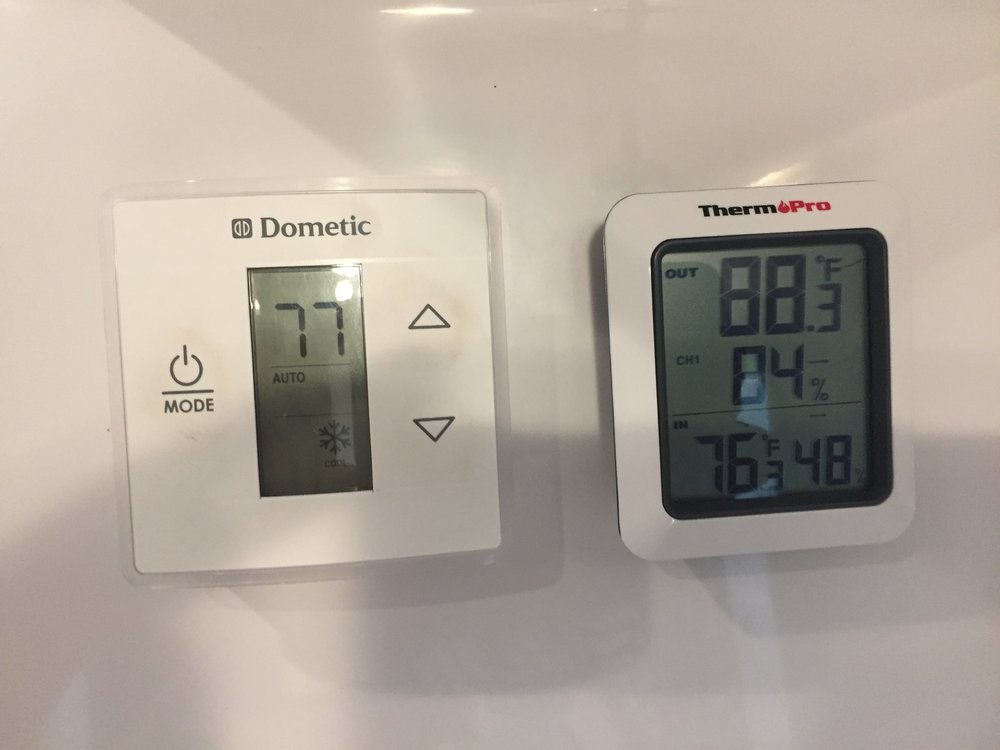

To say its Hot in Florida this summer is an understatement. Add to that the humidity and you don't want to be outside.  But just how hot is it?  I wanted an outside remote thermometer for our Oliver just so I would know what I was walking into.  Found an inexpensive one at Amazon with good reviews from - ThermoPro TP60 $18.00. http://a.co/dVuRtBu  Took only a few minutes to setup and it came with batteries.
I used heavy duty Velcro on both the backs of the remote and the display.  Placed the remote unit under the solar panels on the wiring hub and the display unit next to the AC thermostat.
Now I know. Oh look, its only 88 degree outside with 84% humidity... at 8am.

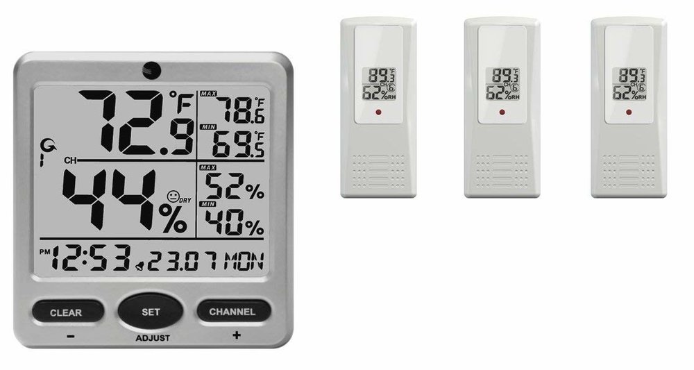

Just today I installed this one in the OOII.  It has 8 sensors and I put them all over the place.
1-Outside under the propane cover (I've had another one there for years and it has worked out fine)
2-Inside the fridge
3-On the water heater tank and covered with styrofoam insulation.  I intend for this to tell me how hot the water is so I don't run the water heater excessively.
4-In the Bathroom, up high on the wall just right of the door.
5-Inside the Upper rear Cabinet.
6-In the rear basement by the incoming water plumbing.
7-In the front basement under the dinette by the black valve.
8-TBD, I may put it by the water pump or I may install it inside the cabin.  There's already two other thermometers inside, one in a digital clock and one inside the remote for the Maxxfan so I really don't know what I'll do with the last one.
All these wireless sensors provide temp, humidity, and heat index to a common monitor. I stuck them all up with command strips.  This unit is also available with three and five sensors if you're not as big a believer in overkill as I am!

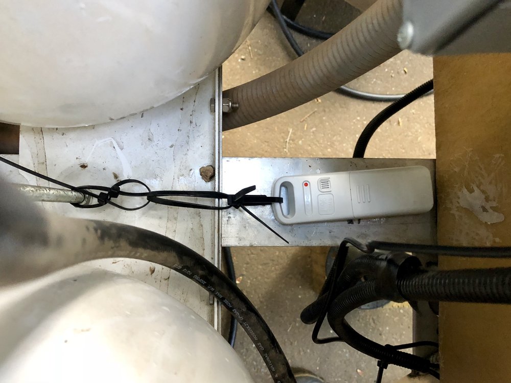

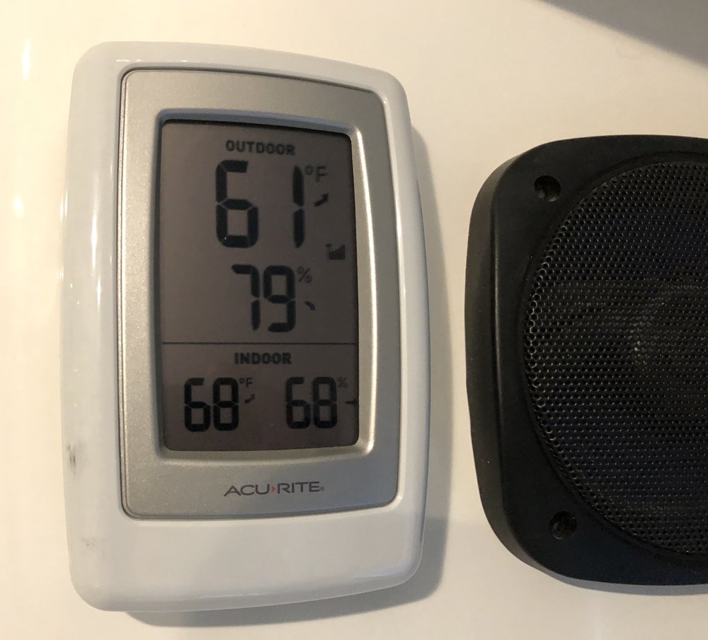

I got the Accurite wireless thermometer and humidity sensor. I put the remote unit on a metal cross bar under the propane cover.
I used exterior double stick tape to attach the remote unit to the metal bar. I was unnecessarily worried that the double stick tape would not hold, so I used cable ties to attach it to the vertical threaded post that hold the propane regulator. Belt and suspenders, I guess.
