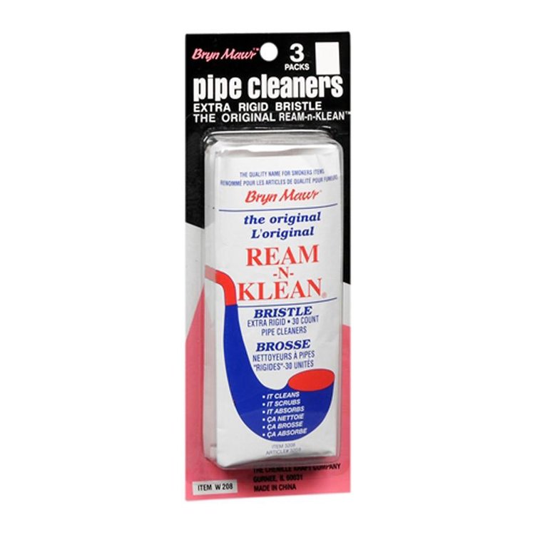

Moderators mossemi Posted June 8, 2019 Moderators Posted June 8, 2019 This is the pipe cleaner that I use because my father-in-law smoked a pipe and Krunch found them in her mother's sewing machine cabinet, so they were cheap. As others have posted, there is a variety of products that will wick water from the window tracks through the weep slots and I am sure there are others items we haven’t thought of yet. But I will say that although the Ream-N-Klein pipe cleaners do rust after months of use, their ability to stay in place while on the road at highway speeds is amazing. We put new cleaners in place for our trip to the rally and when we got home after 2100 miles, they were all still in place. They have been so dependable that we don’t even think about them anymore. You can test the effectiveness of any wicking product whenever you wash your Ollie. Good luck and happy wicking, Mike and Krunch Lutz, FL 2017 LEII #193 “the dog house”
