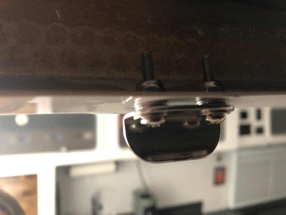

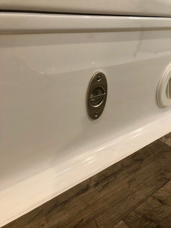

Overland Posted July 28, 2019 Share Posted July 28, 2019 Both the nightstand drawer and upper cabinets now come with locking latches as standard - same as on the pantry and closet doors. Those were both requests of ours during construction, though we changed our minds on the upper cabinets before delivery - we felt like the locking hinges were too much trouble for something that we would use as often as the upper cabinets. After seeing them on the new trailers, I'm glad we kept the thumb latches. For owners of the upper cabinets with the thumb latches, there's a simple mod you can make that will make them perfectly secure and tight - just place a few washers under the latch. I believe that you have to buy longer bolts to make them work, and while you're at it, some nyloc nuts will keep them from vibrating loose. I want to say that it was Reed who came up with that solution, and it makes those latches feel 10x more solid and once done, the cabinets will never come open on their own, even on the roughest roads. Our solution for the kitchen drawers coming open is a simple bungee across them. I had installed a towel bar at the top already (Ikea refrigerator handle), so it was an easy job to add something below to hook to. I chose some recessed anchor points from Sea Dog, and they work great. I had asked Oliver about the push button latches, but we couldn't figure out how to make them work with their drawers. Those would have been nice, but honestly I think these bungees are less trouble. We've made several small modifications like these, along with judiciously tieing down plumbing and wiring, and today we have no worries whatsoever when heading onto a bumpy road. 1 Link to comment Share on other sites More sharing options...
