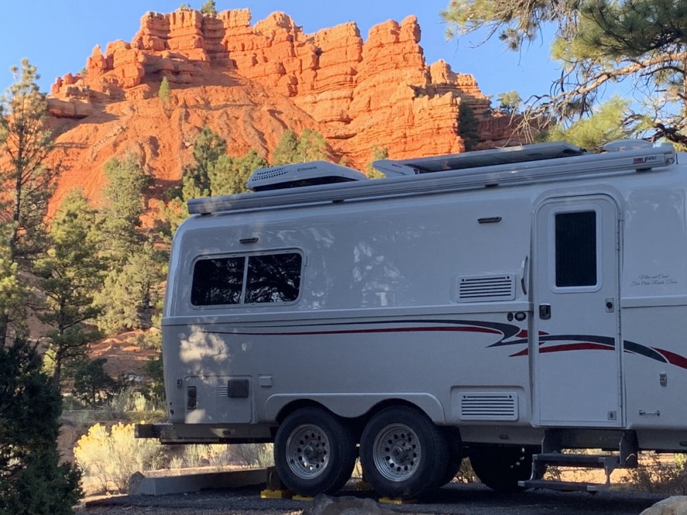

Moderators Mike and Carol Posted January 4, 2020 Moderators Posted January 4, 2020 2 hours ago, John E Davies said: I pulled mine off as soon as I got the trailer home. I was pissed to see that the Oliver tech that installed it used a fine blue permanent ink pen to draw a loooooong guide line ..... the mark would not come off. Other than that, no regrets at all, except for more water running down the side. But I rarely camp where it rains a lot, and I now have a roll of plastic rain gutter material to install over the windows and door, for when it does. https://smile.amazon.com/dp/B00LE0CC24/?coliid=I2LEYPDLJNZQD4&colid=305M5TXY22I7S&psc=1&ref_=lv_ov_lig_dp_it John Davies Spokane WA I installed this around all my windows before our fall trip north. You can see it around the back window in this photo. Texas Hill Country | 2016 Elite II #135 | 2020 Ram 2500 6.7L Cummins

Patriot Posted February 4, 2020 Posted February 4, 2020 (edited) On 1/4/2020 at 2:30 PM, Mike and Carol said: I installed this around all my windows before our fall trip north. You can see it around the back window in this photo. Mike, Are you happy with how this gutter strip around your windows performed? It looks great. I am thinking about ordering a roll of this for the Ollie we have on order. Lots of positive reviews. Thanks in advance, David Edited February 4, 2020 by Patriot 2020 OLEII - Hull #634 aka- “XPLOR” TV 2021 F350 6.7 liter Diesel Lariat Ultimate Tremor aka - “Beast of Burden” Retro upgrades - Truma Aventa 13.5 AC, Alcan 5 leaf pack, Alcan HD shackles & HD wet bolts, 5200lb never lube axles. XPEL 10 mil PPF front both front corners, 30 lb LP tanks, Sea Biscuit Front Cargo Storage box. North Carolina
Moderators Mike and Carol Posted February 4, 2020 Moderators Posted February 4, 2020 7 hours ago, Patriot said: Mike, Are you happy with how this gutter strip around your windows performed? It looks great. I am thinking about ordering a roll of this for the Ollie we have on order. Lots of positive reviews. Thanks in advance, David David, I’m very happy with it. Recommend applying it it warm or hot weather. It comes in a roll and wants to stay in a roll. I opened and laid it out for several days to start the straightening process. If I recall there are a couple of installation threads. Mike 1 Texas Hill Country | 2016 Elite II #135 | 2020 Ram 2500 6.7L Cummins

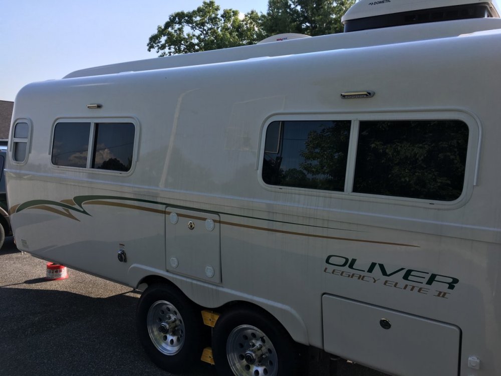

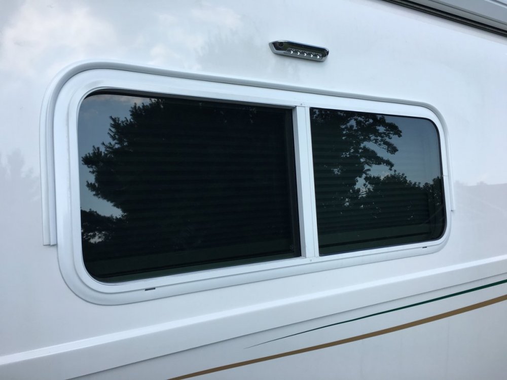

Frank C Posted February 4, 2020 Posted February 4, 2020 (edited) I installed the gutter molding as well. It helps in light rains and also keeps morning dew condensation from running from the hull down the windows. And I figure it will also help cut down on the chance of water leaks around the window frame. Definitely install it on a hot day. I unrolled the molding and let it sit on my deck in the hot sun for a few hours to get it straightened out before installing. Clean and prep the Oliver fiberglass surface with iso-propyl alcohol first (here at work we refer to iso-propyl alcohol as IPA in a lot of our documentation, and it causes confusion with the beer drinkers 🙂). As you can see from the pictures, I ran mine farther down both sides of the windows since I had heard from some owners of problems with the molding lifting loose around the corner bend if it was cut too short on the sides. I needed 4 of the 10' rolls to do it this way though on all the windows. And yes, I did clean, polish and wax the Ollie after this photo to get rid of those ugly black streaks under the windows that always seem to show up on our beautiful white trailers. And if you do order the molding, make sure you get the "Polar White" color to match the Ollie white. I ordered mine from Amazon. Esssentials UW01004 Polar White 10' EZE RV Gutter Edited February 4, 2020 by FrankC 2
Moderators topgun2 Posted February 4, 2020 Moderators Posted February 4, 2020 I'm one of the ones that suggested extending the EZ Gutter down the sides of the windows. There is noting wrong with what FrankC did but probably half way down the sides would more than do the trick. On the other hand - if any of the gutter lifts, the easy fix is to use a product called "E-6000"to re-stick it. Bill 1 2023 Ford F150 Lariat 3.5EB FX4 Max Towing, Max Payload, 2016 Oliver Elite II - Hull #117 "Twist" Near Asheville, NC
Frank C Posted February 4, 2020 Posted February 4, 2020 4 minutes ago, topgun2 said: I'm one of the ones that suggested extending the EZ Gutter down the sides of the windows. There is noting wrong with what FrankC did but probably half way down the sides would more than do the trick. On the other hand - if any of the gutter lifts, the easy fix is to use a product called "E-6000"to re-stick it. Bill My OCD compelled me to run the molding all the way down to the tangent point of the lower curve of the frame. 🙂 1 1
Overland Posted February 4, 2020 Posted February 4, 2020 I don't know - looks like you're a quarter inch short to my eye. May need to redo them. 7
