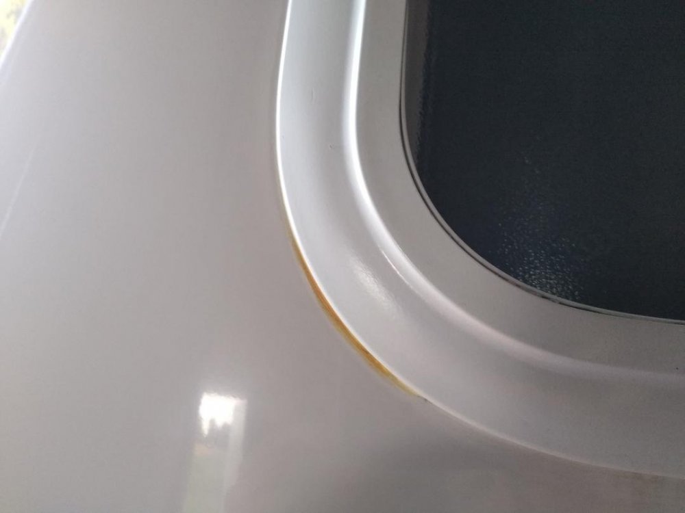

dbp05ret Posted August 17, 2020 Share Posted August 17, 2020 The sealant around my windows are turning yellow. The Oliver Elite II Hull 412 was delivered December 2018, The rear window is the worse. The RV is kept stored inside my building when not being used. Attached is picture of rear window. Link to comment Share on other sites More sharing options...
Landrover Posted August 17, 2020 Share Posted August 17, 2020 (edited) 29 minutes ago, dbp05ret said: The sealant around my windows are turning yellow. The Oliver Elite II Hull 412 was delivered December 2018, The rear window is the worse. The RV is kept stored inside my building when not being used. Attached is picture of rear window. Strange only in one area not all the way down looks like rust in the photo maybe something going on behind the frame I have hull 484 parked inside I had some black mold spots while outside Florida humidity, while the garage was being built nothing like yours. Is your garage metal or wood? condensation drip from ceiling? Just guessing, Edited August 17, 2020 by Landrover Grant 2022 GMC Denali 2500 HD 2019 Elite 11😎 Link to comment Share on other sites More sharing options...

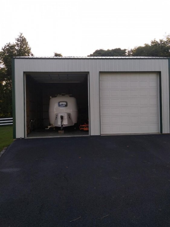

dbp05ret Posted August 17, 2020 Share Posted August 17, 2020 It is metal. No condensation to speak of. We go to Florida for 6 weeks in February and March so I can't speak of condensation during those months . I think the close up photo makes it looks worse then what it appears. I have an appointment at the mother ship at the end of September. I told them about the yellow today. Pictures below are bathroom window and building. Link to comment Share on other sites More sharing options...
Overland Posted August 18, 2020 Author Share Posted August 18, 2020 That seems to look very similar to the discoloration I had. Link to comment Share on other sites More sharing options...
