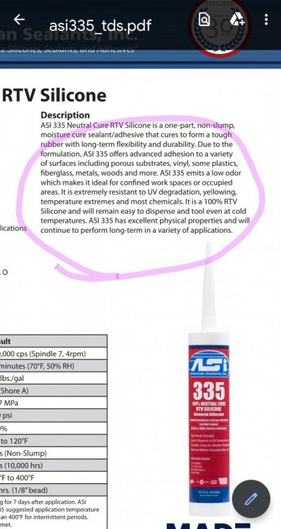

FYI, This is what someone on fb posted as current sealant used by Oliver, who had spoken to Richie.
https://www.americansealantsinc.com/asi-335-neutral-cure-silicone-sealantadhesive/

Specs don't say it bonds to fiberglass.  Is that a problem?

Not in the general description but if you download the data sheet, it is recommended for fiberglass.

Not sure, but I think this thread implies that the ASI 335 sealant yellows?  If so, what sealant (that does not yellow) is recommended
