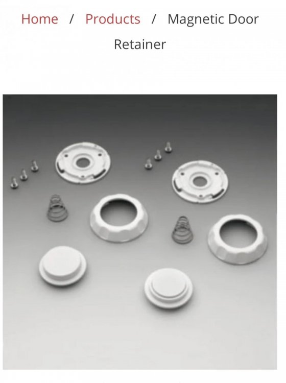

I looked into the Foli door catch. It's marketed in the UK as an exterior door catch, for a number of different brands which I'm not familiar with. (Like Luna)
Couldn't find a pound rating on the Foli magnet, anywhere. But, if it's for an exterior door, it's likely too strong for the bathroom door. In white, it's unobtrusive, but there are two things I don't like as an exterior catch.
 It's plastic, which may yellow, or become brittle here in the Florida sun.. The second is the tiny springs inside that are supposed to adjust for curve. Anything but 316 stainless is liable to rust and die here in Florida,  concealed, or not. And there was no mention of stainless in the verbage, anywhere.
I'd go with the Sealux catch Overland uses inside if I were going to replace the hook and latch. It has a 9 pound + rating, and most of us wouldn't leave the door open in winds high enough to drive that open. It's marketed to the marine community,  where most of us use mechanical latches and stops.
I usually prefer Seadog fittings. However,  their magnetic catch has a higher pound rating, but uses 304 stainless.
Photo attached to see the springs on the Foli catch.

I didn’t notice the difference in the two pucks when I was looking at the Froli website, but looking at the picture you attached it’s pretty obvious.  So now I assume that one puck is the magnet and the other is passive.  If this is in fact the case, they definitely wouldn’t work on the entrance door without some additional mounting hardware.  And you are absolutely right about the long term viability of the hardware in an outdoor environment unless it is fact geared toward a marine environment.

For those of us who store our trailers in the salt air, I'd stick with stainless. No pun intended.
They may very well have two magnets, opposite polarity. But no info I can find on the springs. Nor uv resistance of the plastic housing.
I'm giving it a pass.

I think that's a good point about the springs.  Plus they're just slightly oversized for where it would need to go, which is on the belly band just inside the door frame.  Almost, but not quite.  But the Sealux magnet would fit nicely there.
The Sealux has magnets on both pieces, which is why it's as strong as it is.

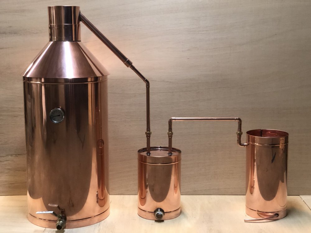

A while back, we settled on this set up for our water purification.  It has worked well for us many years now. It's quick, easy to set up and make friends with all the surrounding campers.
  • Haha 5
I think ShallowGal was going on a distillery tour after the rally, but she and Duke may just follow the Outlaw Oliver around until it’s time to head home.😎
We have a distiller at home and I have often thought about one like this for hurricanes, doomsday scenarios and traveling in the Ollie.  This one might work.

Nice. Be sure to take off that first fraction of methanol 😊

Have you considered making hand sanitizer?

Some of the "stuff" that comes out of these things are hand sanitisers. They also take off fingerprints...
