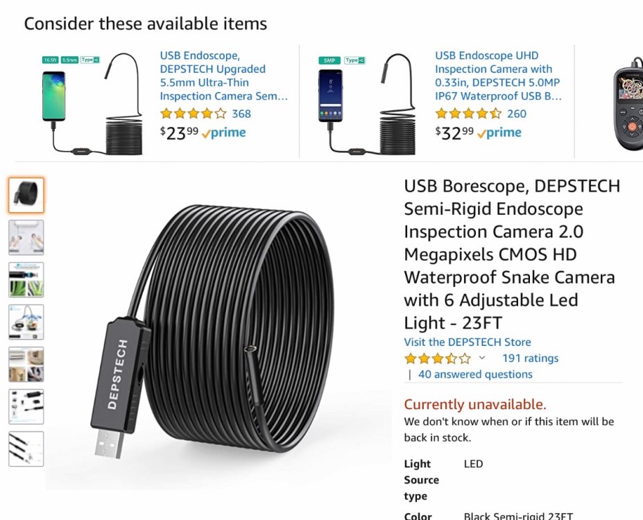

And speaking of scopes, I have used this for my drain pipes at home as well as inspections in the Ollie while searching for wiring pathways.  The only issue is the 23 feet length is sometimes a hassle dealing with.
