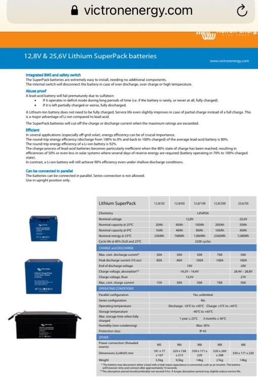

Overland Posted October 5, 2020 Share Posted October 5, 2020 John, if I were buying today, I’d skip the all in one batteries and go with Victron batteries and their separate BMS. They’re still more expensive than Battleborn or LifeBlue, but not as much as when I bought. And the more experience I have with Victron the more I trust them. Not that I’m unhappy with Battleborn - but as a long term purchase, I think the additional reporting, support, and general peace of mind that you get with the Victrons is worth the extra. 1 Link to comment Share on other sites More sharing options...
John E Davies Posted October 5, 2020 Author Share Posted October 5, 2020 (edited) 1 hour ago, Overland said: John, if I were buying today, I’d skip the all in one batteries and go with Victron batteries and their separate BMS. They’re still more expensive than Battleborn or LifeBlue, but not as much as when I bought. And the more experience I have with Victron the more I trust them. Not that I’m unhappy with Battleborn - but as a long term purchase, I think the additional reporting, support, and general peace of mind that you get with the Victrons is worth the extra. Thanks for the advice, but expense is actually a factor, and also system complication. This is NOT what I am after: I want a self contained system with minimal additional changes needed to the Ollie. I already have a Victron SmartBus and like it a LOT, with the exception of the way the trends graph vanishes if the app goes to sleep. (I have not found a setting that will let it run in the background.) Can I fully utilize my SmartBus to keep track of a Battleborne or LiFeBlue “smart” battery bank? Or will that have been a waste of money and effort? I don’t mind using both the battery app and the Victon app if they will cooperate with each other... Thanks for any and all comments. John Davies Spokane WA Edited October 5, 2020 by John E Davies "Mouse": 2017 Legacy Elite II NARV (Not An RV) Two Beds, Hull Number 218, See my HOW TO threads: https://olivertraveltrailers.com/topic/john-e-davies-how-to-threads-and-tech-articles-links/ Tow Vehicle: 2013 Land Cruiser 200, 33" LT tires, airbags, Safari snorkel. Link to comment Share on other sites More sharing options...
NCeagle Posted October 5, 2020 Share Posted October 5, 2020 Interesting. Sort of a coin toss, but I'd go with a single, larger battery as that is a more future-proof approach in my mind. You'd have room to grow / add if you wanted with 1 larger capacity battery. Not so with 2 smaller ones if they fill your tray. Of course, if you can't add a new battery to an older one to create a set this is a moot point. 🙂 1 2020 Elite II, Hull 688 --- 2021 Silverado 2500HD, 6.6L Duramax Diesel Link to comment Share on other sites More sharing options...
Overland Posted October 5, 2020 Share Posted October 5, 2020 (edited) 10 hours ago, John E Davies said: Thanks for the advice, but expense is actually a factor, and also system complication. This is NOT what I am after Well you don’t need all that, just the BMS. It’s Bluetooth and uses the same app as the shunt. It will give you what you're asking for - individual cell voltages, temps, etc. as well as keep track of charges, errors, etc. You get Victron quality and support, and a battery small enough that you can fit 600 Ah worth in your battery box with room to spare, and if something happens to the BMS, you don't have to replace the entire battery. For 200Ah, it would cost about $300 more than the lifeblue total, including the BMS. Each additional battery is only $100 more. Well worth it, IMO. For me, I wouldn’t even be thinking about LifeBlue. Battle born, yes, but lifeblue as far as I can tell is a mom and pop business that rebrands Chinese batteries. I don't mean to disparage them - I say good for them for their initiative, and from what I can tell, I think the batteries are fine. But, what happens if there's a problem? A mom and pop is going to have more pressure to deny warranty claims, less time to deal with customers, less expertise for dealing with technical questions or problems, less capacity and financial ability to deal with major problems like a recall, and an uncertain future if something were to happen to one of the owners. I hope they do well; but for most buyers, these batteries will be the most expensive individual component on their trailer by a factor of two, and for that I’d want expert support and a company that I know is going to be around for a while. Edited October 5, 2020 by Overland 1 1 Link to comment Share on other sites More sharing options...
John E Davies Posted October 5, 2020 Author Share Posted October 5, 2020 Overland, this is like pulling teeth. I was first confused by the Victron “Not Smart” batteries, I found their actual Smart ones with onboard battery management system. Then I was looking at the size, and Amazon posted the package size, not the actual battery size, so I thought they were way too big for the tray. A little math fixed that brain fart. Victron 12.8/100 Lithium Superpack 330x171x220 mm tall 13” x 6.75” x 8.7” tall TRAY 21” x 14.1” x 12.5” tall Is that Amazon one the same as this one? So, if I am not confused still, three will fit long side across the Ollie tray. The LiFeBlue ones are more squarish, but still will fit three to the tray. Did I mess up on any of that? Thanks for your inputs, I and others do appreciate your help. As more early owners of Ollies experience lead acid failures, this will come up again and again. It would be nice if there was a What Fits chart. John Davies Spokane WA "Mouse": 2017 Legacy Elite II NARV (Not An RV) Two Beds, Hull Number 218, See my HOW TO threads: https://olivertraveltrailers.com/topic/john-e-davies-how-to-threads-and-tech-articles-links/ Tow Vehicle: 2013 Land Cruiser 200, 33" LT tires, airbags, Safari snorkel. Link to comment Share on other sites More sharing options...

Overland Posted October 5, 2020 Share Posted October 5, 2020 (edited) OK, here's the dimensions for the Victron Smart batteries. I knew I hadn't gone crazy. The chart above is for their older "SuperPack" batteries, which are larger. 200Ah = 12.6" x 6.0" x 9.3" tall, $2,101.20 from Inverter Supply 100Ah = 12.6" x 6.0" x 7.75" tall, $1,127.95 from Inverter Supply Weird, yes, but the only difference is apparently an inch and a half in height. So three of the 200Ah batteries should fit in the tray. BTW, Victron says do not install them on end, which shouldn't be an issue unless you want more than 600Ah. Edited October 5, 2020 by Overland 2 Link to comment Share on other sites More sharing options...
John E Davies Posted October 5, 2020 Author Share Posted October 5, 2020 (edited) Thanks Overland, I appreciate it. I will still go with two 100 ah batteries, but it is good to know that I could add a third, or even triple the total if I felt like spending crazy money ... but I don’t plan on adding solar panel acreage up top, or to even use a portable one. A sun tracking mount for my 360 watt panels , however, might be a go, if they turn out to be indispensable and super cool. This may have been answered already, does anyone have the Progressive Dynamics part number and cost for the lithium charger unit? Is that something that has to come direct from them? EDIT. mountainoliver messaged me, this is the unit, at a great price. eTrailer has it for $248 free shipping. John Davies Spokane WA Edited October 5, 2020 by John E Davies "Mouse": 2017 Legacy Elite II NARV (Not An RV) Two Beds, Hull Number 218, See my HOW TO threads: https://olivertraveltrailers.com/topic/john-e-davies-how-to-threads-and-tech-articles-links/ Tow Vehicle: 2013 Land Cruiser 200, 33" LT tires, airbags, Safari snorkel. Link to comment Share on other sites More sharing options...

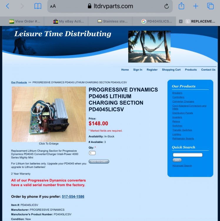

AndrewK Posted October 5, 2020 Share Posted October 5, 2020 John, Progressive Dynamics 60 Amp PD4060LI, from Battle Born for $272. Andrew Andrew, Carianne and Buffy | San Diego, CA 2019 Legacy Elite II Hull #468 "California Burrito" | 2018 BMW x5 35d Link to comment Share on other sites More sharing options...
John E Davies Posted October 5, 2020 Author Share Posted October 5, 2020 43 minutes ago, AndrewK said: Progressive Dynamics 60 Amp PD4060LI, from Battle Born for $272. Thanks, is there any reason to go with the 60 amp over the much cheaper 45 amp version, for a small battery bank? John Davies Spokane WA "Mouse": 2017 Legacy Elite II NARV (Not An RV) Two Beds, Hull Number 218, See my HOW TO threads: https://olivertraveltrailers.com/topic/john-e-davies-how-to-threads-and-tech-articles-links/ Tow Vehicle: 2013 Land Cruiser 200, 33" LT tires, airbags, Safari snorkel. Link to comment Share on other sites More sharing options...
AndrewK Posted October 5, 2020 Share Posted October 5, 2020 16 minutes ago, John E Davies said: Thanks, is there any reason to go with the 60 amp over the much cheaper 45 amp version, for a small battery bank? John Davies Spokane WA John, On the few occasions I need to use a generator, to charge the batteries, I want to do it as quickly as possible. I hate the sound of a generator. Andrew 1 Andrew, Carianne and Buffy | San Diego, CA 2019 Legacy Elite II Hull #468 "California Burrito" | 2018 BMW x5 35d Link to comment Share on other sites More sharing options...
