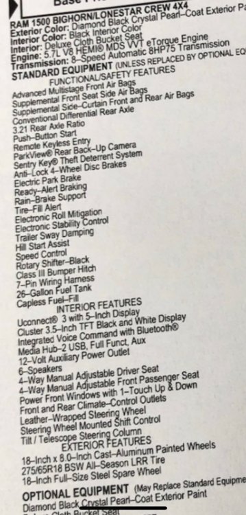

Looking at 2020 Ram 1500 Bighorns 4WD, 8cyl etc.
Sales guy sent window sticker.
Can you guys tell me if this is a TOW PACKAGE, which is what I want, right?
Or is is something less?
If something less, what does it lack that I would have to buy myself before I drive this (assuming I buy it!) to Hohenwald in Jan?
Thanks. As always.

Everything is fine (3.92 axle ratio is great), except the gas tank is only 23 gallons, no good at all....  why did they put such a small tank in it? Don’t buy this one.
I agree . . . . . our 2013 F-350 has a 35 gal tank.  This translates to a range of 450 -650 miles, depending on driving factors (weather conditions, hills, towing, etc).

Here is a 2020 Laramie in Boise, heavily discounted ($47k) and it has a more appropriate spec sheet, with a 33 gallon tank.
https://www.dennisdillonchryslerjeepdodge.com/inventory/new-2020-ram-1500-laramie-4x4-crew-cab-1c6srfjt0ln367053
 Maybe the eTorque engine option reduces fuel capacity since it in theory gives better mileage, but not necessarily while towing. Dennis Dillon does about 90% of its sales remotely, folks fly in, the sales guy picks them up, they buy the truck and drive it home. They have very hard to match pricing.

Tow hitch is just that, a hitch and probably a 7 and or 4 pin connector. Tow package varies by manufacturer and they may have levels of tow packages. It usually means a bigger alternator, upgraded transmission, larger radiator,bigger gas tank 🙂 etc. .  Sales people do not always know.  So you have to dig into the details on the sticker and on the manufacturer's website to see what is included the package.

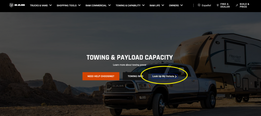

Also for RAM's when you find one outfitted the way you want, don't forget to check the PAYLOAD sticker on the Door Frame before you sign off.
If you can't see the vehicle on the lot, RAM has a way to lookup the payload based on the VIN.
https://www.ramtrucks.com/towing-guide.html
669116436_ScreenShot2020-10-23at3_22_14PM.thumb.png.43e9c9be96cff450bdceaaecea32dc19.png

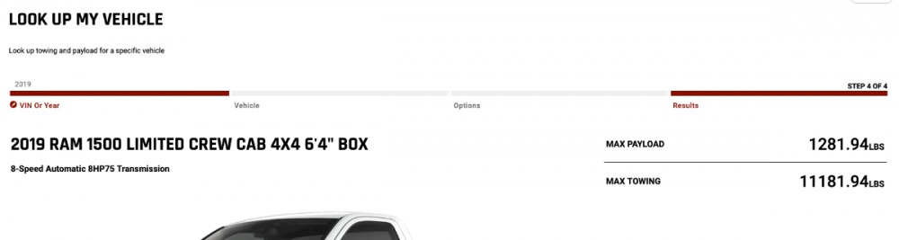

Once you put in the vin you'll see out the door of the "factory" payload. *See the image below*
While the picture isn't ever correct (see the disclaimer below the picture of the truck) , it should be the correct payload and tow rating.
One thing for sure....don't under buy on Payload...the more glitz in the truck, the lower the final payload.

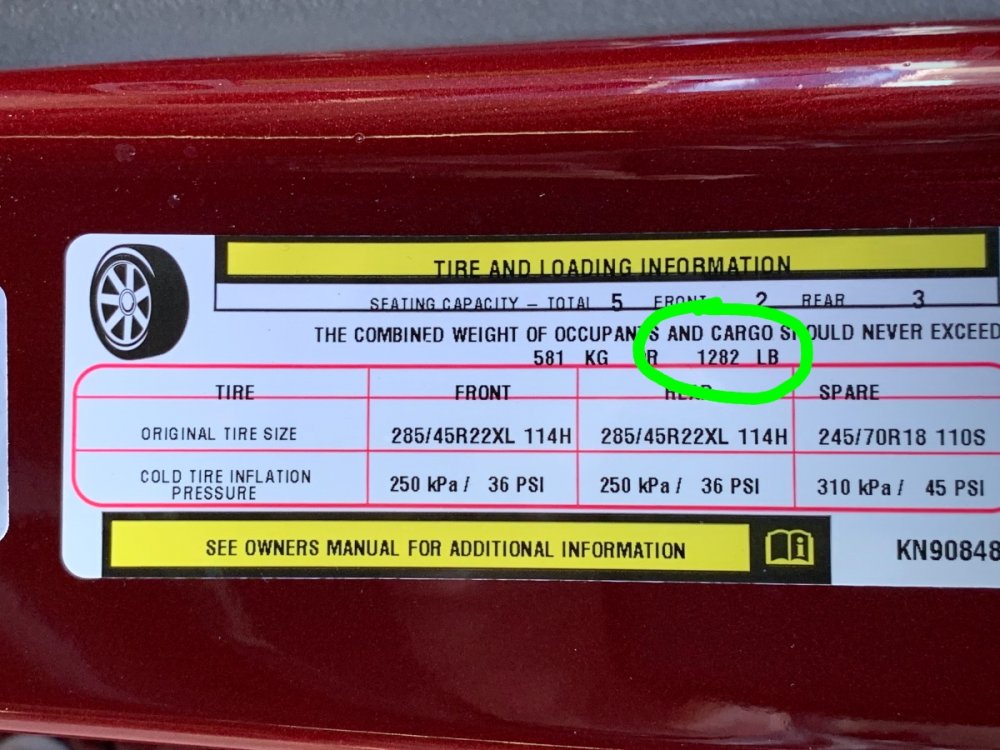

Then as a final check, ask for or go take a PIX of the door jamb Payload Sticker before you sign.
I found that on some RAM's their ONLINE payload stickers didn't match the final sticker upon delivery.
This one matches with a bit of round up to 1282 lbs payload.  (This was a fully loaded truck) one with a much lower trim level had a 1700 lb payload.

The Ram 1500 can have a 23, 26 or 33 gallon gas tank.  My 2016 had the 33 gallon.  My current 2020 has a 26 gallon.  They factor in a full gas tank when they figure payload capacity so the 33 gallon will yield a lower payload number.   I was a bit concerned going from 33 to 26 gallons but honestly it hasn’t made much difference.  We stop every 2-4 hours anyway so filling up isn’t the issue I thought it would be.  I think most Ram 1500s come with the 2” hitch receiver and 7 pin connector.  The towing package comes with some extra cooling, a larger alternator and brake controller.  It’s important to make sure the towing features you want are listed on the window sticker.  Mike
  1. Try to get your hands on the buyer's guide, for 2021 it's here: https://www.fcausfleet.com/content/dam/fca-fleet/na/fleet/en_us/shopping-tools/brochures-literature/docs/buyers-guide/2021/2021_Ram_1500_DT_Buyers-guide.pdf
    1. Here are the options listed:
    2. Trailer Tow — Four- /seven-pin connector (XFK) • • • • • • •
      1. — Class III hitch (bumper; not available with Class IV hitch receiver) (XFJ) • • •
      2. — Class IV hitch receiver (included with H1 and H2 Equipment Packages, Tradesman Group, Trailer-Tow Group and Max Tow Package) (XFH)
    3. Trailer-Tow Group — Includes Class IV hitch receiver, integrated Trailer Brake Controller, 7 x 11-inch trailer-tow mirrors, Trailer Light Check, Trailer Tire Pressure Monitoring system, Uconnect® 4 with 8.4-inch display on Tradesman only and Trailer Reverse Steering Control (AHC)
    4. Max Tow Package — Includes max towing 10-inch axle with 3.92 axle ratio, Trailer-Tow Group, 18 x 8-inch aluminum wheels and LT18-inch OWL On- /Off-Road tires (available with 5.7L HEMI V8 with eTorque or 3.0L EcoDiesel V6 4x2 Quad Cab® only) (AJL/AJQ)
My Guess is you want at least Trailer-Tow Group, and probably the Max Tow Group in addition.

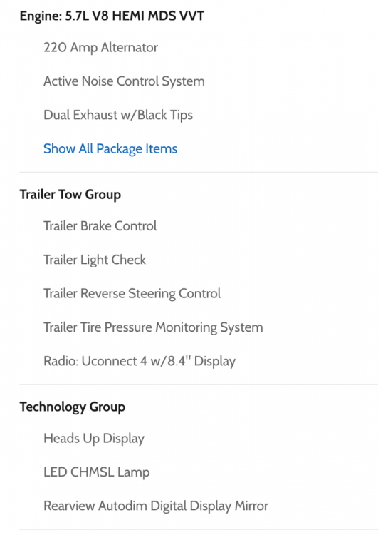

OK ya'll, now I have a new sticker to show you. Well ok I won't post the whole thing but it's the 2021 Ram 1500 Rebel crew cab 4x4.
The tank is 33 gallons. Here is the stuff on the Tow Package and the GVWR. Surely this beast would easily tow an Elite I, with "stuff" in the TV (mainly my dog, who is a good 75-80 lbs, hahaha) and stuff in the Elite I.

For me a tow package includes a brake controller. Suspension to support what we plan to tow. An electrical plug to be at least 7 pin if not both 7 and 4.

This Rebel is more than enough to tow an Elite I.  It’s essentially what I am driving now.  I see it has the brake controller which is a plus, that will also give you the trailer brake status on your instrument panel if you choose.  The 5.7L Hemi in the Rebel is plenty for the small Ollie.
Rebels are not any more powerful than any other Ram 1500 with the 5.7.  The Rebel just gets you some cosmetic trim upgrades and some suspension upgrades.  I wish Ram would up the Rebel HP a little like Ford does with the Raptor.  Maybe slap on a supercharger?  The Rebel TRX does that with the bigger V8.  Mike
