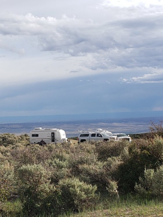

We have never felt uncomfortable boondocking.  We have several different modes of camping without hookups.  The most infrequent is stopping overnight on our way somewhere.  We’ve stayed at Cracker Barrel’s and interstate rest stops (some welcome overnight RV parking).  Then there are remote campgrounds run by the FS, COE, BLM that have no hookups, (most in the western states) and campgrounds in National Parks and some state parks.  Finally, there are dispersed camping sites where there are no designated sites, just an area where you pick out a spot and camp.  We don’t boondock in areas that aren’t okay for RVs to park overnight.
I will start a new thread on boondocking sites where folks can post pictures of spots where they’ve been.  Mike

Cracker Barrels usually have 4 or more RV parking places behind the restaurant.  Never had a problem there.  Yes, we do research interstate rest stops.  There is one on I-40 east of Amarillo that has 24 hours security and welcomes RVs.  Same at the Atchefalaya rest stop on I-10 in Louisiana, RV slots and 24 hour security.  There are others that are big enough to park overnight, most are not.
I did start another thread on boondocking locations so we don't hijack this one too much.  I'm sure there will lots of photos posted.  Mike
