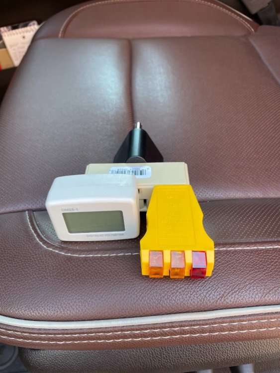

I put together this tester at the suggestion of another Oliver owner and keep it handy in my truck door pocket. The voltage display was ordered from Amazon and is advertised as a night light as well. This combination tests the pedestal for not only the typical wiring problems but also for over/under voltage issues. It does not however check for incorrect cycles (above or below 60). I do this very quick test before plugging in. After that the installed surge protector shows and filters out typical voltage, wiring and incorrect cycles issues.
I use pretty much the same setup, except I used a pivoting three way adapter.
https://www.amazon.com/Cable-Matters-2-Pack-3-Outlet-Grounded/dp/B01LY5WXBY/ref=sr_1_9?dchild=1&keywords=120+volt+three+way+adapter+pivoting&qid=1606285838&sr=8-9
It is very handy. When “Mouse” is plugged in during storage, I insert the tool, with just the voltmeter, into the outside 120 volt outlet, near the hot water heater, facing the front of the trailer. The glowing display shows at a glance that it is getting power. I experienced a failure of the shore power adapter and the converter was not charging the batteries. This way I know the power is at least getting to the main AC circuit.
Highly recommended!
