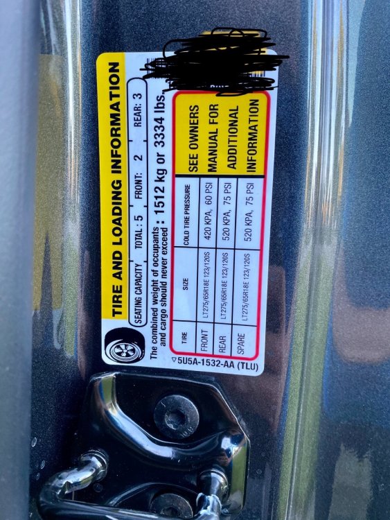

Frank C Posted January 7, 2021 Posted January 7, 2021 (edited) Ford F-250, 6.2l gas engine. I figure around 600 lbs. tongue weight on the trailer based on what most owners have measured. 3,334 lbs. payload capacity on the truck so no problem hauling all the stuff we take with us when camping. Only “dream” vehicle change would maybe be the same truck but with a diesel engine. Edited January 7, 2021 by FrankC

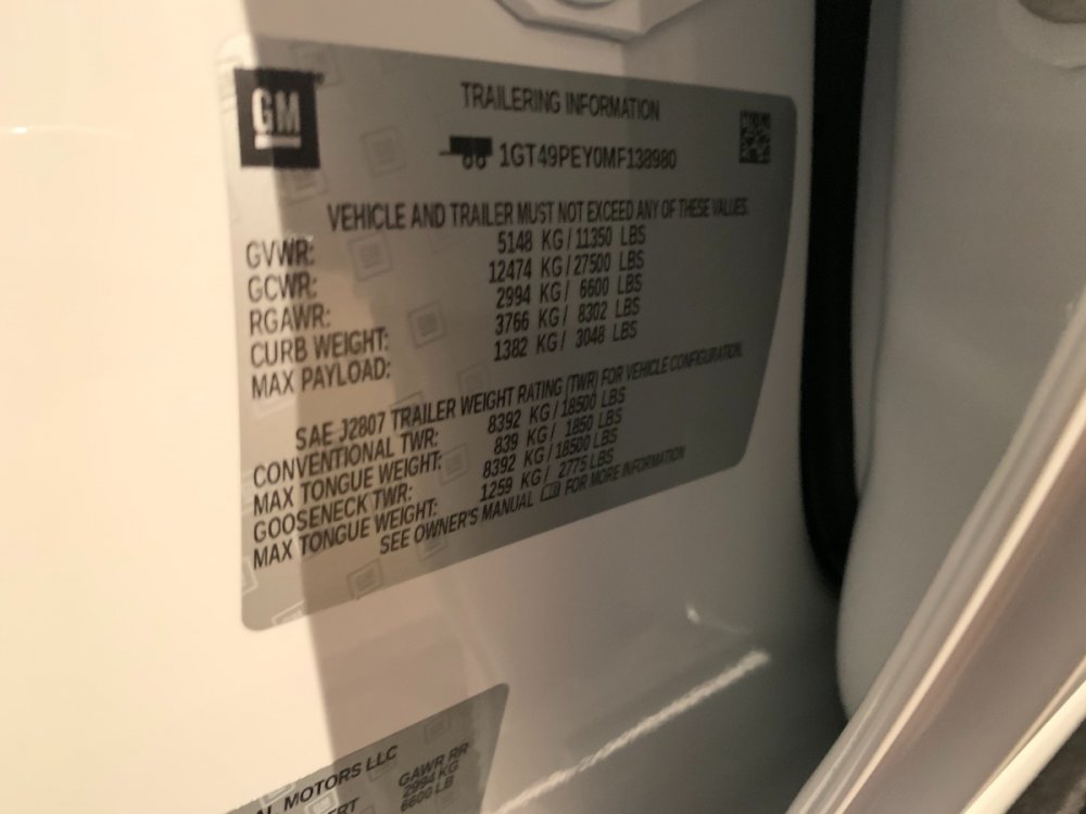

Jps190 Posted January 7, 2021 Posted January 7, 2021 Going to be towing with a GMC 2500 AT4. Sticker attached. John and Kim 2021 GMC Sierra 2500 AT4 6.6L Duramax 11350 GVWR 3048lb Payload 2021 Oliver Elite II. Hull #887. 600 Watt Solar Mod
