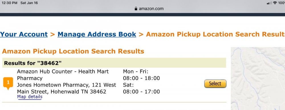

Before amazon lockers, I  used ups stores as a pickup location. Figured out where I'd be and when, called the store, made sure they offered the service, and had my package shipped there. That involved a small fee paid to the ups store at pickup, but the last time I  used this method, the vendor wasn't on Amazon.
If you're at a campground or rv park with an office,  the office may accept a package for you. Check ahead to make sure, though. Not everyone wants that responsibility.

I will be at the David Crockett SP near Hohenwald for like, a week, practicing towing and hitching and stuff anyway. So much to learn. If anyone on here lives near there and wants to come by the SP that week and have a cuppa Joe, let me know. I would likely have a few qs for you and you could see what a goofbag I am, you know, in person. Lol
